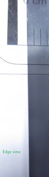

I want to know - just a quantity for this particular setup - when this knife would no longer able to slice newsprint. Stop when 25% of the edge will just tear newsprint. I decided to post this result FWIW (laugh & wink expected :p).
Cardboard shred stats - mostly cross ridge/wall cuts
Knife: Aldo 52100, 4" blade, 9" OAL, super quenched, 64rc, quilted zebrawood handle. Thickness: 0.032" @1/4" from edge; 0.042"@ 1/4" from tip; 0.125" @above heel.
Cut time: 5 to 6 hrs spanned over 2 weeks. No touch up nor sharpen, just occasional a few swipe/strop on cardboard to clean up glue on edge.
Total weight (of cut strips): 105 ounces
Avg strip width: 1/10"
Linear cut length calculation on a piece of 5/52 x 10 x 12" (1.6 ounce) = ~ 100 ft cut per 1.6 ounce.
~ Total linear cut length = (104/1.6) * 100ft = 6500 ft (1.23 mile, 1.98km)
