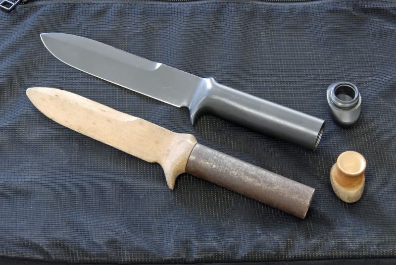

Is a hollowed out, "3D" full tang superior to that of a traditional flat full tang for high abuse activities (e.g. heavy batoning)? That is, the full tang moves across the Z-axis along the curvature of the handle's ergonomics. Thus, instead of having a thickness equal to the knife blank it's much thicker.
I'd imagine a knife of this construction would have an encapsulated tang.
Also, the reason for its hollowing would be to reduce the weight while maintaining the same strength - I'm making a guess here that it would be similar to the function of a fuller or an I-beam in that you reduce the weight while maintaining practically the same amount of support strength (?).
It may be similar in concept to one of those survival knives with a hollowed out handle for storage, but it would be a higher quality custom version with an encapsulated tang instead of a metal tang handle.
And, are there examples of this? Thanks in advance!

The top knife is similar to what I mean in terms of the concept, as more force is spread out throughout the handle.
However, I'm referring to a tang that would be encapsulated and curves with the handle's ergonomics (not just a cylinder).
The ricasso would definitely be the weakest part as the force gets funneled down there from the blade's edge region, and spread out down to the sides. So, if the ricasso would likely fail first, then the point of strengthening the tang may be moot. Conversely, what if the ricasso is made to be conical or cylinder (etc.) in shape, thereby introducing more surface area for the force to spread out over, which would offset the ricasso being the weakest part?
Though, one other benefit I could see from such a "3D" tang, namely one that curves with the handle ergonomics and not simply a cylinder like what's below, be more balanced in the hand instead of tilting from one side or the other.

No. No. No. And No.
Bottom line is that at some point your tang has to become the the same height and thickness as the blade. And at that point, your 3D tang doohickey is the same as a conventional full tang. So it has no advantages over it. There is no more material where the blade meets handle.
It could be as thick as the barrel of a baseball bat, but it has to come down to the size and thickness of the blade eventually.
You need to draw yourself a picture. You are hypothesizing yourself away from reality. Picture should straighten you out. :thumbup:
Even if this "cylinder tang" was solid, you would have no more material along the red line than you would in a full "flat" tang knife using the same blade.
Same amount of material = same amount of strength at that point.
