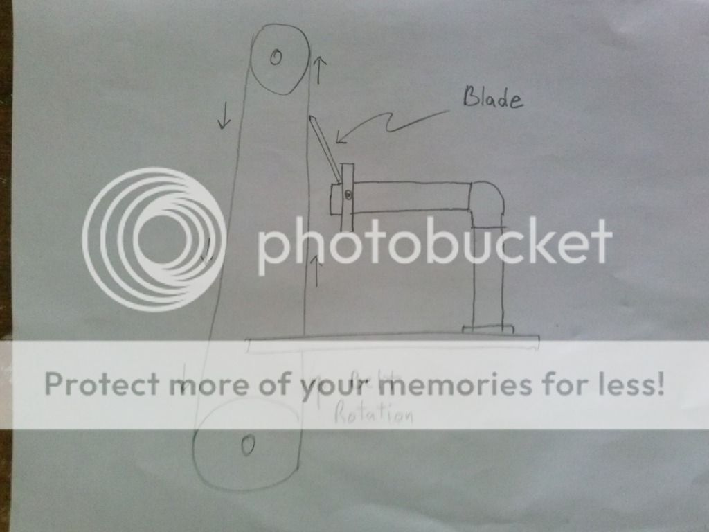

I wanted to show you guys this idea for a sharpening jig that I have in mind.
It can be used with the spine below as pictured or on top with the spine resting on the shaft and motor in reverse. There are two possibilities to adjust the angle. The first would be to loosen the lock nut on the collar and slide it in or out. The second would be to keep the collar in a fixed position and use the optional crank wheel to move the entire table in or out. I would use the angled wedges to set the angle for a specific blade as every knife would be different due to the width.
Here is a side view with the blade on top and belt running floor to ceiling. I think I'm going to like it this way.
This is a first pass and I'm still working out the details. I did a few dry runs with mockups and it feels very natural. Let me know what you think.
I like it!!! I wonder how it would work with distal tapered knives? Would you just rotate the handle out in that case and thereby pushing the tip into the belt?
On my dry runs I found that a square shaft and collar 1" wide will work better for the tips. As I'm pulling towards the tip, the spine locks in between the corner of the shaft and belt and only lets you slightly rotate in one fixed direction. I think its going to be fool proof.
can't wait to see the final product! keep us posted
