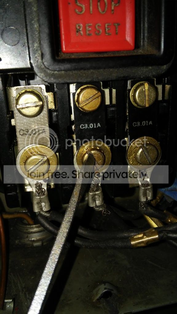

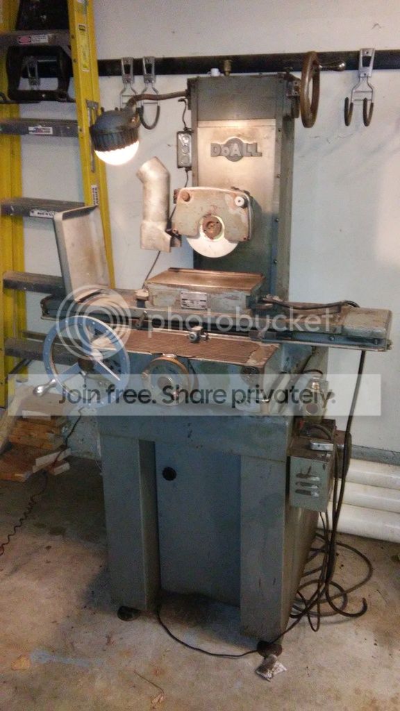

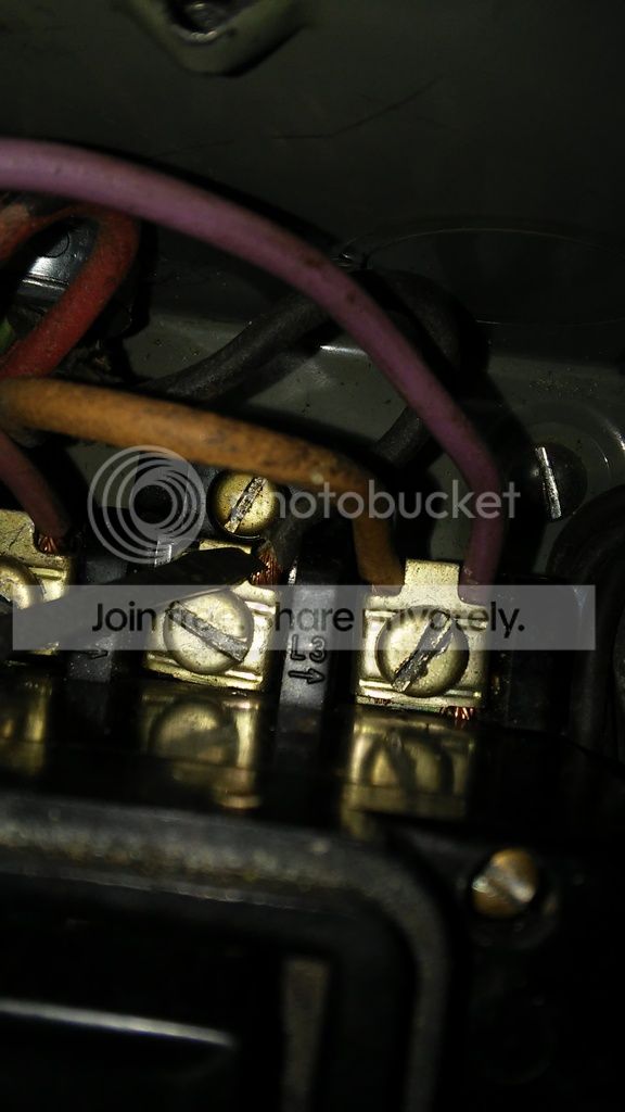

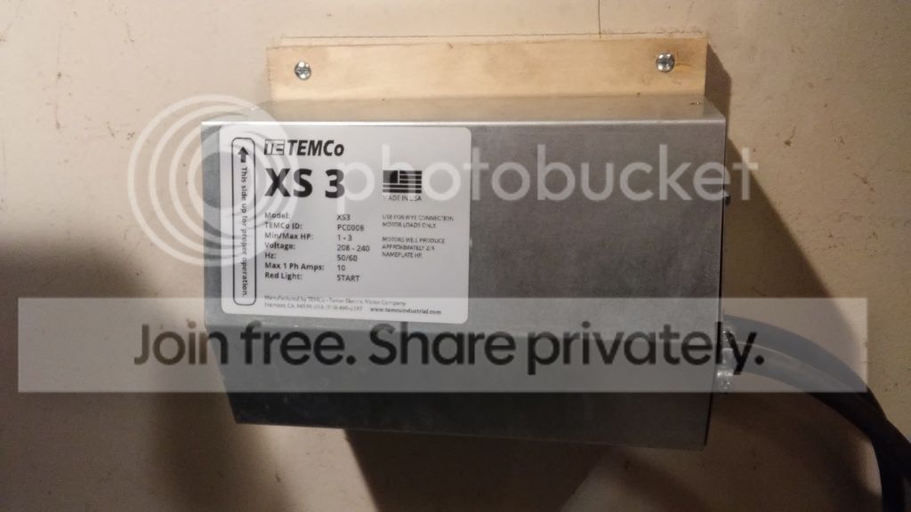

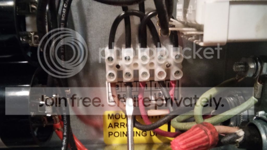

I was recently at the receiving end of a very generous offer of an old 6x12 DoAll surface grinder; it's in very good condition as far as the mechanisms and surfaces go, but I'm having some serious problems with the the switch operating the spindle motor. I knew I would need a phase converter- the motor runs 220 volt 3 phase- but for some reason, that's just not doing the trick. When I turn it on, the thermal overload relay on the left side starts smoking and the switch shuts itself off. Before I knew what was smoking, I took the entire switch apart and determined that the thermal overload relay was at fault; it was completely brown. The other two were normal. Having ordered a new relay and installed it, I tried it out again and more smoke, more heat, and the switch turned itself off again. I have been talking to a good friend of mine who is more adept in the world of electronics and we thought we found the problem. The generated phase coming out of the converter (the one not connected to the incoming lines from the wall) wasn't hooked up the the central cell of the switch, the only one that doesn't have the mechanism to trip the switch if the relay gets hot. I switched the wires around, turn it on, and it shut off again. Does anybody have any idea what's going on here?
I can verify that there is 220 volt, 20 amp, single phase coming into the converter and the three contact points in this switch are clean. The motor is runs 220-440 volts and is 1 HP
Here are some pictures;
The switch in question
The wire I'm pointing at is the generated phase
I matched the black wire with the generated phase to the middle cell, the one without the thermal relay.
The white rectangle is the relay that was burning. The one I'm pointing at is the output for the generated phase.
I apologize if my terminology is wrong or my description isn't clear. Electronics isn't really my forte.

Is your motor a "Y" (WYE) connection motor? Your phase converter says that's all it's good for. I'm not at all familiar with phase converters, mostly you'll find VFD drives used for conversion to 3 phase.
I didn't see any wiring hookup info on your phase converter. Sorry, I can't provide much help,

A pic of the motor data play would help. That heater element is rated at 2.15 amps. Remove motor leads and check voltage from ground to each leg. The generated leg could have a weird reading, it's more important that you have proper voltage from leg to leg. A and B should be 208-240, as should B to C and A to C. Improper voltage on the generator leg could lead to higher amp draw causing the thermal to burn out. Could very well be the windings in the motor as well. Definitely check that the motor is wired to the proper output voltage of the controls.
If that all checks out, an ampere check would be best if you have an amp meter. Also checking voltage under a load. That may be hard though if it constantly trips.
