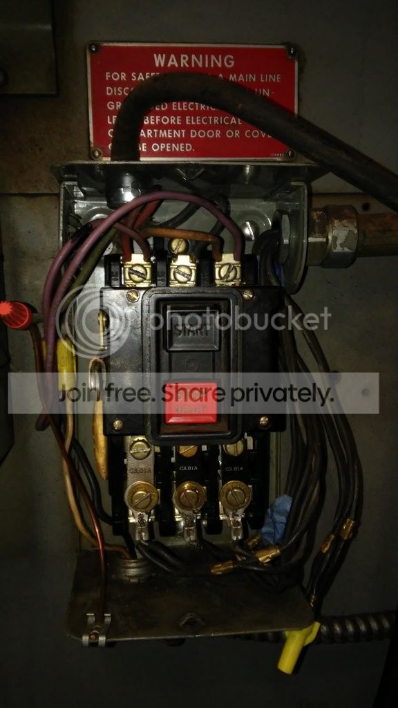

Alright, I found some very interesting values.
Output-
A-B:440 volts
B-C:250 volts
A-C:250 volts
A-Ground:120 volts
B-ground:120 volts
C-ground:120 volts
Input-
A-B:440 volts
B-C:250 volts
A-C:250 volts
A-Ground:120 volts
B-Ground:120 volts
C-Ground:120 volts
I also noticed the thermal overload relay that has been giving me trouble and burning up was cold-absolutely fine (and I had it turned on for much longer than it takes to blow it with the motor plugged in)

Are these voltages with the motor running? Or just with the SPC turned on and the motor disconnected?
I disconnected the motor for these readings. Sorry, I should have mentioned that. I suspect that's why the relay didn't heat up.
I'm not understanding where the 440 is coming from. You're supplying only 220VAC to the SPC correct? What kind of meter are you taking readings with? Is there a transformer somewhere in the mix that's stepping up the voltage? I must admit, I'm a little better versed on VFDs and actual 3 phase equipment, and haven't worked much with static converters. That said, I don't think you should be seeing 440 anywhere.

You are correct, I have 220V AC coming into the static phase converter. I'm using a "Split Jaw Smart Meter". I used the leads coming off of it to measure the voltage, not the Jaw at the front. I know the transformer takes in the 220V and steps it down to 110 for the outlet right next to it, but couldn't say for sure if that would have anything to do with the problem. I think I'm going to have to check out the motor tomorrow. As for moving the grinder, I have tried moving it with a 4 or 5 foot long 2x4, but I didn't get anywhere. Even if I did manage to get it away from the wall, I would have to get it back against the wall because my shop is a 2-car garage and I need all the space I can get :eek:
ETA: The purple wires got to the transformer. They are connected wires-black and white- with wire nuts to the left.
Just for grins and giggles, I might try disconnecting the purple leads and see what happens to your voltage readings and THEN see if the motor runs, although I'd still wager it's wired for 440, it may not be.

Did you take these readings at the converter connections or the contactor switch?
I guess I wasn't clear enough
Everything should be disconnected from the converter in order to isolate any issue that might be down line.
Need to start at the top.
At the phase converter:
L1 L2- should be connected and powered up
T1 T2 T3 -nothing connected
Check Ts to ground then phase to phase
Also check also to ground and phase to phase.

If it is ok at the converter, you can try completely disconnecting that 110v transformer then check your voltage
Alright, I'll update this when I check the converter tonight. Thank you guys so much for your help!
It sounds to me as if it is your converter. With the motor, start switch, transformer etc. disconnected, the voltage readings from leg to leg and from leg to ground are wildly wrong.
You want to make sure you're checking the voltages in the lines coming in from the static phase converter, right at the terminals, with no circuitry of the machine hooked to them.
I have an old phase-o-matic that I got with a milling machine, never have used it as there are better options now that are quite affordable. Ideally I believe you'll want smoother power than that thing can produce, for finishes on that grinder. It's too bad you don't have a VFD there to test it with...
Several people have told you to check the wiring IN the motor. If the motor is wired for high voltage you will not be able to run it with your setup.
Verify and rewire the MOTOR if necessary. Do not worry about your Phase Converter until you check the motor internal wiring. I might have missed that you have already checked this, if so sorry for
