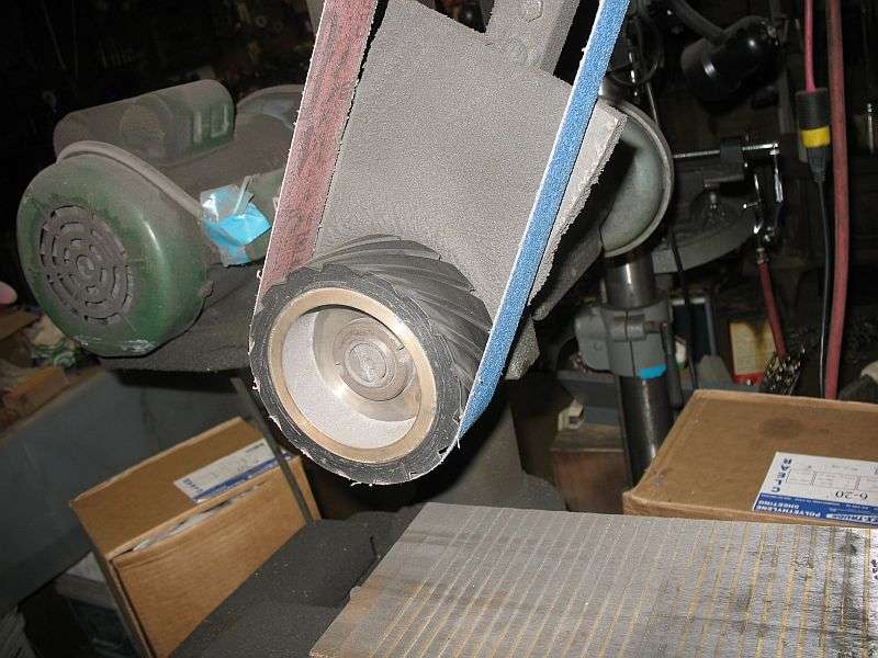

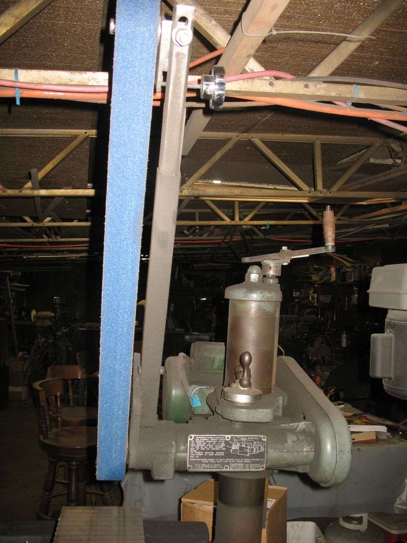

I have the same surface grinder. Here are some pictures of a conversion. But I can change it back to rock wheel in about 5 minutes. I think the best of both worlds. It is so much faster with a contact wheel to take forged Damascus billets or small Damascus for guards etc. and grind them with a belt. I then will take it up to 220 (using finer belts 80, 120 220). If I need precision I just take three screws out after wheel removal and but a rock wheel on and dress it and back at it. I had the contact wheel made at Sunray. Just measured what it needed to be and they were great to work with and very reasonable. I got my wheel in 90 durometer. Works great.
Thanks for the pics Dan. That looks great and surely something I will add to the grinder eventually.
