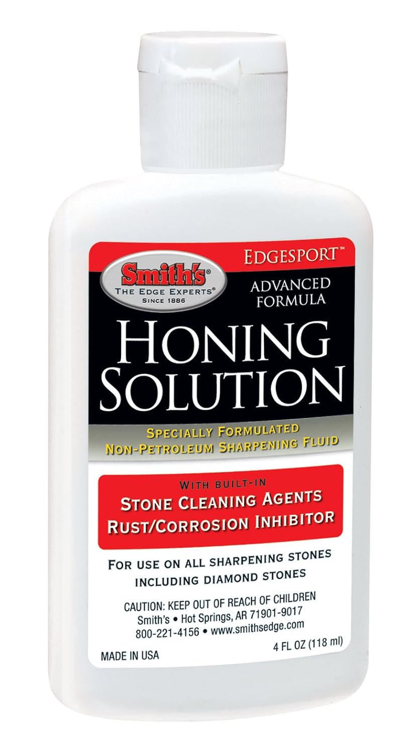

I think I am allergic to honing oil, every time I get a whiff of it, and start to use it my head starts pounding. I have not found anything online about people having allergic reaction to mineral oil though. It is really weird. I just tried to do a youtube video on some but the head ache made me turn the camera off!
What brand of oil are you using?

The oil i'm using is kwik sharp honing oil, and lansky honing oil. Both stink the same amount, and both give me a head ache almost instantly!
I was wondering if I bought Mineral oil instead, or basically non petroleum based oil if it would fix it.
I guess I need to get one of those "SAFE FOR KITCHEN USE" oils.

If they stink that noticeably, something's not right with those. Definitely look for the kitchen/food-safe mineral oil. The Norton-branded stuff I mentioned can be found at Home Depot, usually right alongside the Norton 'Economy' stone they also carry.
How old are the oils you're using? Interesting you mentioned the Kwik-Sharp brand; I have an old ceramic V-crock sharpener under that brand, purchased back in the early '90s. I don't think they're even in business any more.
Lansky labels their current honing oil as 'Nathan's Natural Honing Oil', which is supposed to be safe as well. The stuff I have (included in one of my Lansky kits) is completely odorless. Depending on how old your Lansky oil is, it might be a different formulation.

I apologize, I for some reason get Lanky and Smith's confused! It is Smith's honing oil, it is coming in a white container. It smells almost identical to the huge bottle of kwik sharp I have.
I figured the smell was simply the petroleum base/kerosene they put in the oil.
Perhaps I will try the lansky "Nathan's" stuff. I think kwik sharp was bought by smiths or lansky during the 90s.

That^ might make some sense to me, about it being a Smith's product. The 'Honing Solution' they're currently marketing (pic below) indicates on the label that there are 'stone cleaning agents' and 'rust/corrosion inhibitor' in the mix. No idea what that implies, other than they've added some stuff other than pure mineral oil. That might also explain why they call it 'Honing Solution' instead of just 'honing oil'.
