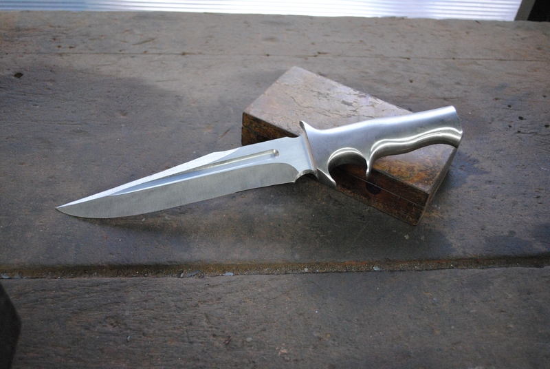

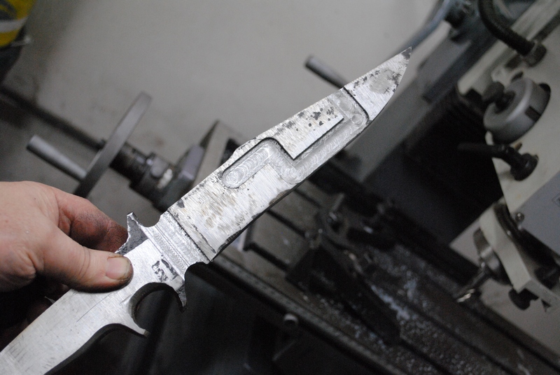

Survival Sub Hilt integral. WIP

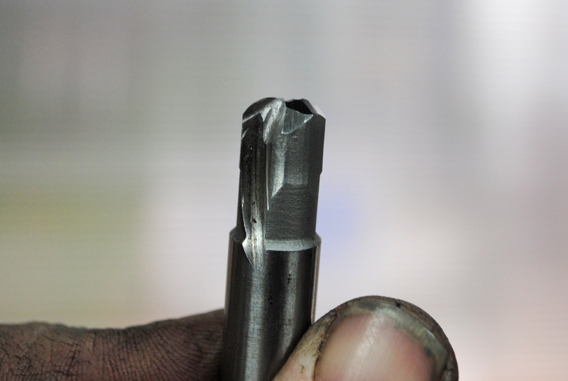

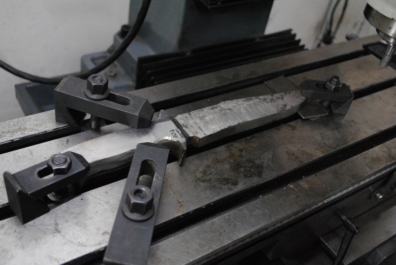

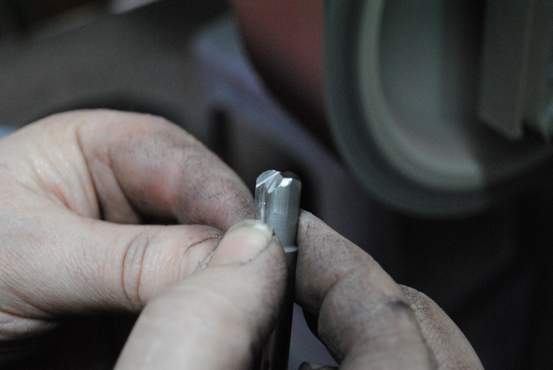

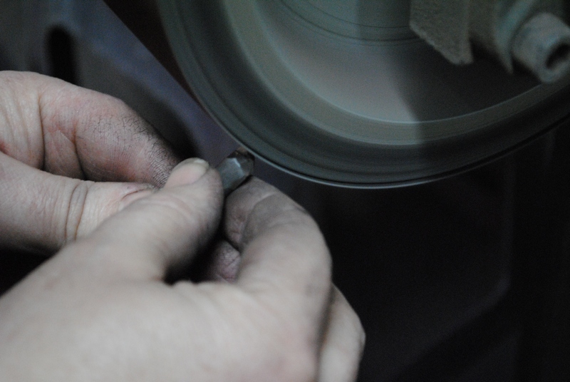

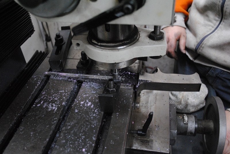

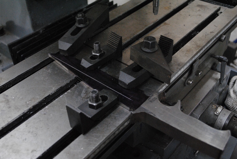

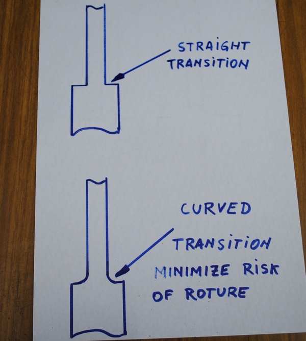

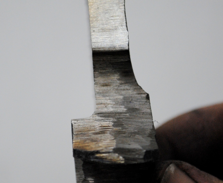

Preparing milling cutter for curve trasicion

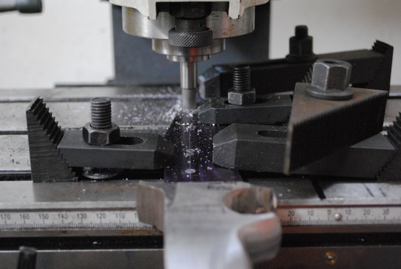

Now I must refocus the knife on the machine milling and make same on the other side.
Best Regards....!!
Claudio
Man, that is some serious material removal and, again, your skills are first-rate!
Thank you for taking time to get these pictures. :)
this is definitely one of the coolest threads here in a long time!
Thank you :)
Claudio, you're like Santa Claus, fulfilling our dreams, the knife´s lovers !
See this step by step, is a real treat (and entertains me until mine own step by step arrives next week ? :)
Congrats !!

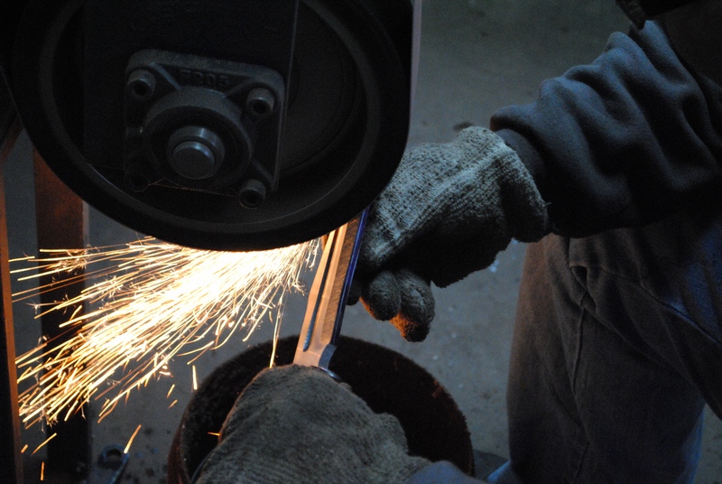

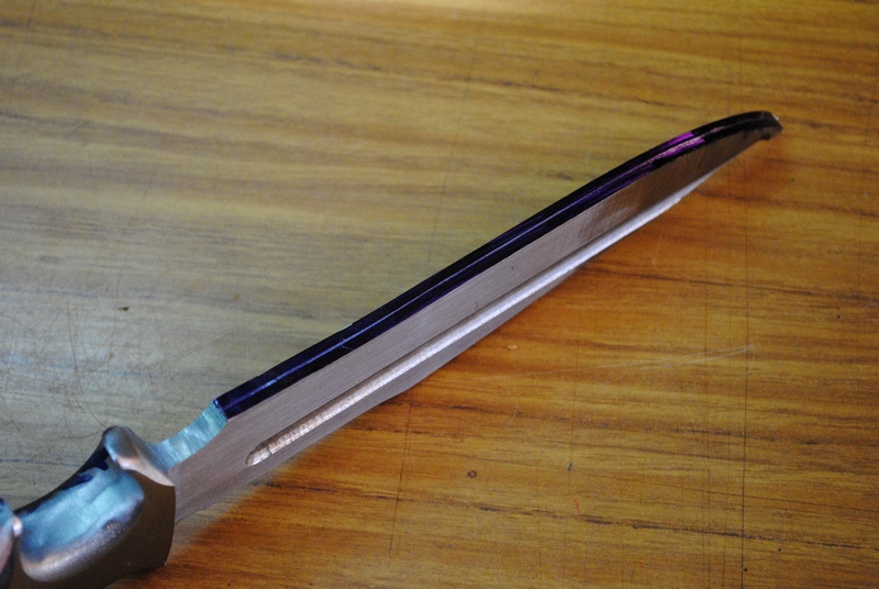

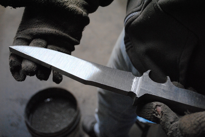

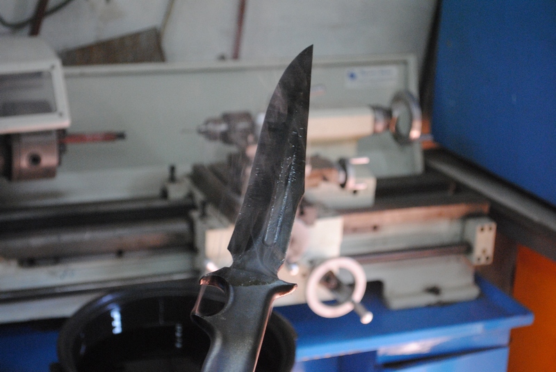

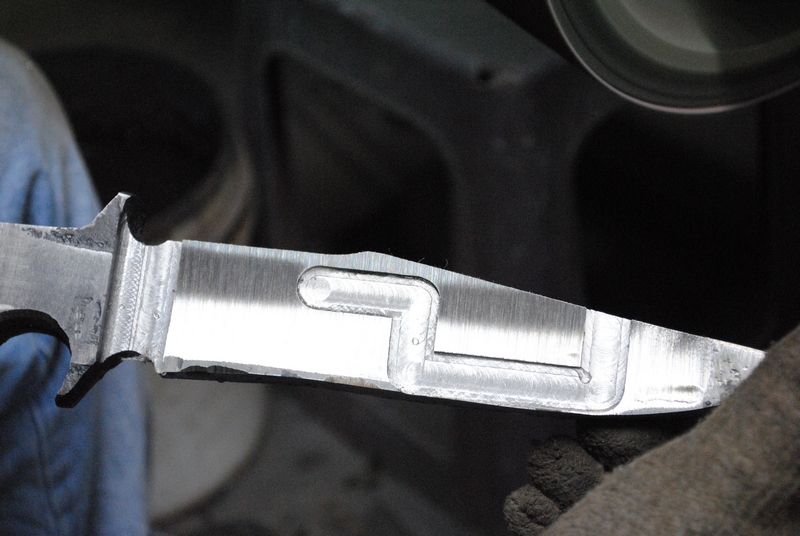

Hi guys,
Thank you very much for the coments. I'm glad you like it.

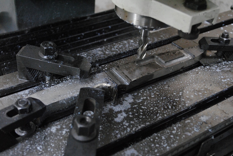

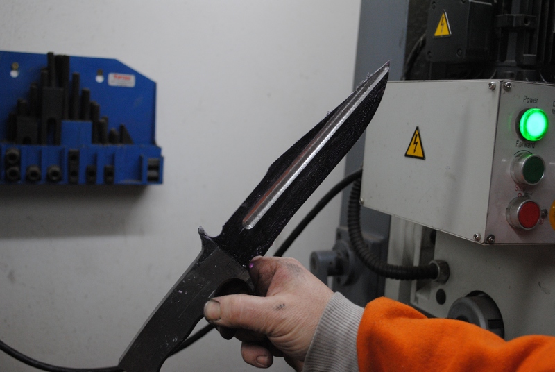

Here is another small update.

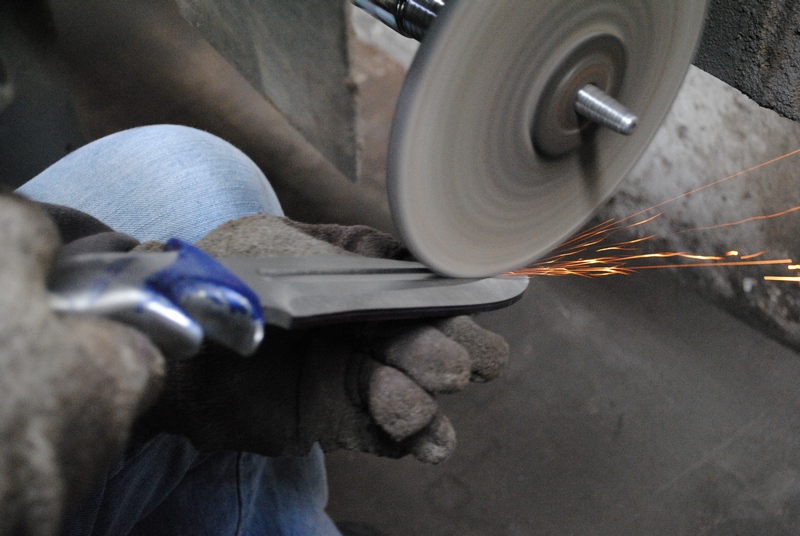

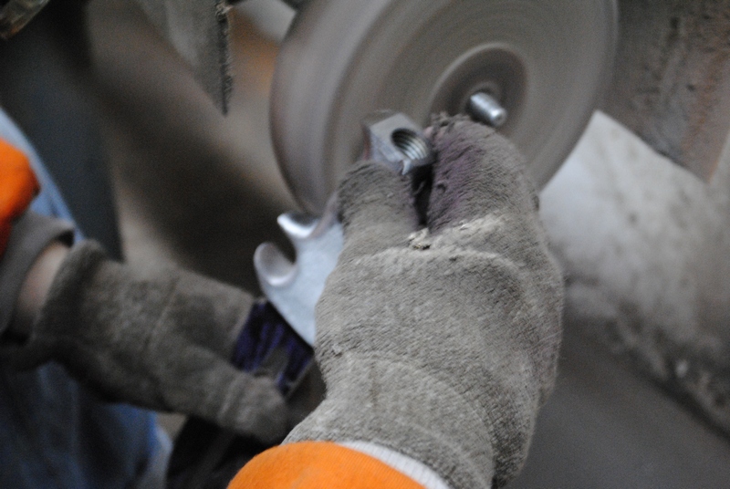

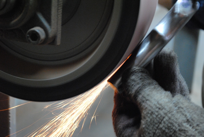

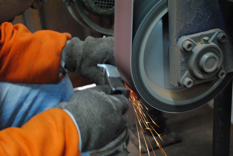

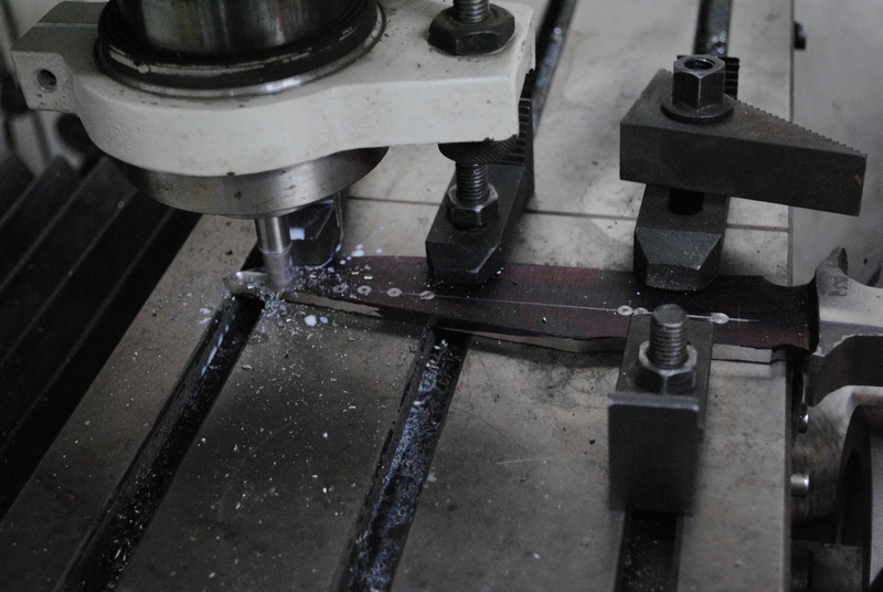

The same procedure on the other side of the blade...
Here, a short video while I'm working ...!!
[video=youtube;jSMdfykboRg]http://www.youtube.com/watch?v=jSMdfykboRg&feature=c4-overview&list=UU5-5NMovTLD-Ko89CWX6YGg[/video]

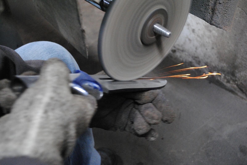

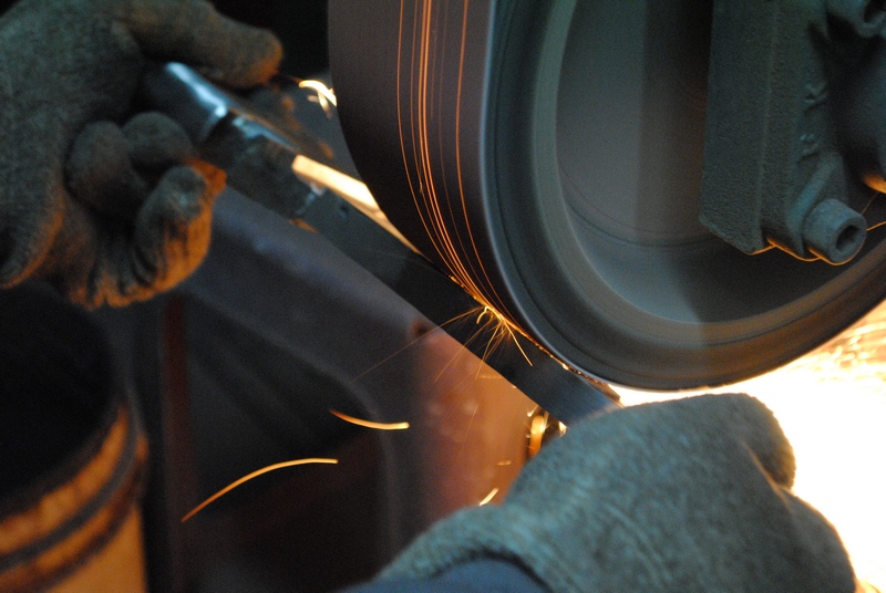

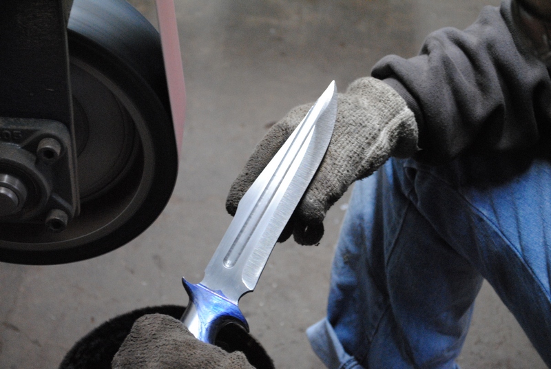

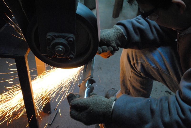

continued in the afternoon, it's time to go to lunch... :p hahah

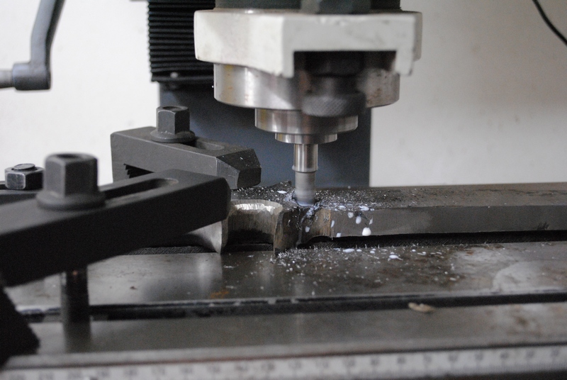

Alex, at first the intention was to make the two pieces together but I did not dare. When done with this, it is yours, I'll start with Fernando.
Here a new update
