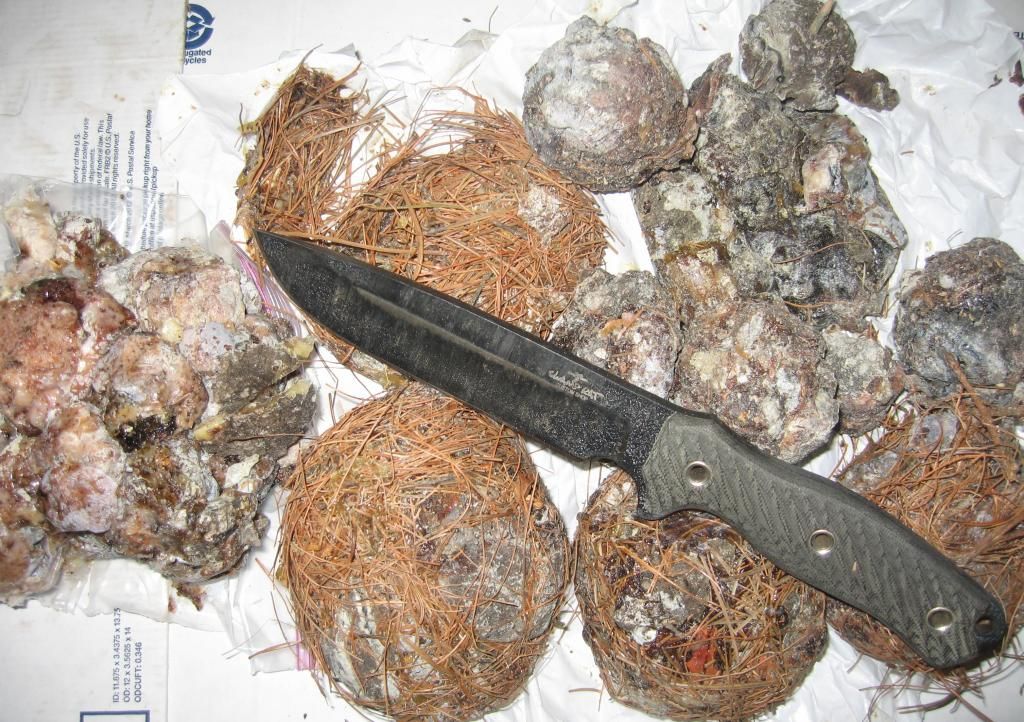

Swamp Rat pics!

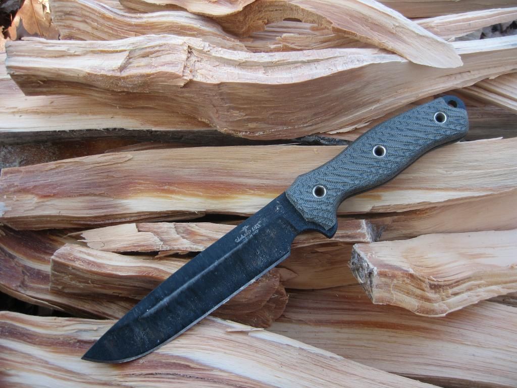

Yes, I taped off where the blade and handle meet and stripped the coating about 1cm from the edge of the scales. I used Kleen Strip Premium in the aerosol can. I left the scales on, and oiled them after I was done. No damage to them or the coating anywhere else on the knife. I highly recommend it as long as you have the patience or tools/confidence to take your time and only remove the steel you need to to achieve the desired finish. It took me less than 30mins from stripper to semi-mirror polish. I used my WSKO like a belt grinder, going through my usual belt progression, free hand without the edge guide. It was my first attempt using it in this manner, and my results were beyond expectations, I can achieve a sharper more consistent edge as well.

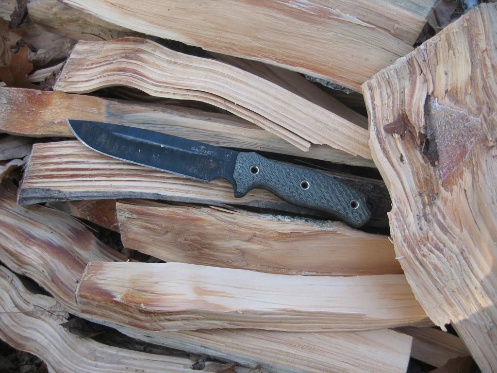

Bonus pics of the uncoated area, carrying it again today too;)

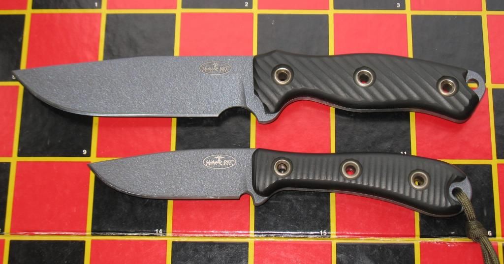

BTW joeymoey, your RS RMD combo looks sweet! Mine will match once I strip the RMD.
