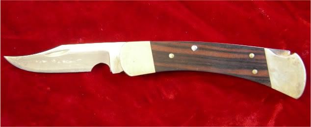

This question is in regards to swapping a S30V blade in to a 3 dot frame. Someone told me (Pete I think) that the newer blades are difficult to fit into older frames. I'm hoping that this swap I want to do is in fact doable. I saw a 420hc in a 5th version frame so...what do you guys think??
:cool:...Hey "Flatsky"...I think the problem you mention might refer to the problem that arises when trying to swap a newer blade into a frame that was made for the "non-bushing'd" blades of way-back...LOL...I put a "newer" 2005 blade in an old 3 dot frame for a friend who busted his blade off with no problem...The 3 dot version is where Buck started out with the bushing...Try it...:D
You may also have to swap in the new style backspring...IIRC, the notch in the blade (and the decreasing radius of the tang sweep) are different...
Well this is the 3 dot. The S30V blade is coming from a knife that is only several years old that had the S30V blade installed in it as a replacement I assume. I traded for it with babakanoosh45. Also, I have the two 420hc blades from the Leavitt damascus project and will use one of these to go back in the babakanoosh frame.

:cool:...Flat...I did once have to "tweak" a back spring to allow decent seating in the blade. I was lucky in that it was sitting proud of the notch...I "tweaked" it with my HF 1x30 with some 1200 grit belts I bought from some chick on fleaBay...I didn't have to remove the rocker rivet...I just swung it out and had more than enough room to smooth it in perfectly...If it sits too deep into the notch you may have to do some gentle "peening" or look for a new back spring...Then the rivet has to go...:eek:

:cool:...Try the fit of the new blade out first...It may need no "tweaking" to be a proper fit...Use a slave pin in the pivot hole...anything .125 dia will work...No need to do anything to the back spring yet...

I clamp mine in a mill vise and mill the heads off. I also have a sort of jig that i use to press the bolster pins out. Takes like 5 minutes to strip the 110 down to individual parts (OK, I'm bragging...it takes 10 minutes...) :D.
Lemme see if I can find a set of blades/backsprings to show the differences...
here we go...new style on top, old on bottom...
And here's what a scale looks like after milling the backspring rivet off...Not a big deal; it would sand/buff right out...
