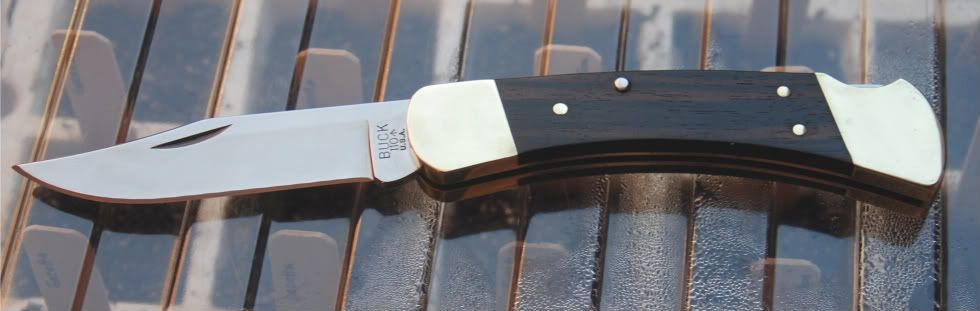

The swap is done. I've been wanting an old framed, macassar ebony with a premium steel 110 for a while and I think this one will is spot on for what I wanted. This blade is tighter than the Wally World knife so what could be better.
I forgot to say that the blade notch and the backspring matched up just fine. The blade does sit a little higher than the old blade. So I have a question with regard to that issue.
If I wanted to have the blade tip drop a tad lower in the frame, can I take a bit off the bottom of the ricasso?? I seem to remember that was the suggestion when I fubar'ed the canvas barehead project and I ended up with a high tip. Am I recalling that correctly? Thanks g
Ground down the ricasso a tad and everything is perfect.
