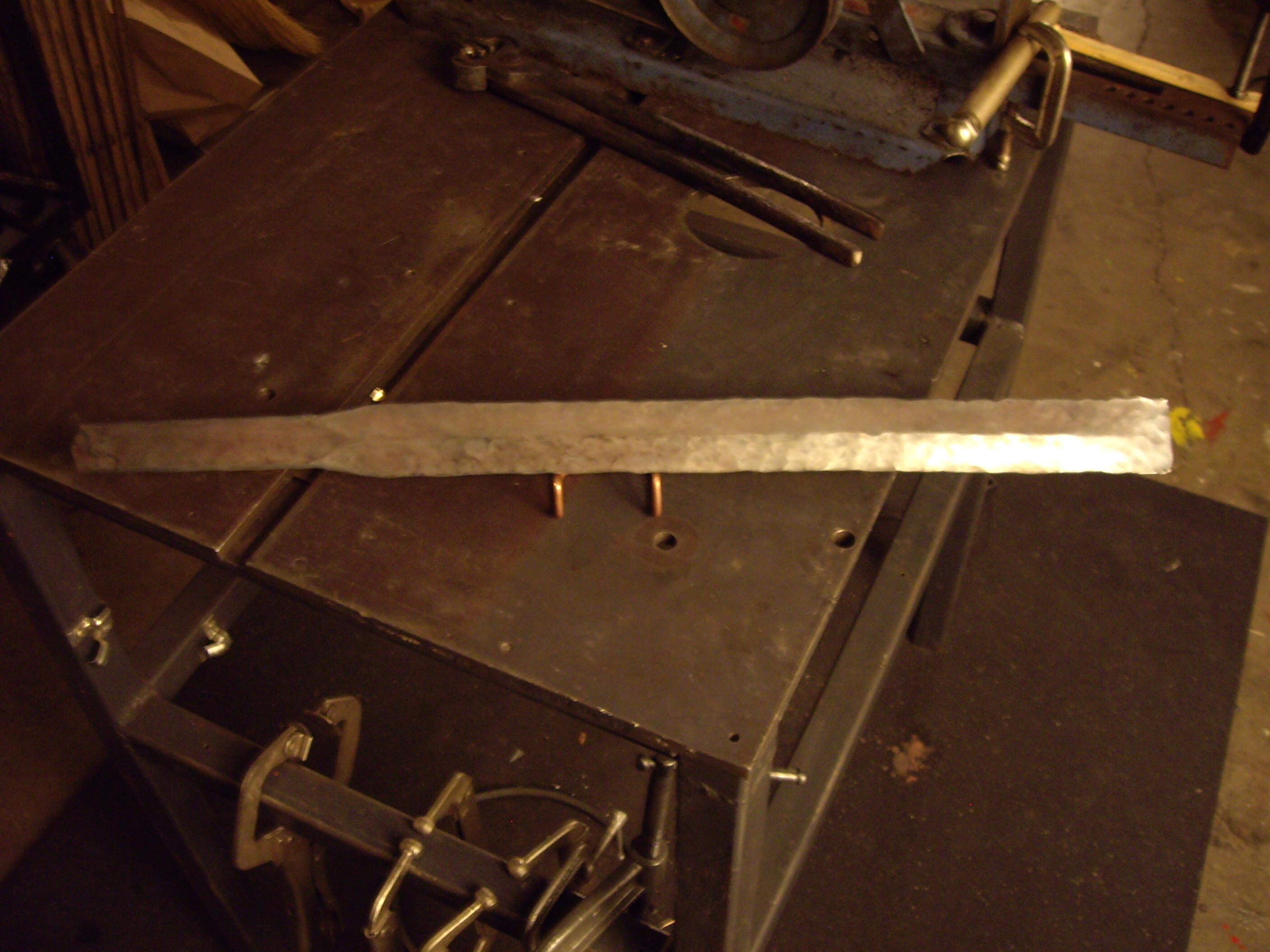

The sword side of the forum is too sleepy. Must be time for a public spectacle.
Presented for your viewing entertainment, the making of a beta titanium gladius, Mad Science Forge style!
Grab a goblet of wine, take a seat in the colosseum, ready your cheers and jeers, and let the games begin!
Entering the arena, 18 inches of very rare 89.5Ti 10Nb 0.5Fe titanium alloy, made in the U.S.A. Will it survive its first brutal challenge by fire and hydraulic forging press?

The bar has triumphed over the forging press this round! Not bad, but now let's see how this scrappy contender can hold out when faced with an onslaught of hammer and anvil!

Under duress of hammer and anvil, the bar has earned itself the title of billet. Yet before it may compete for gladius status, it needs to get a grip! Throw its tang to the forges!
The bar has triumphed in the tang trials, proving its true desire to be a sword! We shall test this metal's mettle yet. RELEASE THE GRINDER!

While our hopeful billet struggles with the fierce grinder, we shall hear of what makes it a worthy contender in this arena.
The bar is formed with the element of the Titans, well-known for their God-like strength, eternal as the mountains. When infused with the powers of Niobe, daughter of Tantalus, this Titanic strength changes form and becomes as firm as were her convictions, and hard like the stone skin she now wears.* It's no wonder this gladiator of a bar wishes to be a gladius!
*Niobium is a beta-stabilizing element. It makes the bar readily hardenable and heat-treatable. Niobium is also heavy, giving the the alloy a bit of extra weight. The element also "shields" the alloy from atmospheric contamination and pitting during forging, by limiting most of it to the depth of thermal expansion. This is important because titanium is very reactive when it's at high temperatures.

The billet has survived Death by Grinder! Still, all of its efforts could be in vain, for the metal's greatest single challenge looms before it. Hades may yet come in a flash to take it to the sword underworld, for now it must survive... THE QUENCH. Bring forth THE FIRE!
