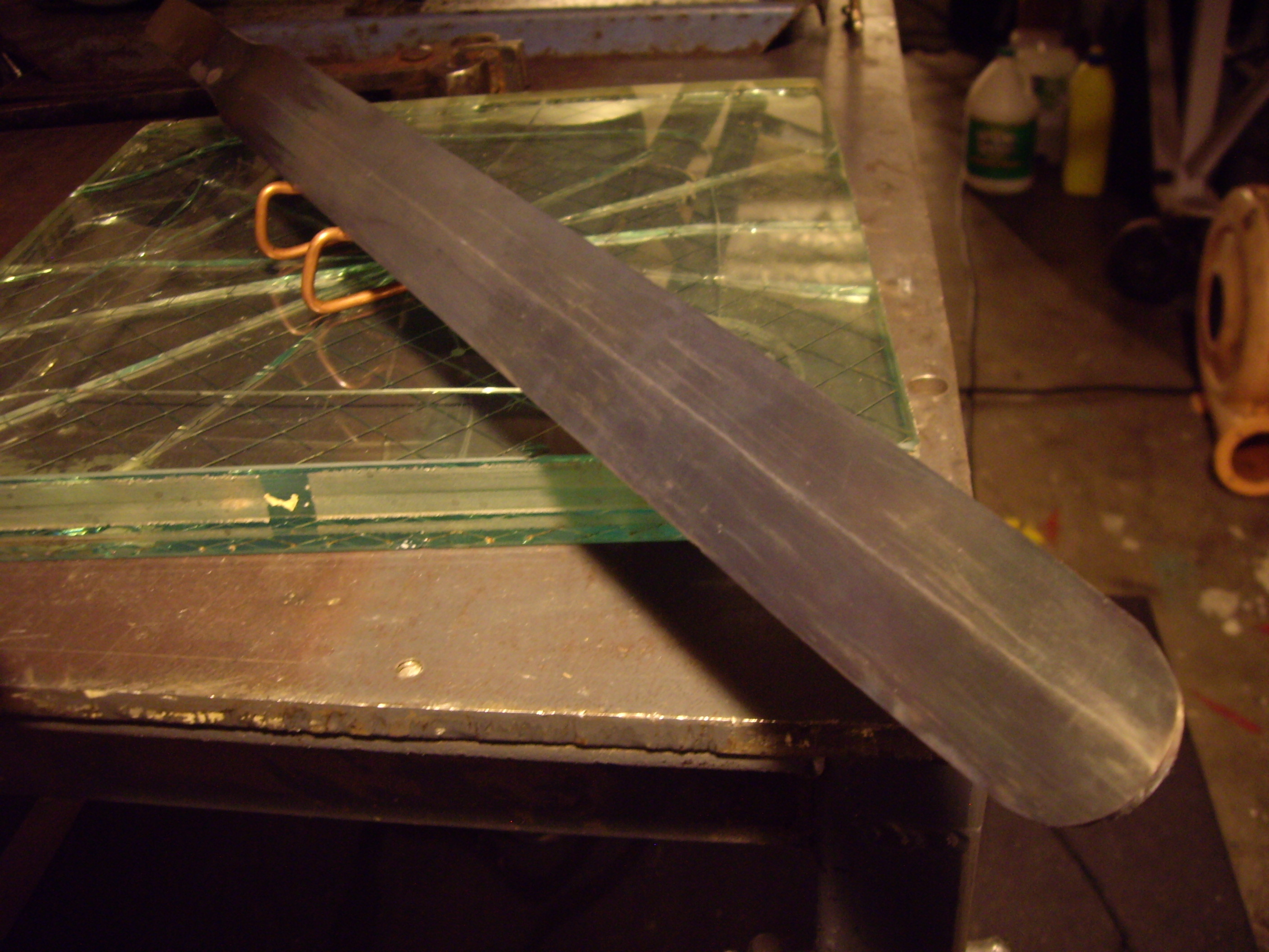

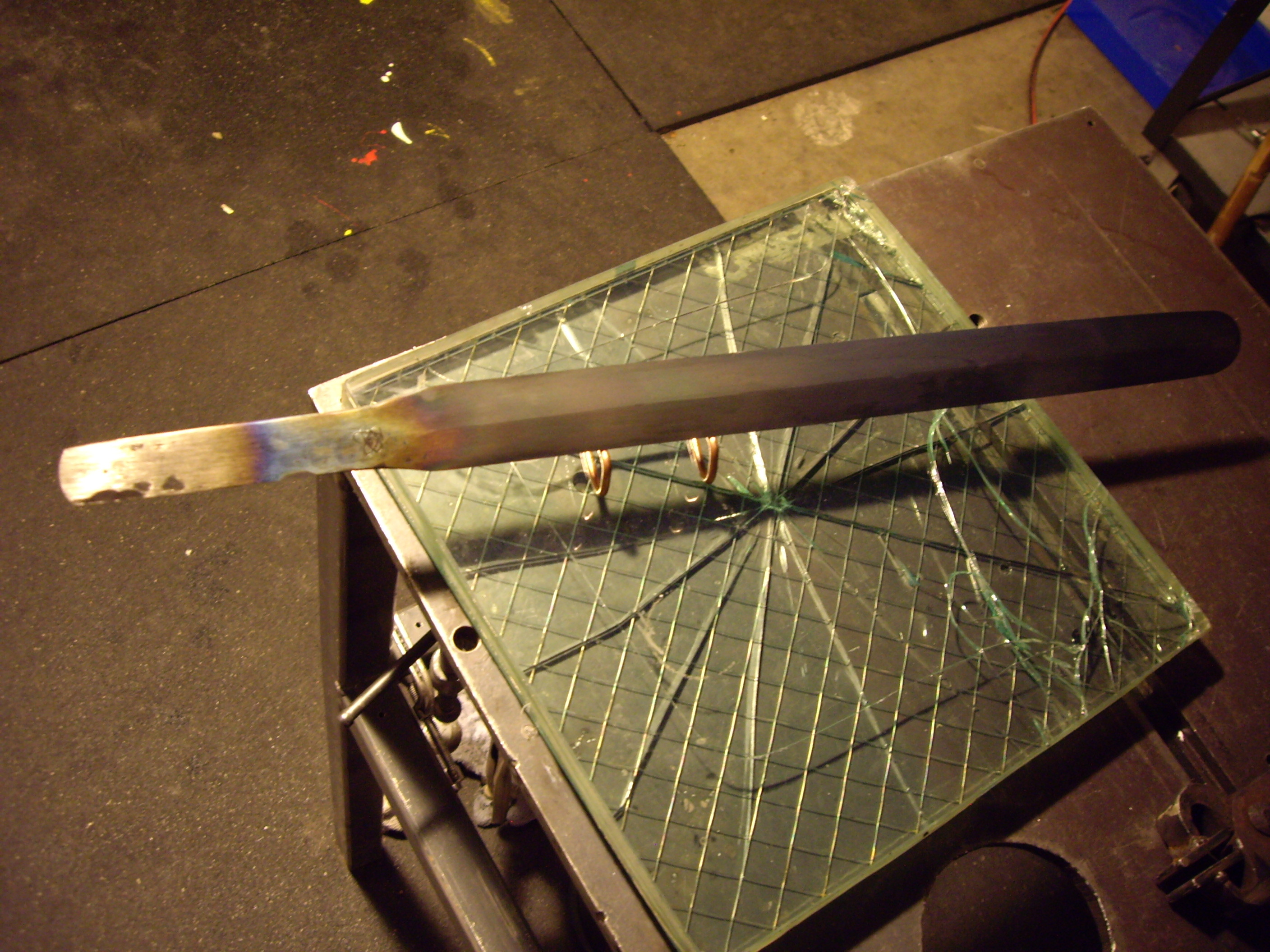

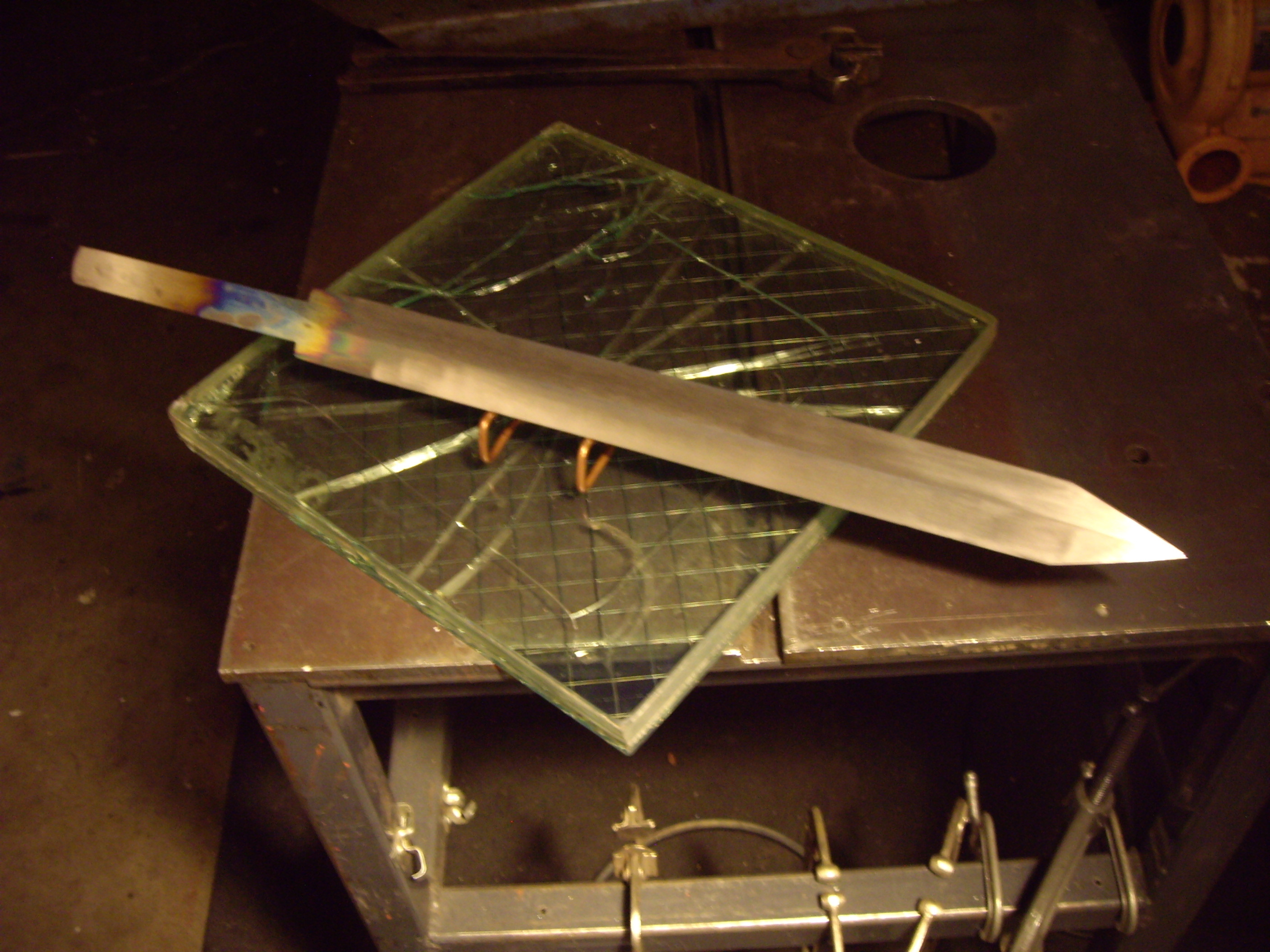

Friends, Romans, countrymen, lend me your eyes, for the sword has conquered the quench. It's battered and bruised, and bears the marks of its mighty trials. Yet it has persevered, and earned the right to a finish grinding. It will become a gladius!
extreme insecurity is caused in me by this endeavor my friend. This could in fact be the greatest Gladius ever made.... but it could shatter under the weight of the awesomeness with which it has been imbued... i fret greatly at its fate

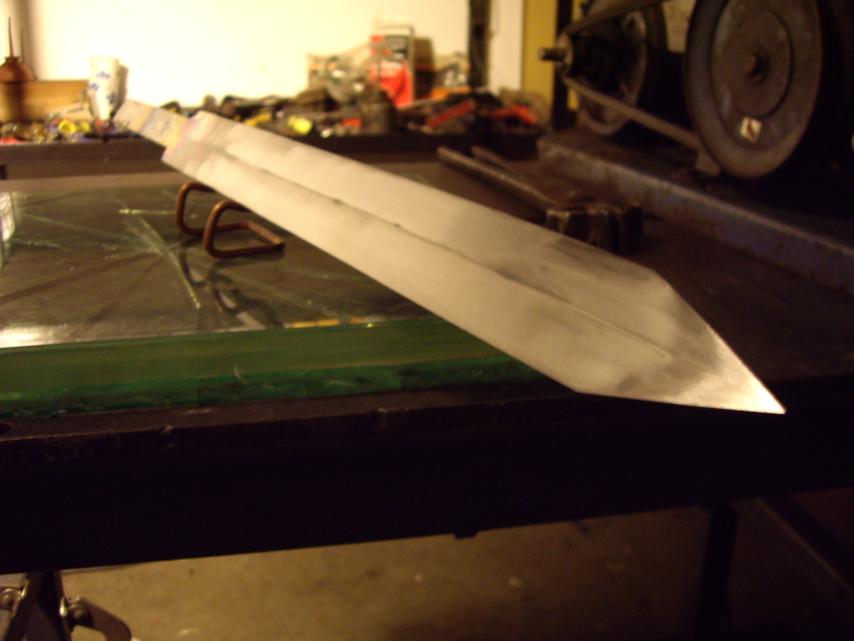

Before being pointed and polished, we will measure and weigh the gladial candidate. Our bar has grown lean with toil: currently 13.6 ounces, yet the sword hums with might!
It has also grown in size: 22 1/2" long, just shy of 1 1/2" in width, with a thickness at the diamond-section ridge measuring a bit more than 1/4" running the length of the blade, with a slight taper near the tip.

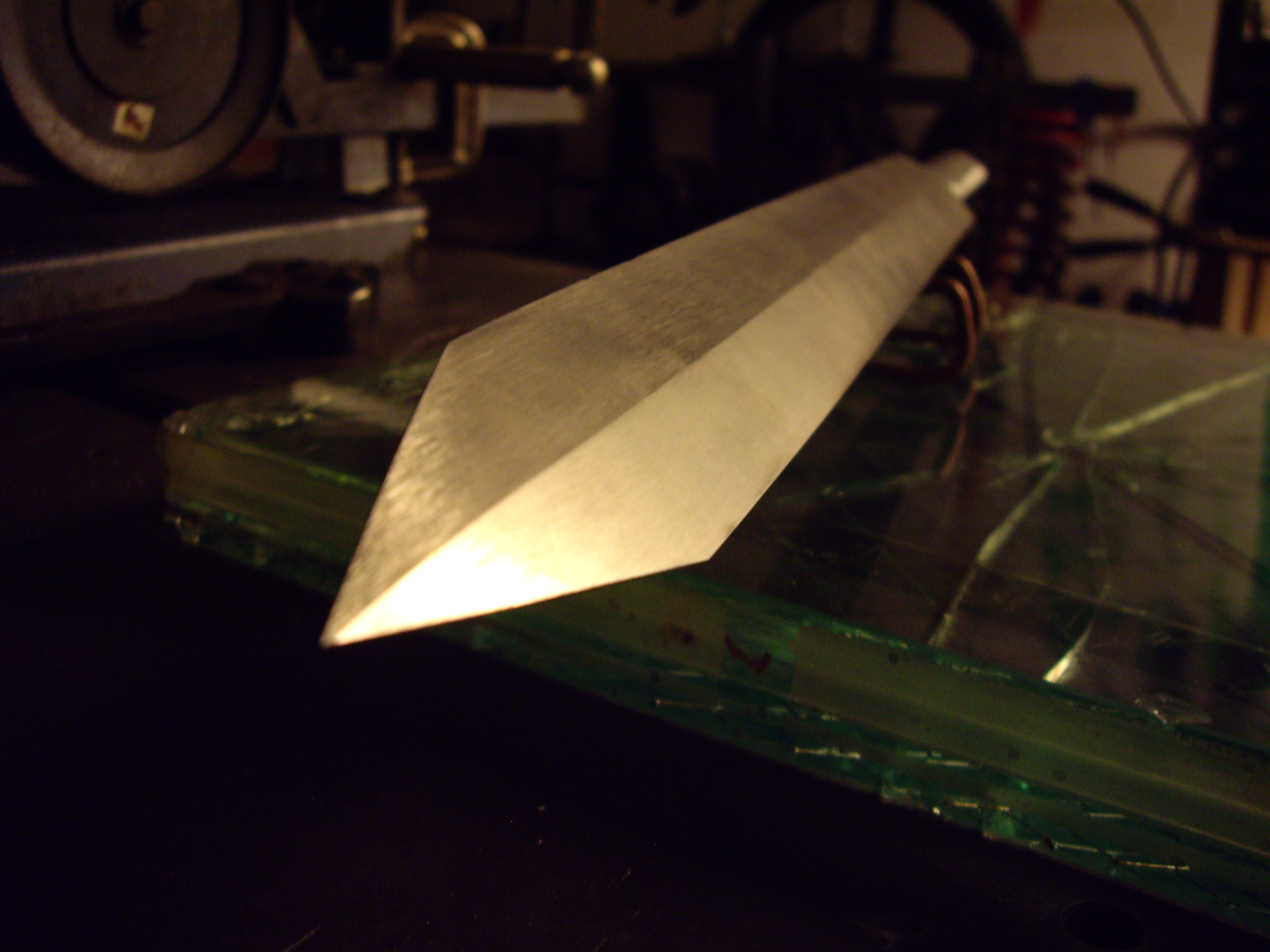

Though no archivist's image seems to fully capture the look of this newborn sword, still it will be known by name: Bombus Gladius, the buzzing sword! A bit more refinement and it will be ready for a fitting hilt.

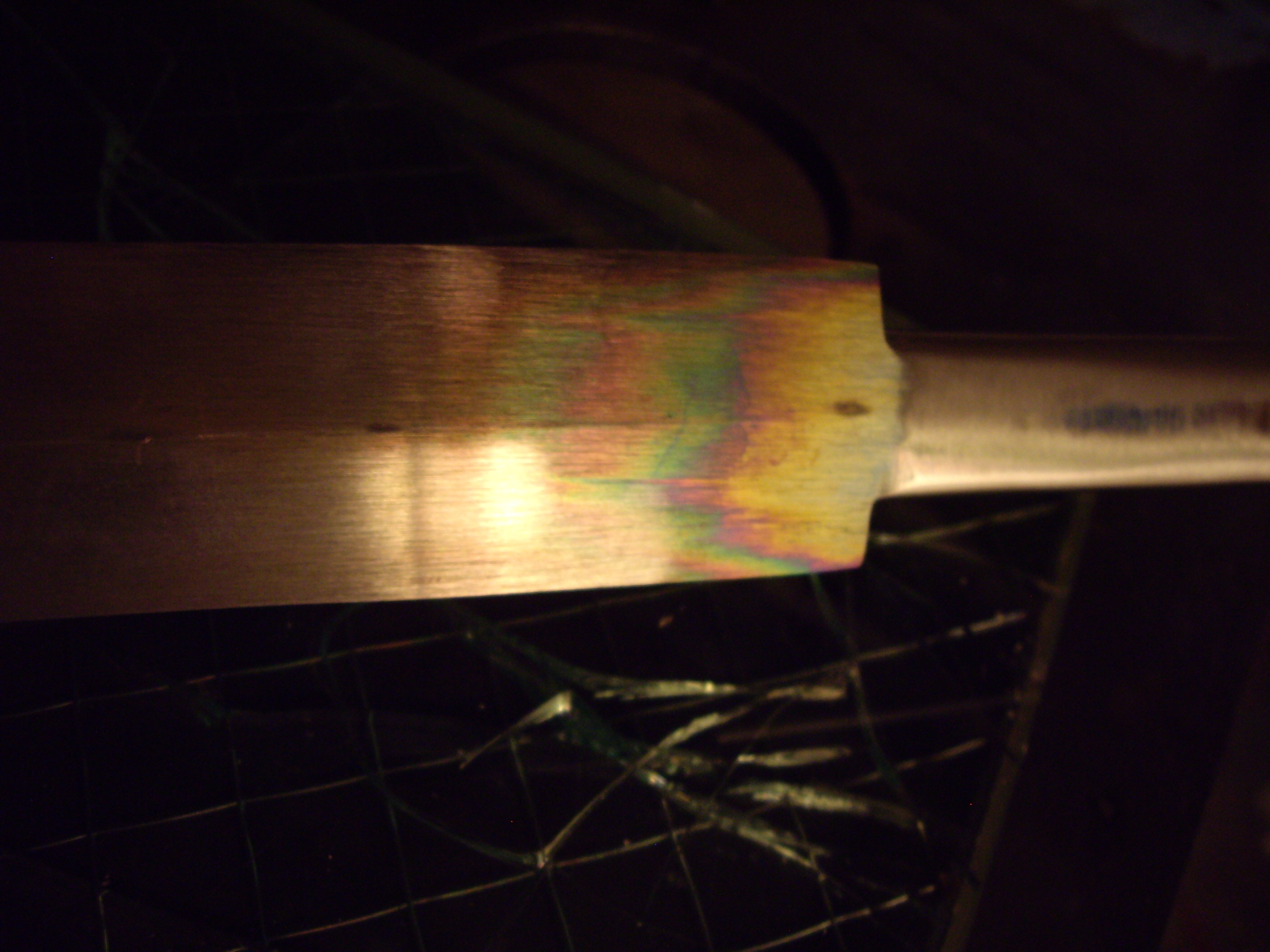

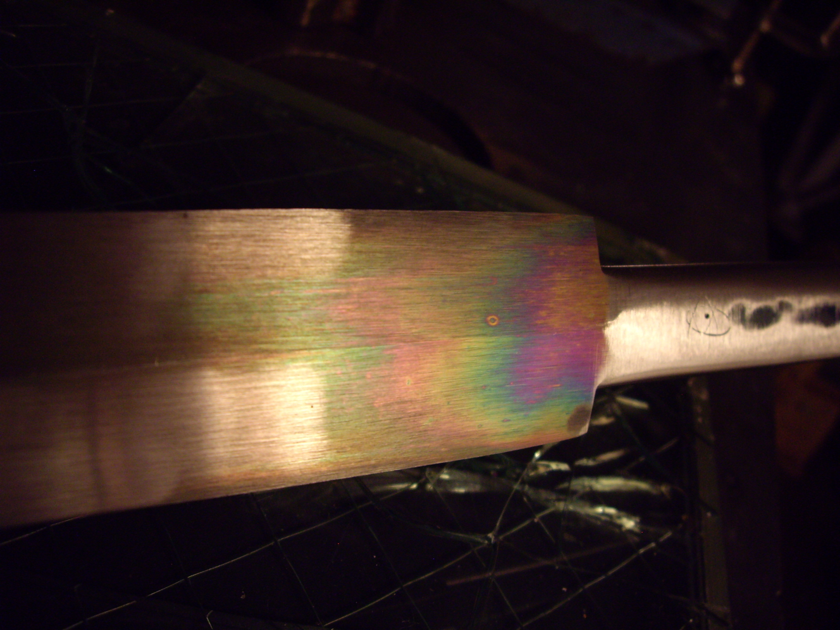

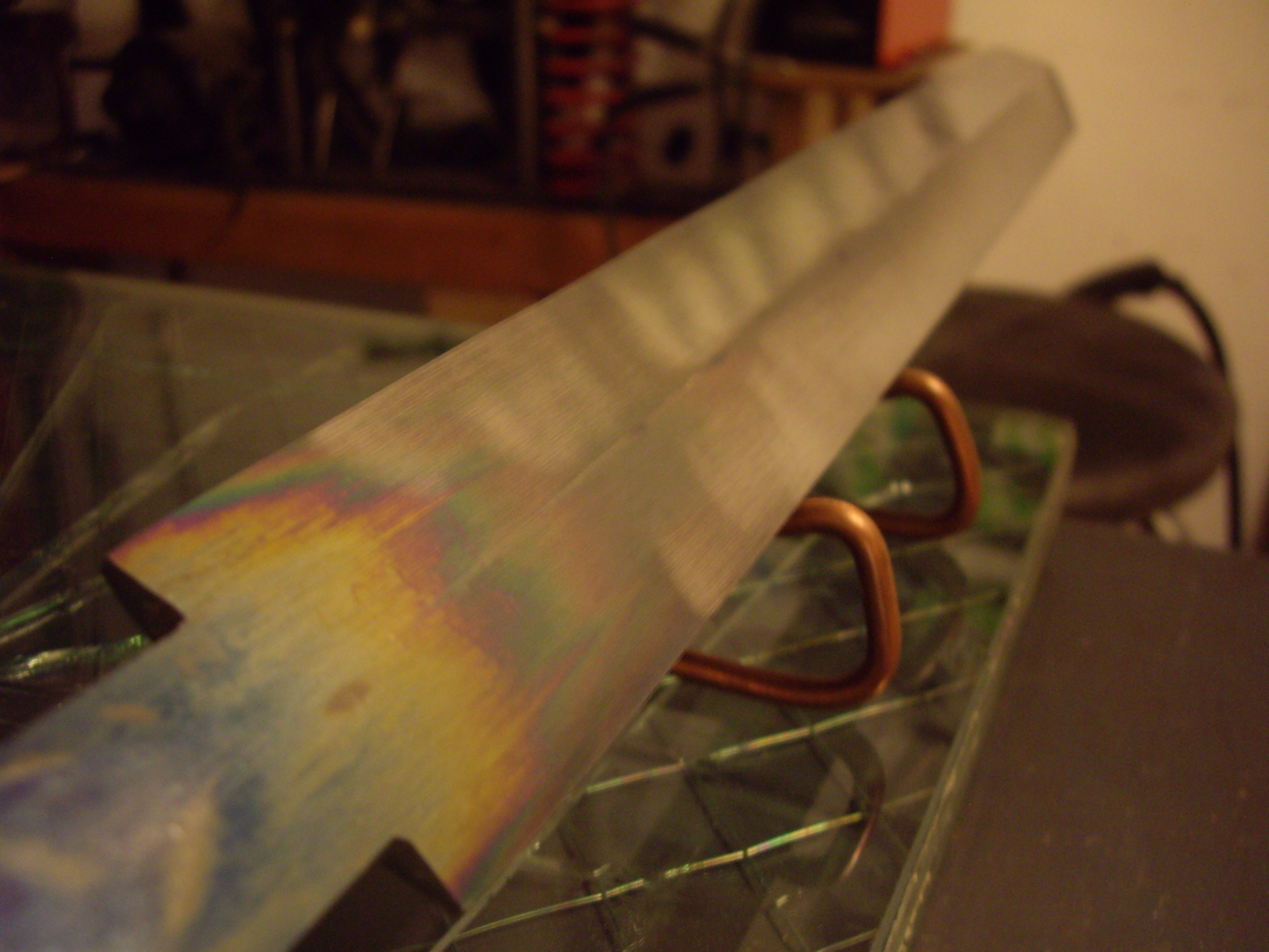

I sometimes wondered about the simple shape of the gladius, and how it would feel as a sword. It's NASTY, much more dangerous and intimidating than expected. Bombus Gladius has already both stabbed and cut me. I must keep a wary eye trained on it, and it will not be sharpened until fitted with hilt parts. In the meantime, here is a closer look at the colors left over from the quench.
