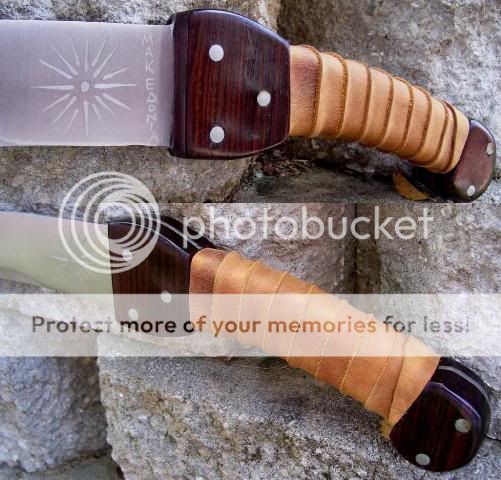

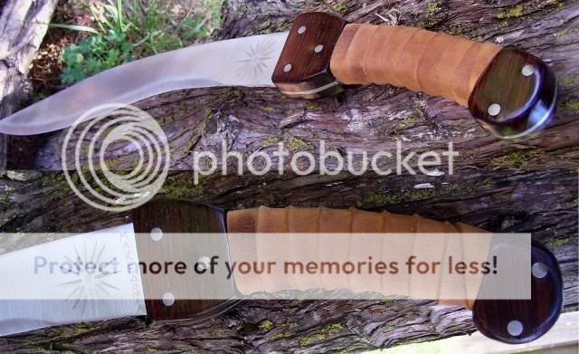

I hand etched the 16th Ray Star Panhellenic Symbol. The Greeks of Macedonia used it as their symbol. It represents the 12 Olympian Gods and the 4 Elements of Nature.

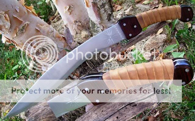

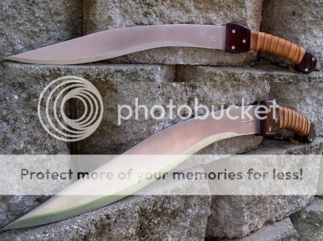

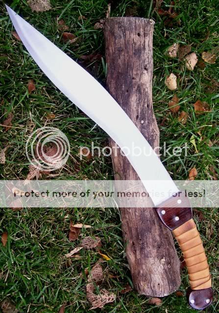

Saw Blade Steel was cut out and Normalized @ 1500 degrees until non magnetic, three times, to remove stresses and align crystals. Heat Hardened until blade became nonmagnetic, then quenched in 125 degree quality oil. Tempered the blade to a straw hardness @ 425 degrees for 1 hour, letting it air cool and repeating once more. Sword was file tested and is shown to be very hard.
Measurements:
Total Length = 25”
Blade Length = 17 ½ “
Blade Width = 2 3/16 “
Blade Thickness = 3/16 “
Handle Length = 7 ½ ”
Handle Width = 1 ½” x 1”
Handle: Cherry Wood and Leather Wrap
Weight = 1 lb 8 oz
