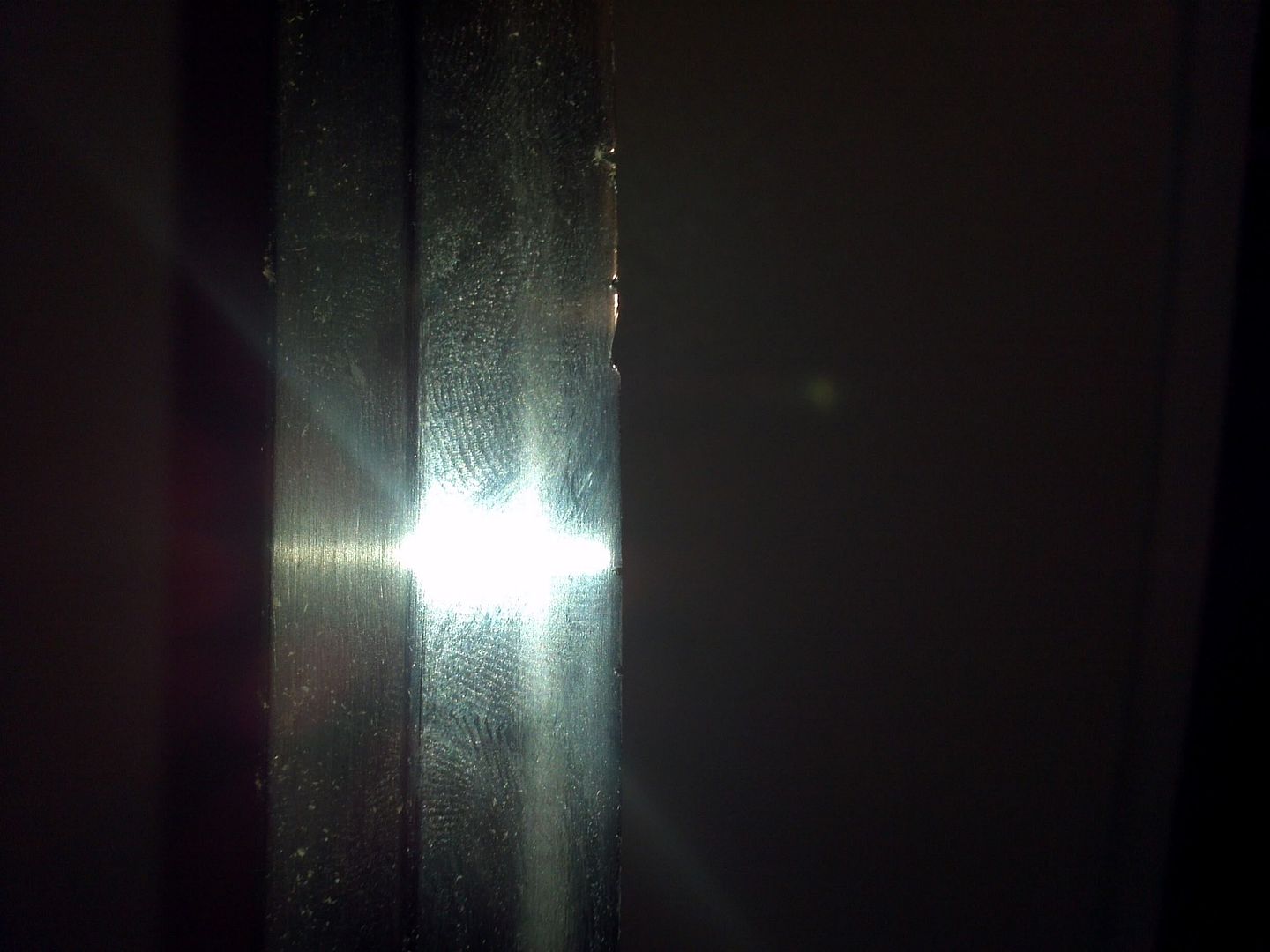

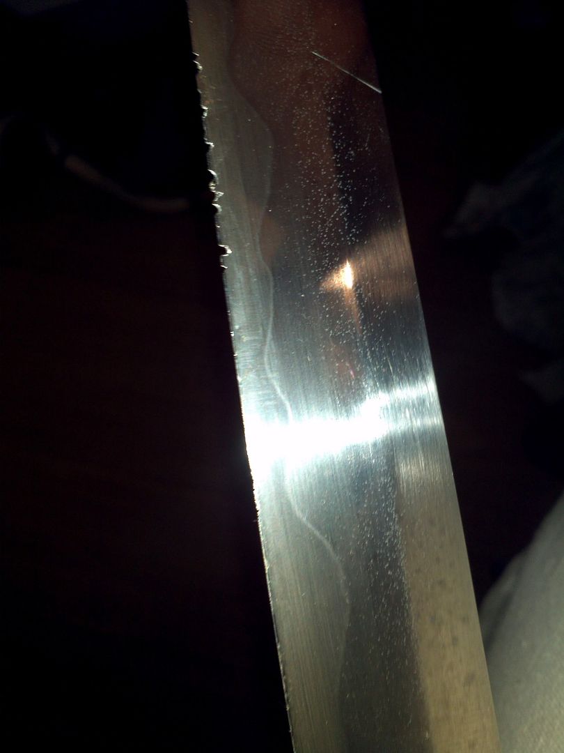

The damage due to edge to edge contact is not really that bad. I ran some tests using two katanas each of a different quality.
Blows were done with approximately 40% force. Keep in mind samurais rarely used full force using a katana for two reason:
1. If the opponent was wearing a silk kimono with no armor. 40% force would be more than enough to kill a man, or sever a limb. Why waste effort and risk damaging your katana why using full force, and lowering control over edge alignment.
2. If the opponent was wearing armor, using a katana at full force would result a heavily damage or broken katana and a very dead samurai.
Here's the result.
A Kris cutlery 29A (5160), and a Muneotoshi Take (1060).
This is the cheaper, lower quality Take:
This was the higher quality Kris Cutlery:
Thanks for the test, Luis. Nice to see some actual pics in here, rather than just speculation like the rest of us were offering up :D
