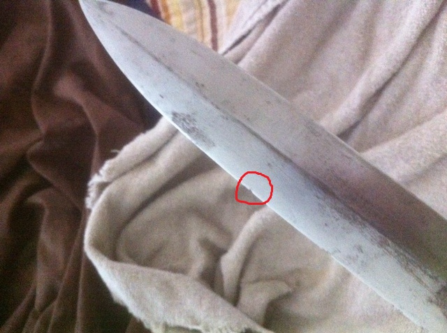

I did some edge-on-edge testing a few years back using a Windless cavalry sabre and a short sword I made out of 5160. I held the sabre in a vise, and braced the tip against a table. I then took full strength swings down onto the sabre. There was much less damage than I had expected, even on the Windless sabre. I put maybe 1/4" deep dings into the sabre, and >1/16" dings into my sword. I touched up my sword -- you can feel the nicks, but you wouldn't notice them to look at it. I can cut a free-hanging rope with the sword, it is sharp.
I've circled once of the dings. This is after resharpening.
Swords are much less delicate than everyone is assuming here. And the testing I did is completely unrealistic. No one would do a full strength hit directly onto a fixed sword. The whole point of parrying is to deflect the blow, not stop it. Even with something like a St. George parry (blocking an straight hit to your head) your parry will have give.
