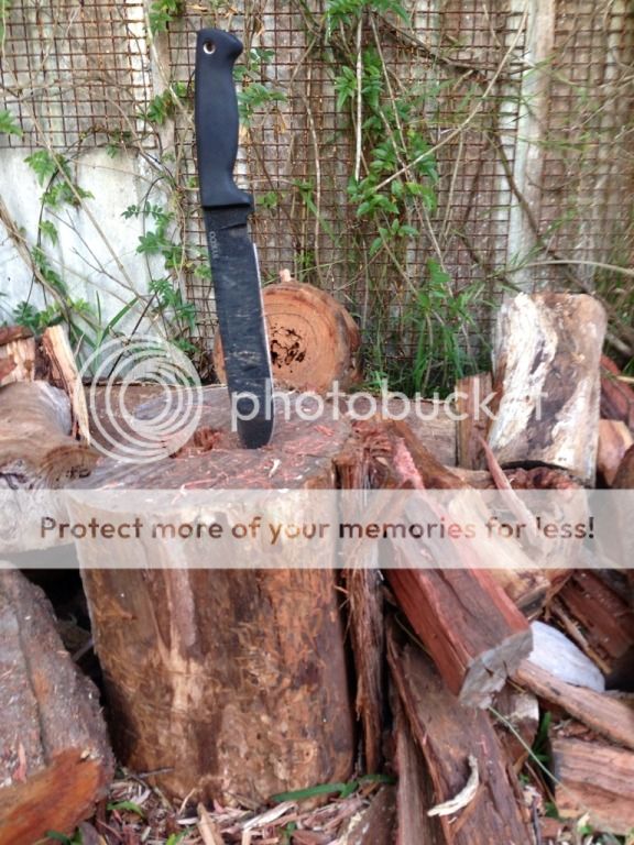

All very good points, A to the 4th, thanks for all the input! By any chance do you have any pics of the 911 you could post?

911 is a great larger knife, used mine some and rally liked it. The Res-C handle pretty much eliminates all the vibration while chopping and makes it very comfortable to batton with. Balance is very good for the size, it is quite light for a chopper which is a bonus for on foot travel.
