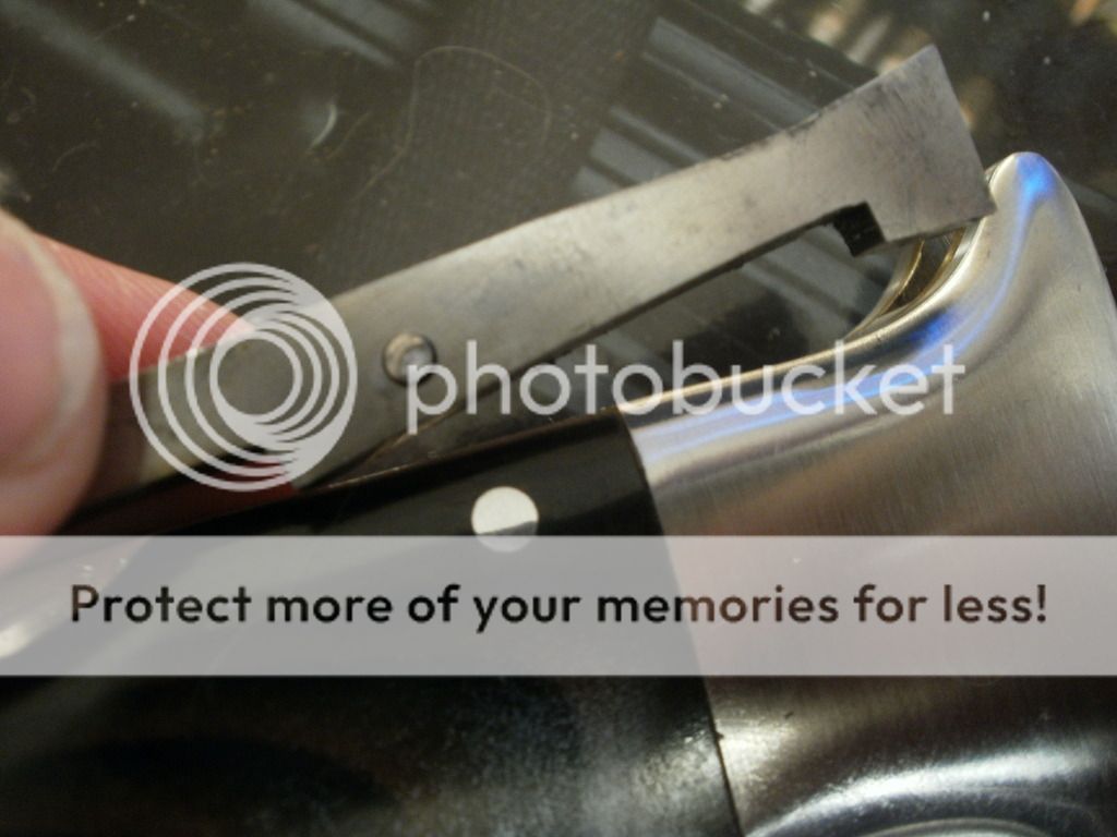

P.S. And to be clear, it is the lock-bar's pivot pin that failed, not the main blade's pivot pin which is hugely strong and visible as almost 3/16" in diameter on both the micarta and synthetic version: The disparity between the main blade pivot pin and the lock-bar pivot pin is 2:1 on the 3003a micarta version and easily 3:1 on the synthetic 3003b version. Maybe the Micarta version will hold up if the pin is harder, but for such a hugely heavy folder the 3:1 ratio makes for an obvious weak point on the synthetic 3003b: Had this 3X thinner pin been externally visible I never would have bought the synthetic version. As it is, it is concealed under the moulded scales...
the lock-bar's pivot pin sheared off under the strain of chopping in about 20 chops on Maple

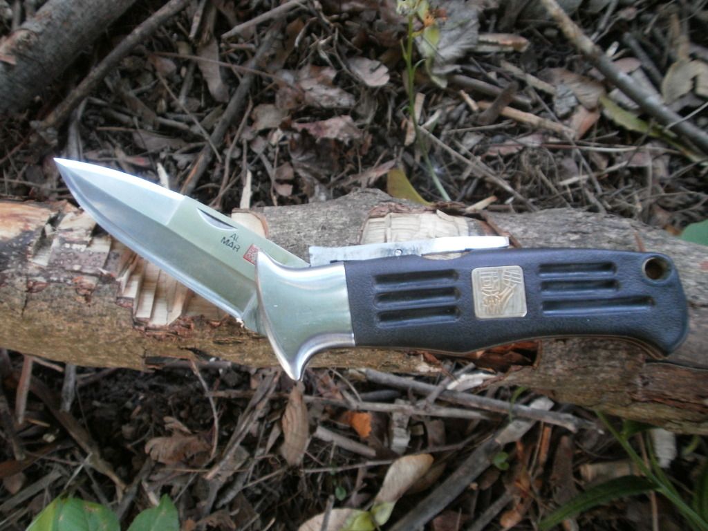

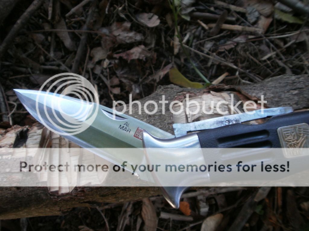

Anyway here are the photos:
The edge is 10 degree per side (by REK), and note it held up much better than the whole knife(!). The chop marks are from other knives, as this knife could not do this much damage that easily...
Here is a comparison of the failed lockbar pivot pin to the Micarta handle 3003a version:
A bit of a crock really, as a similar knife with different handle "scales" should be mechanically identical, and this is a long, long way from being the case...: Look at the shearing action on the pin: That shearing action has a tiny bit of yellow colored metal clinging to it, because if you look at the knife's frame it is brass: So the steel pin was sheared off cleanly by the edges of sheets of brass...
That tiny pin cannot be hardened all that hard for that to happen...
Not only was the pin far smaller than on the micarta 3003a version, but on the 3003a the pins are probably hardened much harder than pins that brass can shear... I think this unacceptable shortcut was allowed by the fact the pins are not apparent (unlike on the Micarta version), so the "defect" is concealed. From who it was meant to be concealed I don't know. This is a bit like some of the Blackie Collins or the Walther P99 sheaths having cardboard side panels... I'll soon know if the Micarta version holds up better...
Probably harder? You said before it was hardened and thus harder?
But yup, sad to see a 30 year old classic knife abused and broken like this.
is it possible that the pin is rivet set in the micarta handle, and therefore has the same diameter? as to shear load, the edge doing the shearing is only as good as what supports it, so why couldn't some brass with no where to deform to provide a shearing point.

The fact is the Al Mar's pin was so soft and small, it was sheared by the folder's brass frame...
In fact most Seki-made folders of the era have these soft pins, the old aluminium Spyderco Civilian even having one for the main pivot: This is pot metal you can actually mark with your NAIL...: Try all your old Spyderco's 1980s pivots, Endura, Delica etc, their pivot extremity will take a mark from your nail...
This softness means any amount of opening/closing cycles will eat the pin inside and loosen the knife: The current hardened screw pivots are a huge improvement...
