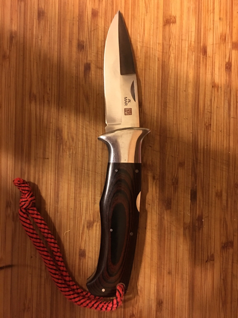

Synthetic handle Al Mar Sere Attack 3003b breakage

I have found this destruction of the Sere interesting. Al Mar knives were given quite a bit of hype. They are well made and had a premium price, but maybe they weren't quite as robust as the hype suggested. Then again every knife has some luck built in. This broken Sere seems to have little luck in it, another might have faired better. I like mine and not going to repeat the test. I'll use it my way and see how long the luck runs; I may get years and years of normal use out of it; or not.
...In fact most Seki-made folders of the era have these soft pins, the old aluminium Spyderco Civilian even having one for the main pivot: This is pot metal you can actually mark with your NAIL...: Try all your old Spyderco's 1980s pivots, Endura, Delica etc, their pivot extremity will take a mark from your nail...
This softness means any amount of opening/closing cycles will eat the pin inside and loosen the knife: The current hardened screw pivots are a huge improvement...
The only problems reported about old Civilians is a broken off tip and the kraton inserts coming up. My daughter has a endura that is quite old, bought used for $5. Pivot's going strong. Integral clip broke off, tip was snapped off due to abuse, serrations are worn down at least 20%, but it's going strong. Maybe the mark you are leaving is from your nail :)
I believe, for Spydercos, the change to screw construction is to adjust the action and be able to take out the blade for service. Spydercos with pinned construction have never had a chronic problem with bad pivots. Same with the Cold Steel Voyager line, this was Seki made with pinned construction, they are notoriously strong knives.
As I recall Al Mar was a martial Arts practioner and his knives were marketed as fighting knives, not choppers, nice job destroying a vintage piece of cutlery history. This destruction test did not help anyone.
Those soft unhardened no-screw pins are actually common on Seki City made folding knives, especially older ones, and even some of the high end ones: All the early 1980/early 90s plastic handle Spydercos are made like that... My Aluminium Spyderco Civilian had a soft pin for the main pivot, and it was an expensive knife back in the mid 90s... The pin's metal is so soft you can mark it with your nail... On the polished micarta handle SERE they would have to be hardened pins to take the fine polish, so the micarta pins are definitely harder: No nail marking is possible on mine...).
Even the very first Spyderco Military had screws that were just drilled directly into the friable G-10 scale on the opposite end...: The screw thread did not touch any metal, they just screwed into soft synthetic on the other side... That was what was holding this thing together... That is even far worse than soft pot-metal pins... It is actually unbelievable, but fortunately it didn't last long...
Sure your 20 year old Seki folders are holding together fine, and so did my Civilian for 15 years, but really, there should be no place on a serious knife for such garbage soft pot-metal pins... It's just common sense...
Also there is no reason for the pin diameter to be smaller on the synthetic handle version than on the micarta...
I've seen $20 folders that had proper hardened screws everywhere... I think even some $10 folders have them... People who are defending what Seki City did for decades are just in denial: Sure, these older expensive knives are holding together, if without any serious test, but is that how they should be built when today even gas-station junk has proper screw pivots? Of course not.
