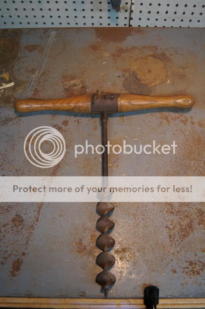

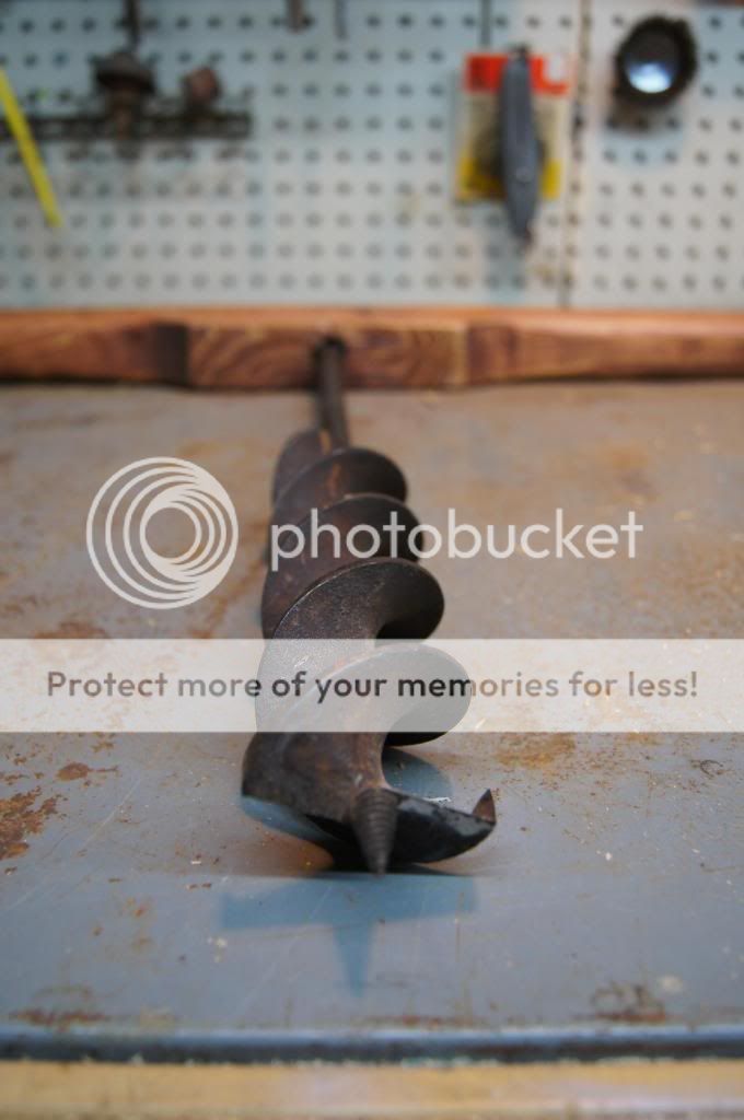

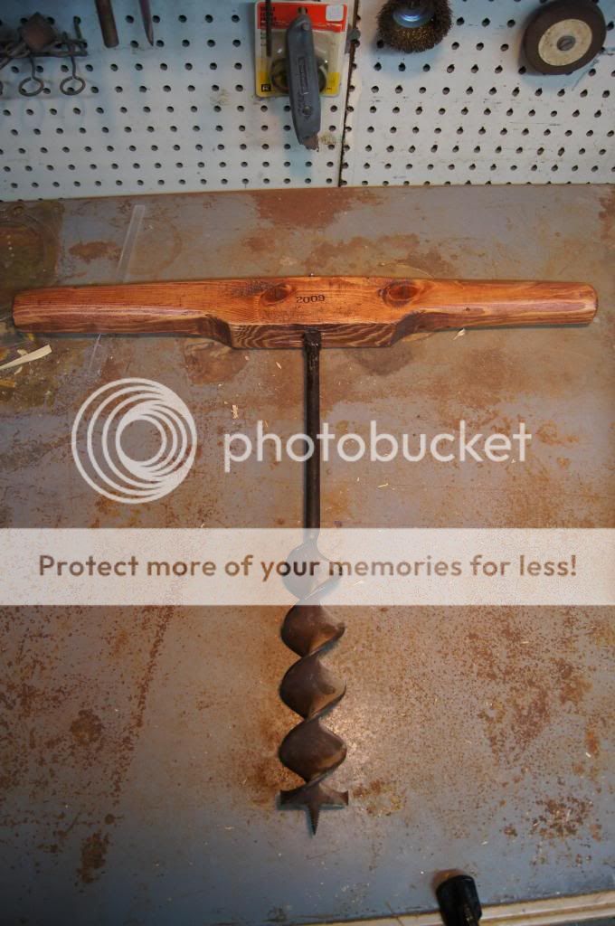

Here's my 2-1/2" as a teaser. It has a home made elm handle. The hole is perpendicular to the grain so it won't split (like elm would split anyway). I cleaned it up and sharpened it and re-cut the lead screw threads with a triangle file. Cuts great!
When sharpening an 2-bladed auger you need make some test cuts to see if both blades are cutting evenly. If one blade is proud it produces a thicker shaving. Then you file it down until you get even shavings off of both blades.

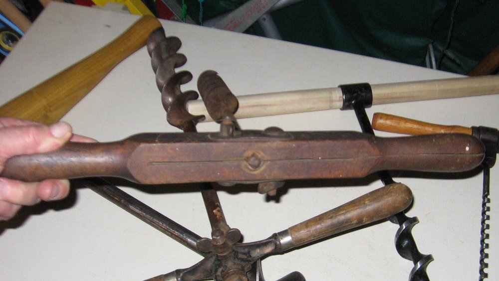

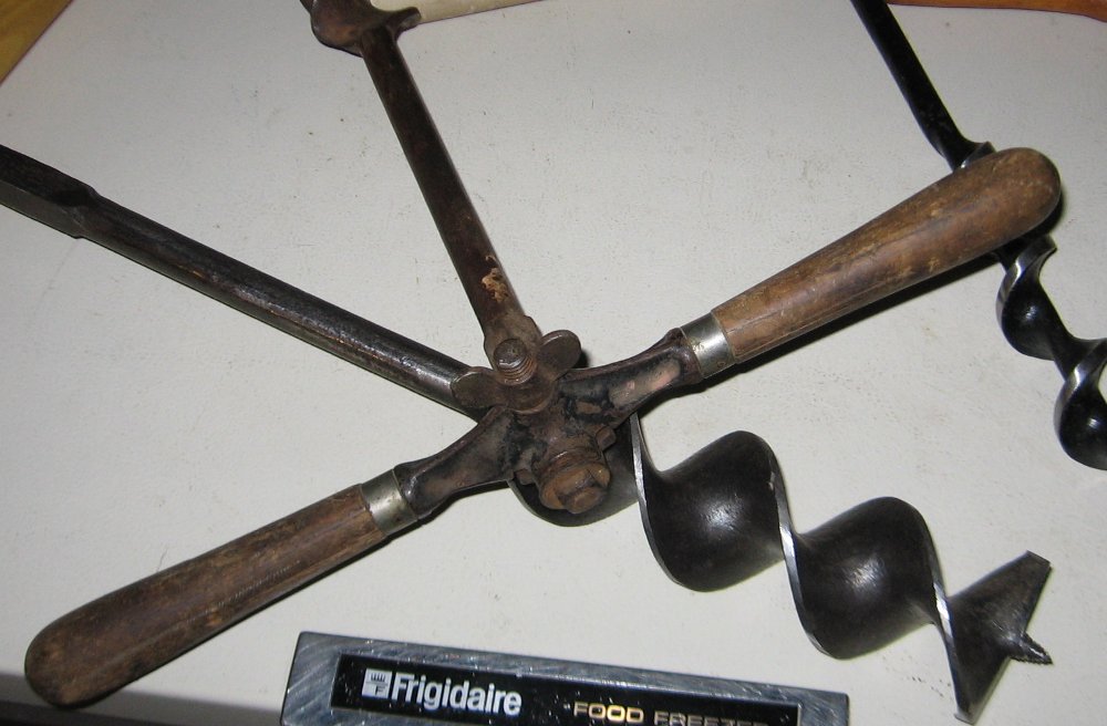

OK, Matt. Here's a few more pics. Group photo.
Clockwise from lower left: The 2-1/2" I posted earlier, 2" with a cast steel 'T' - no makers mark visible, 1-1/2" R.S.&W.Co. -Patented 1888, 1-1/2" Swedish military surplus, 7/16" U.S. military surplus by Irwin.
The most used are the 7/16" Irwin and the 1-1/2" Swedish. I use the 7/16 to drill rebar holes in logs for making turnpikes on the trails. If we get a group of youth volunteers then they have a good time drilling the holes by hand.

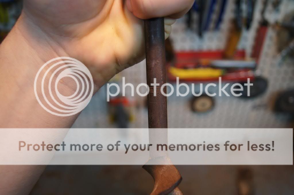

Here's a close up of the cast steel 'T' on the 2".

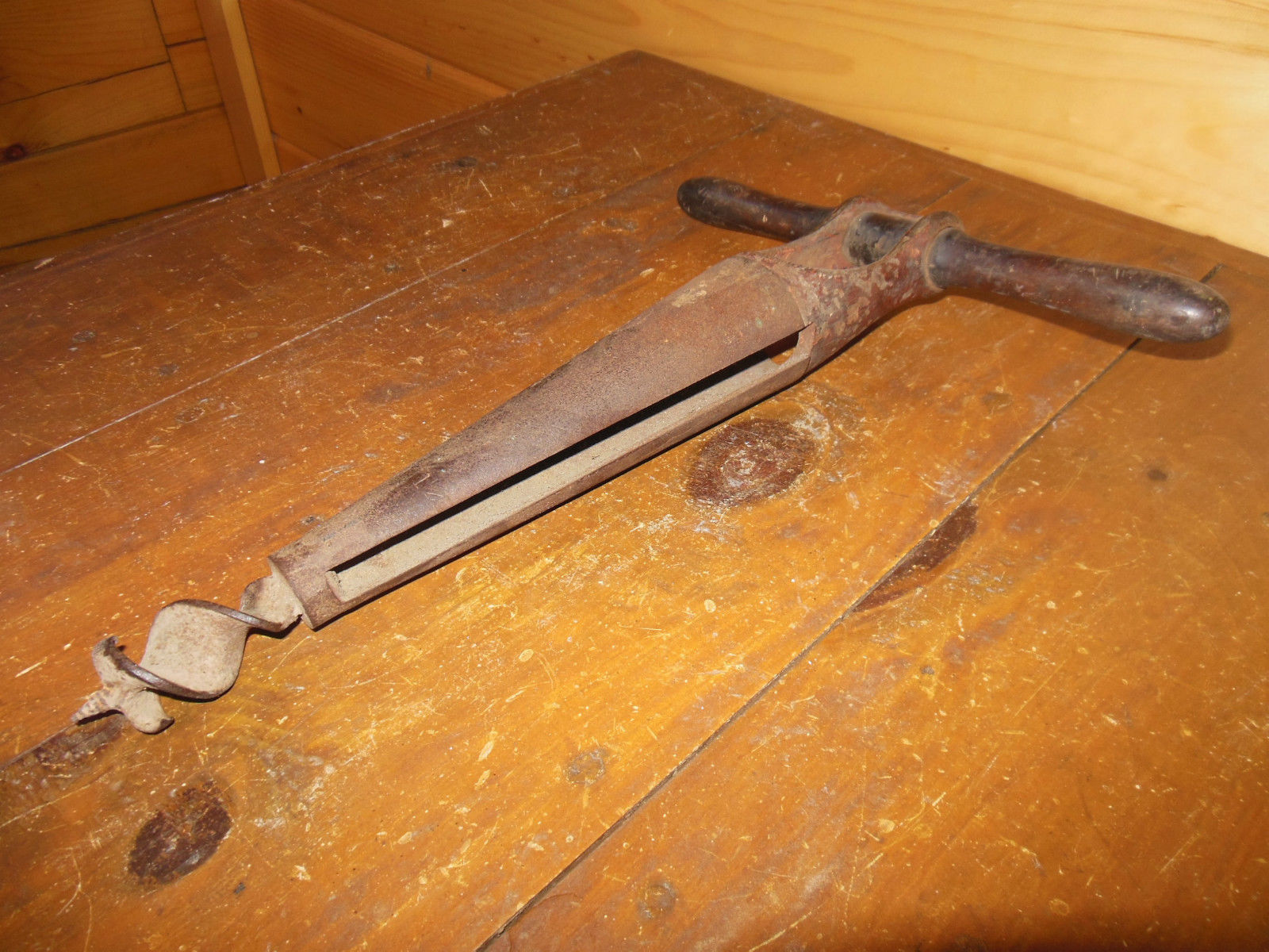

Here's the R.S.& W.Co. It has a slot cut down the middle to give some flex and then bolts with wing nuts on either side of the auger's taper.

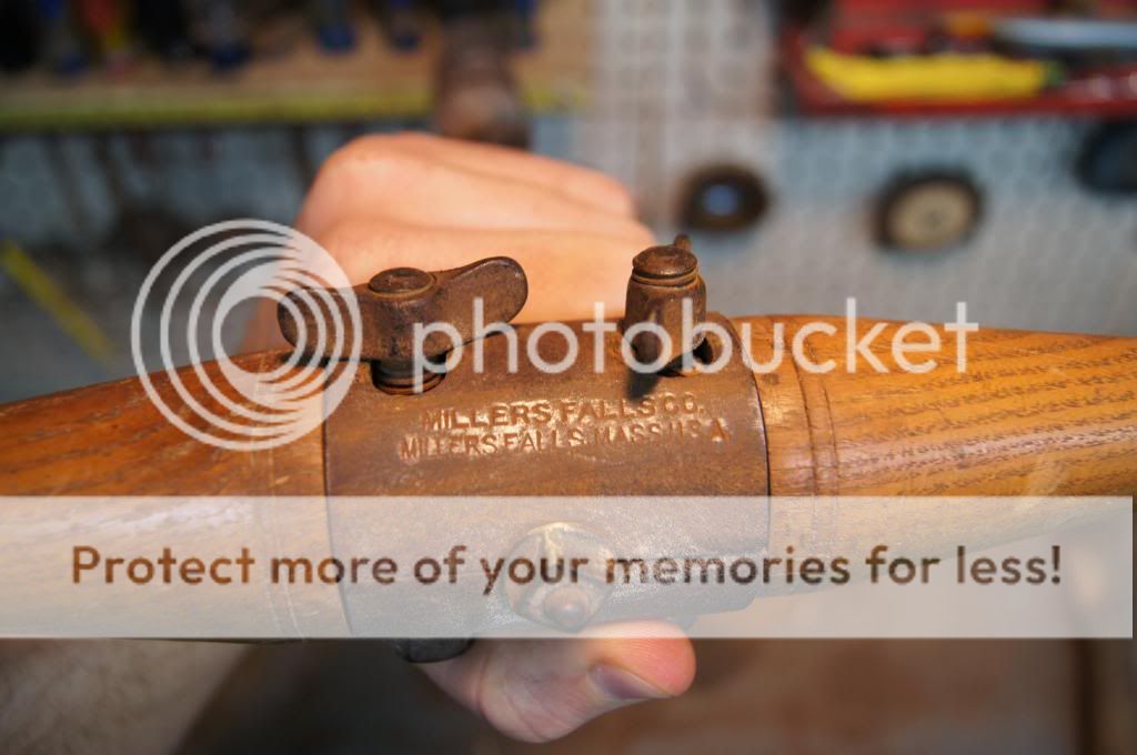

Finally, the 2-1/2" with the original handle that came with it.
