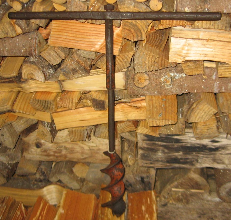

Cool Auger, Tools are like women, when they call to you "take me home" its damn hard to say no.New addition to the set today, a 3"! I saw this at a local flea market and it called to me.
It's obviously a blacksmith made one-off auger. Close inspection shows that it was forged out of flat stock with the shaft rolled together and drawn out. The only markings are crude stampings reading "C I T Y E N G". The handle made out of a piece of 3/4" rebar and I think it might be original.

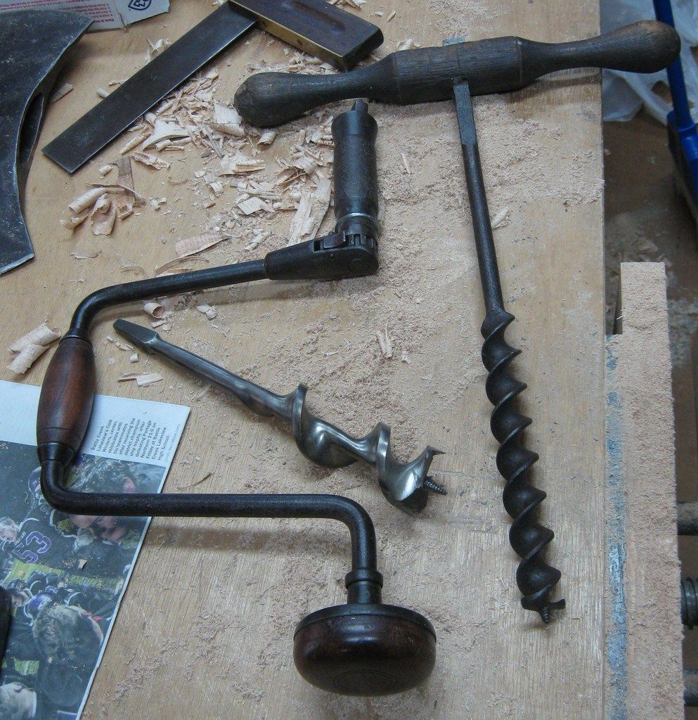

This is actually a question about an auger bit for a two-jaw hand brace... I hope I'm forgiven.
I've got an auger bit that seems like the tapered square section has broken off (or maybe it never had one). Is there anything I could do that would make this bit usable on my brace? The makeshift ideas I've come up with don't seem like they'd hold up against all the torque.

Make it square? Just a thought. A grinder might do it pretty quick.
