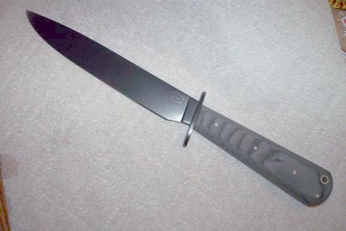

well, here it is, just need to figure out how to make the sheath.
After about 4 atempts I finaly figured out how to do the Gun Koat, if I ever do any more there gonna air brushed!
Handle is black linnen mycarta, sanded to 320 and bead blasted for grip, mortised with stainless pins piened and they are bead blasted for dull finish, and everything is acureglassed together.

this should be a better view of your knife
BTW nice Blade.. :D
Pretty Will. You da man.

Will I keep coming back to look at your knife! And I just figured out what draws me: it's your handle. The swell out to the butt gives it a good look, should make it more secure in the hand and I'd bet my next paycheck that it really enhances the overall balance. I'm guessing this is why you made a mortised handle. That's a fine knife.

Thanks, it's a little on the rough side, but it definatly cuts well and is pretty well balanced, no worries Dave :D . I was going for as light and slim as I could get and still be usefull.
The sheath is in the works, but I head back to the rig tomorrow night, so I don't know if I'll finish it by then, it'll be close.
