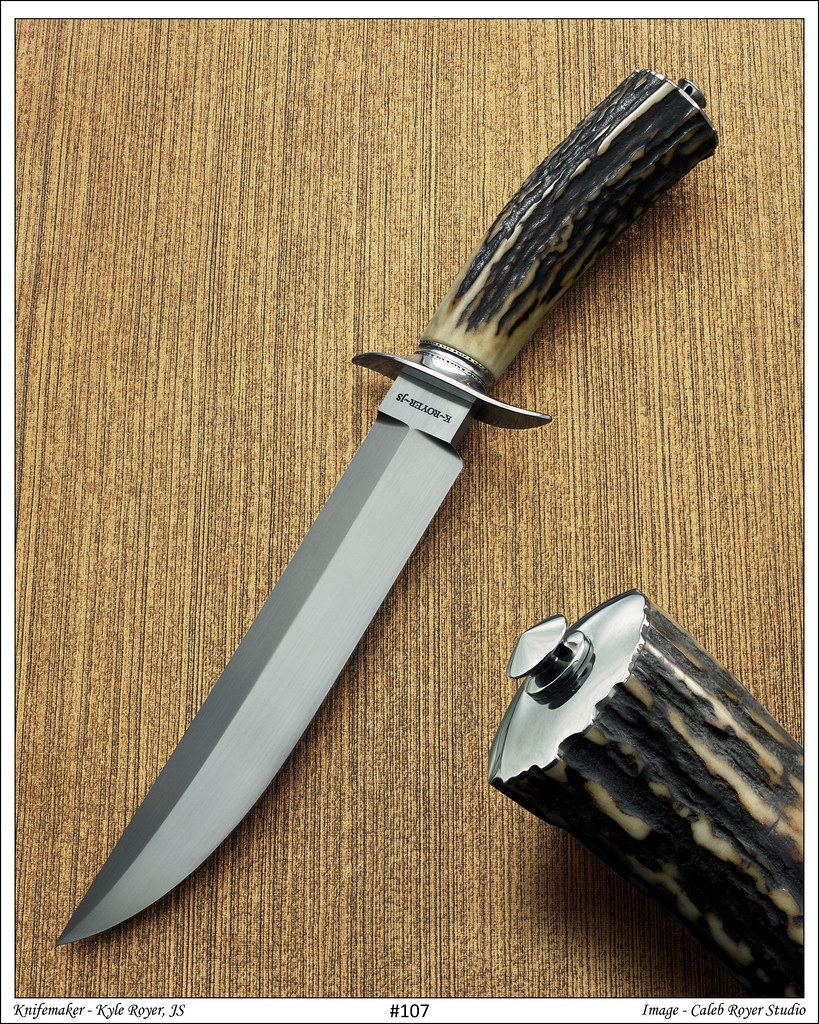

Here is the final picture of the knife my Brother Caleb shot. I think he did a great job.

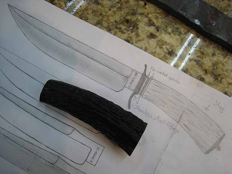

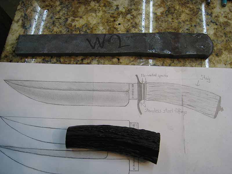

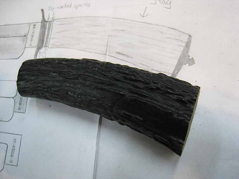

Here is a sketch of the knife, my steel and the stag I'll use.
Here is a close up of the stag. I think it will look nice on this knife.

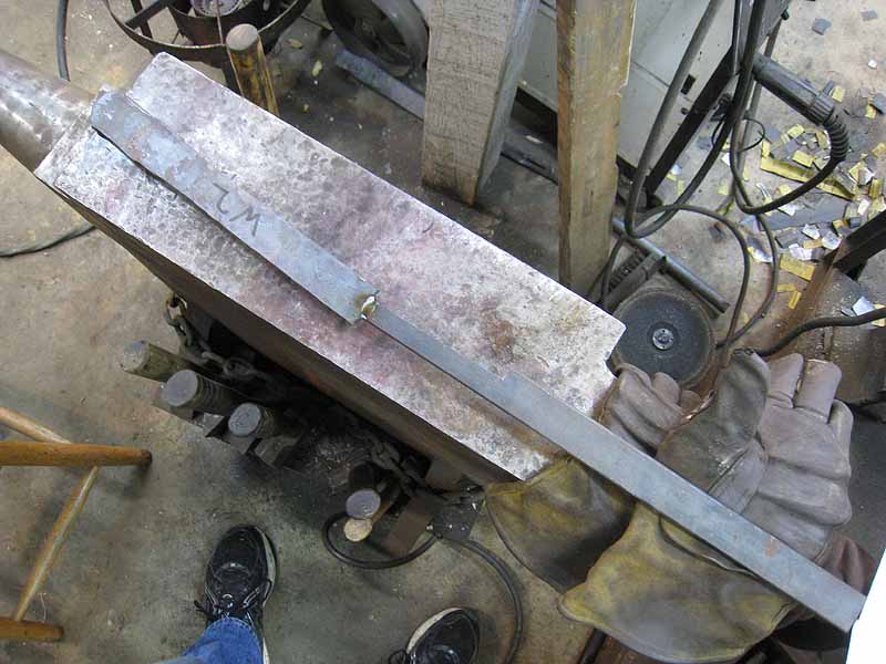

In this pic, I've welded a handle to my bar of W-2 to make it easier to hold and work with. This is some 2" W-2 that I forged down into a smaller bar of which I got from
Don Hanson III. Thanks Don!

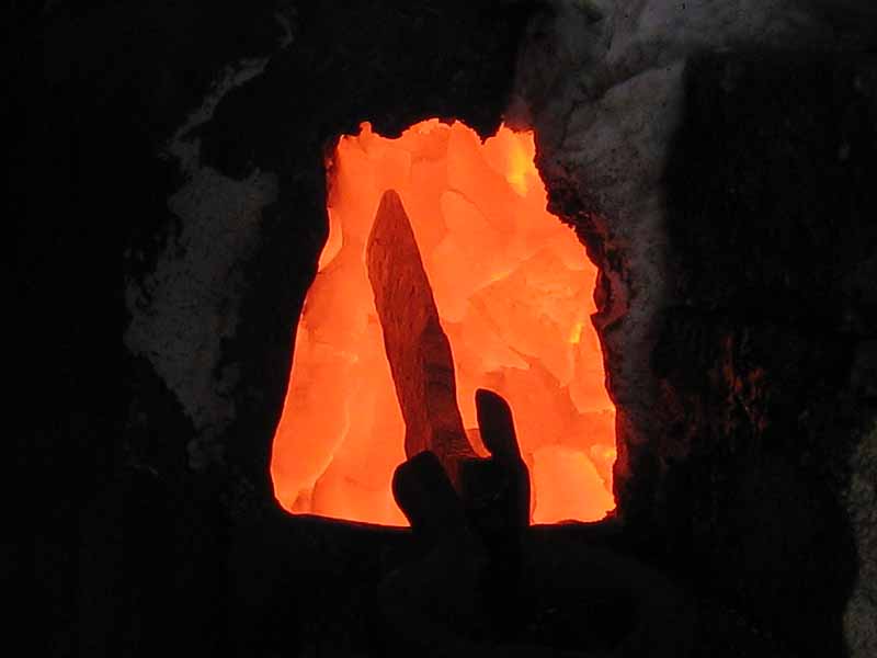

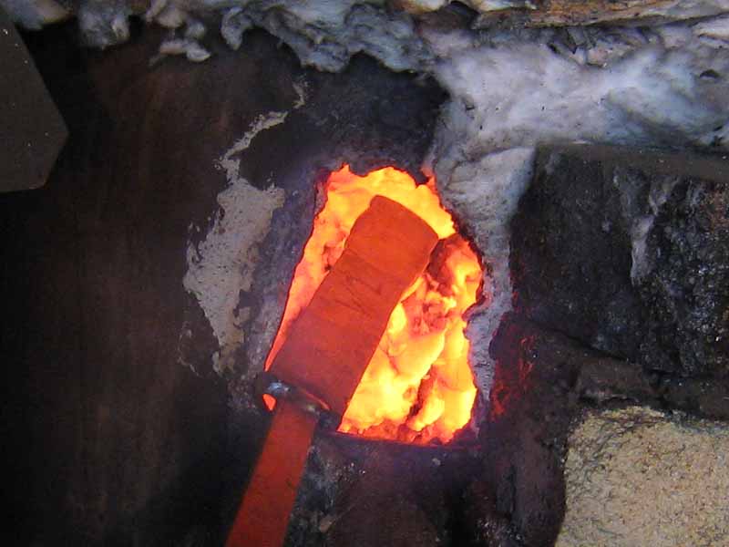

Heating up in the forge.
Now I'm using my press to forge the bar down to about 0.340 thick and 1.250 wide. I am making this knife a little thicker because it will lose a lot of weight from the double grind so I have to compensate for it a little. I would like my finished thickness to be 0.285 to 0.310 thick when I'm done.

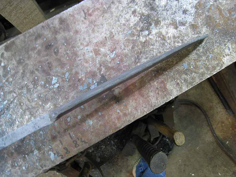

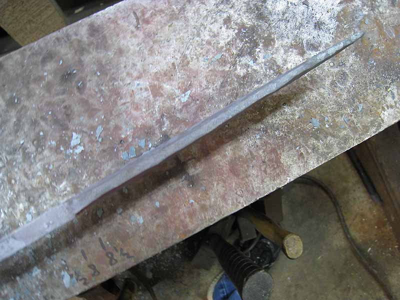

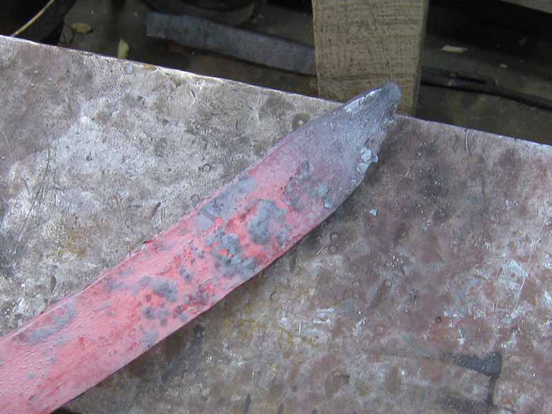

Here you can already start to see the taper I'm forging into the blade.

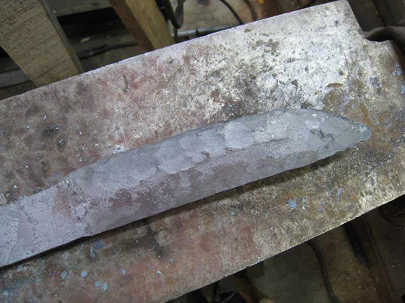

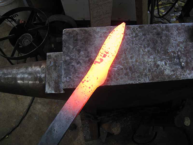

I have started shaping the tip here. So far I've done everything with my press. Next I'll start forging in the blade bevels.
In this pic I've started forging the primary blade bevel, starting at the ricasso.

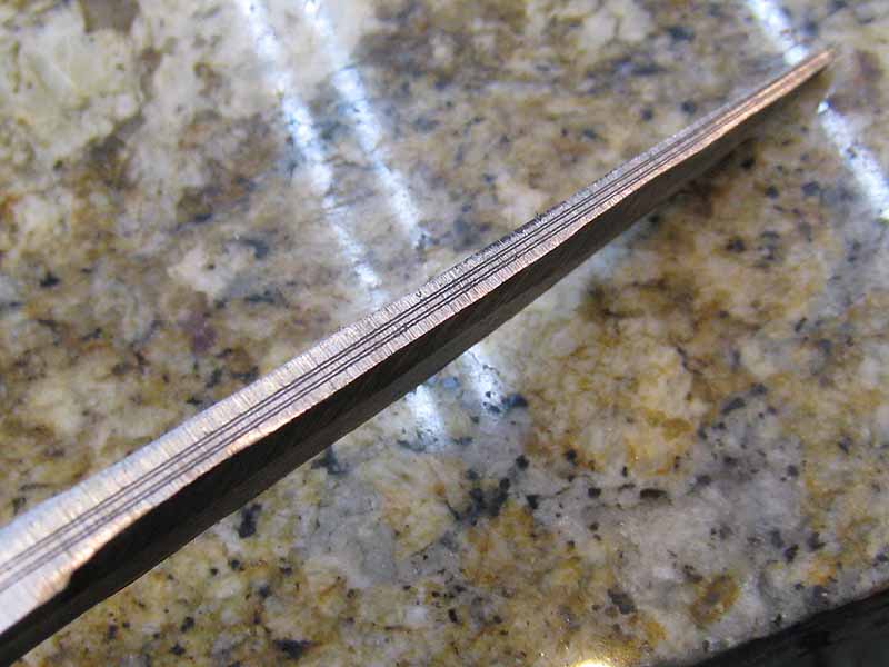

I have rough forged the top and bottom bevels in here. I left a good bit of material on the top bevel.
Here is a top view of the top bevel. I still have some refining to do on it.
Here is a view of the bottom bevel rough forged.

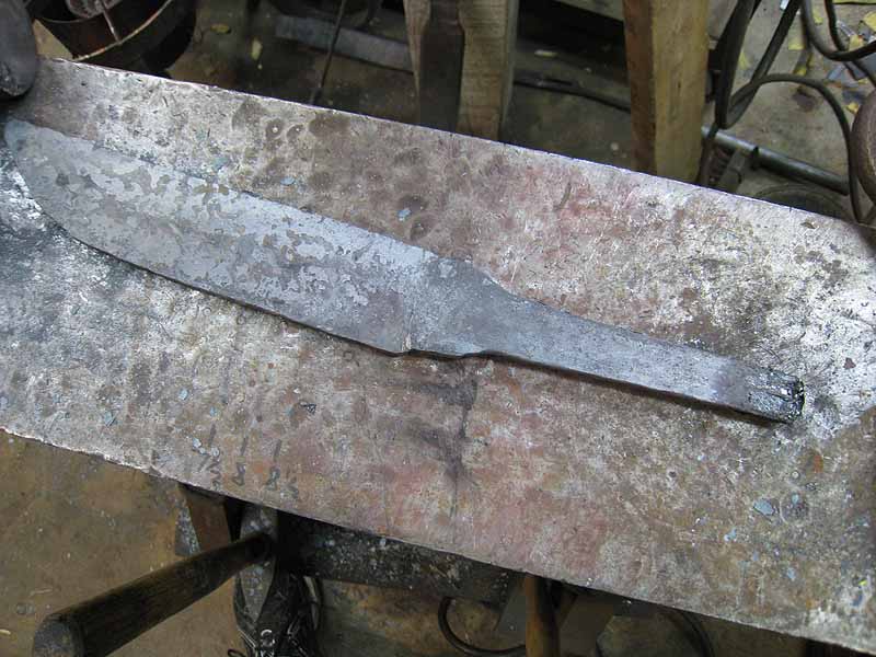

In this picture I've hot cut the bar so I can forge my tang out. I also did a little refining on the blade bevels.

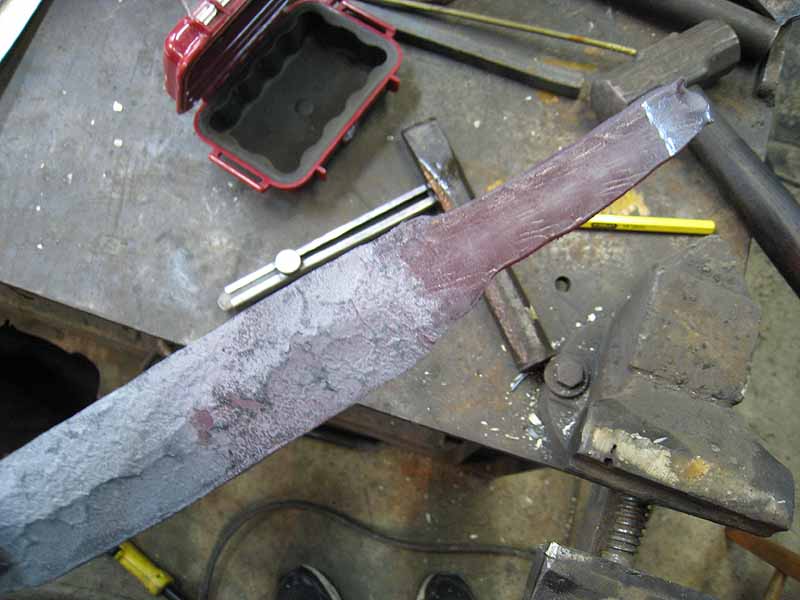

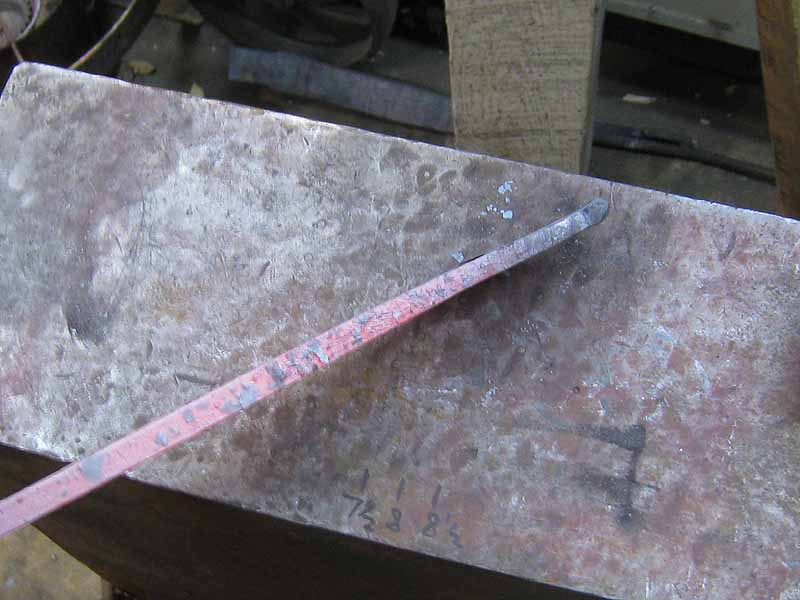

I started forging the tang out here with my press. I'll forge the tang completely with my press and curve it with a hammer before I'm done.
The tang has been forged out all the way here, ready to be curved with a hammer so it will match the radius of the stag.

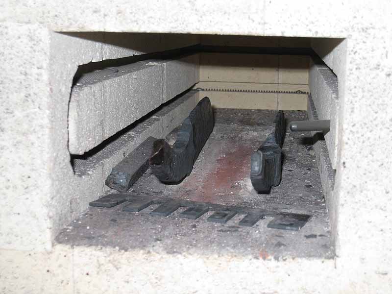

Now I am going to run a partial annealing cycle on the blade by heating it up in my Paragon to 1450F and let it cool on it's own slowly. This will further help relax the grain.

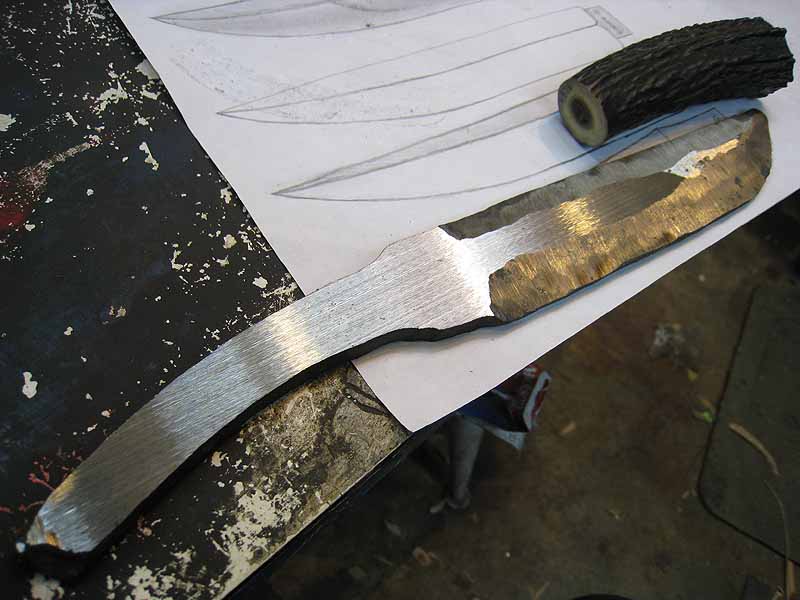

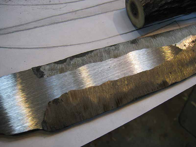

This is the blade after being rough ground with an angle grinder.

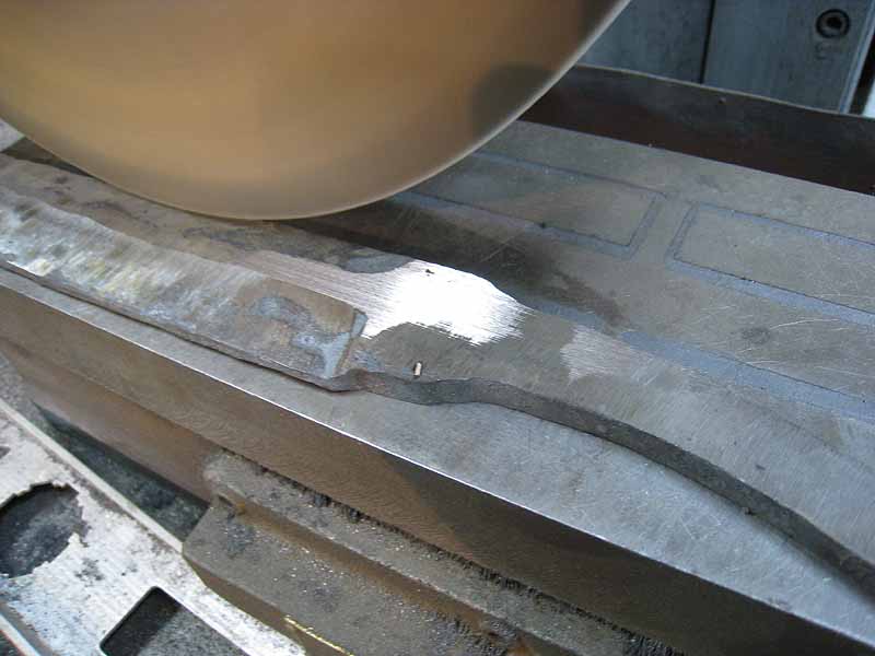

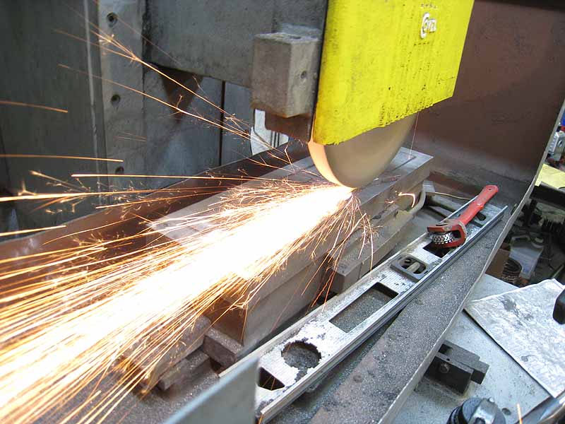

I am surface grinding the ricasso and tang in this pic.
It's looking good so I'll flip it over and do the other side.

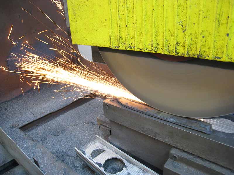

Here is a cool shot of the surface grinder sparks.
This is my 1958 Covel Surface Grinder made in Benton Harbor, MI. It is accurate to 0.001 in 6 inches and it has a 6" X 18" magnetic chuck. I love it
Here is the blade surface ground, ready for profiling. The blade is 0.280 thick which is about 0.005 thinner that I wanted it. However I think the weight will still be very good because 0.005 is not very much.
