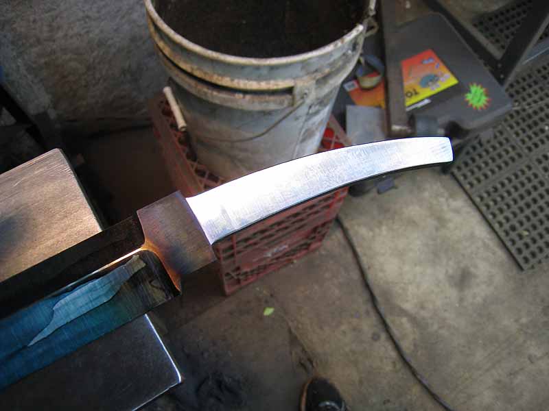

Here I have started further surface grinding the tang. You can see that the tang is 0.240 thick where the guard and spacers will go and 0.225 after that. Next I'll turn the blade 90 degrees and surface grind the rest of the tang down to 0.225 thick.
I am starting to grind the rest of the tang down to to the thickness of the area I am pointing at with the brass rod.
Grinding.
Grinding...
Ground......

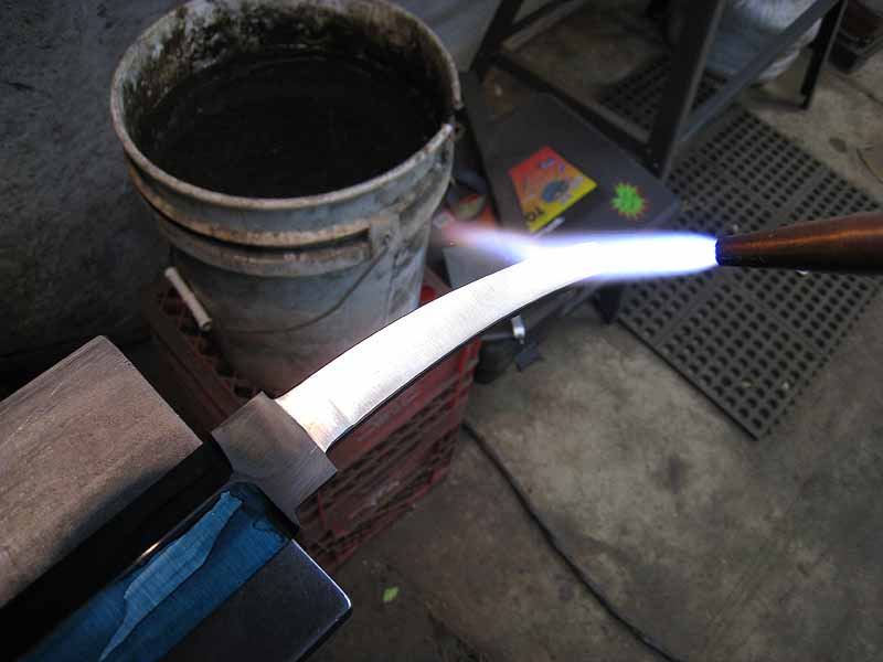

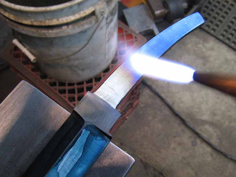

Now I have the blade edge in water and I'm heating the spine up will my torch to soften it and make it tougher.
Here you can see the area I heated to soften it.

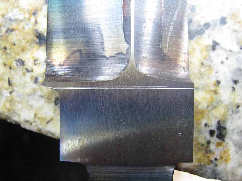

I put layout fluid on the blade and ground the ricasso up to 220 grit.

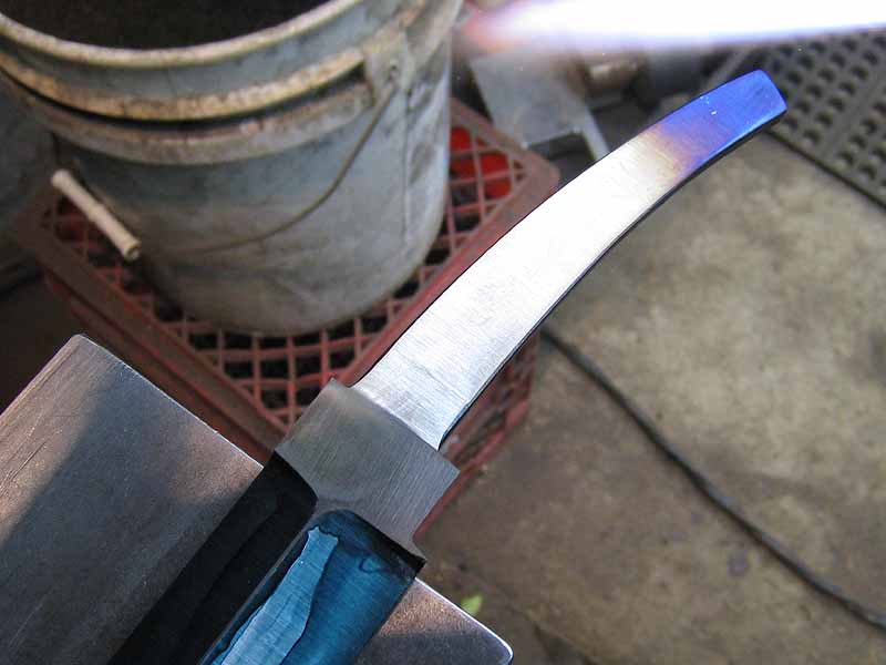

I am running another softening cycle on the tang here. I want to run a gray color into the ricasso close to the blade edge.
Here the color has started on the end of the tang.
Though you can't see it very well in this picture, the tang and ricasso are a blue/gray color.

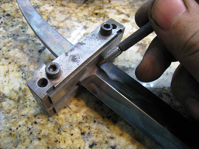

Here I have placed my carbide filing jig onto the ricasso so I can scribe a line on both sides and have them be aliened perfectly.
Now I have good lines to grind up to later on both sides of my ricasso.

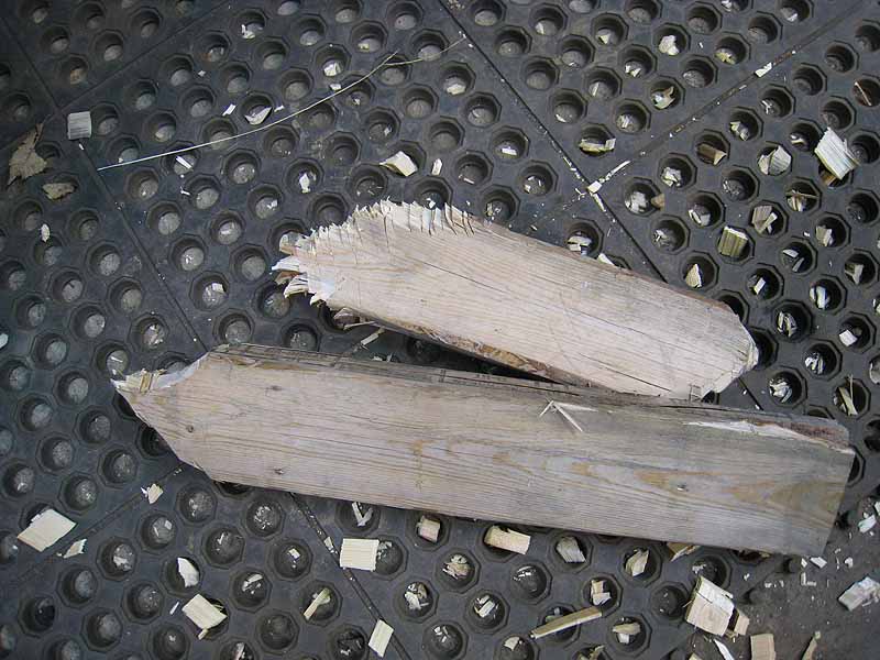

Time for some performance testing. I will start out by chopping through a 2 X 4 and be able to shave hair after I'm done. It chopped nicely and stayed sharp.

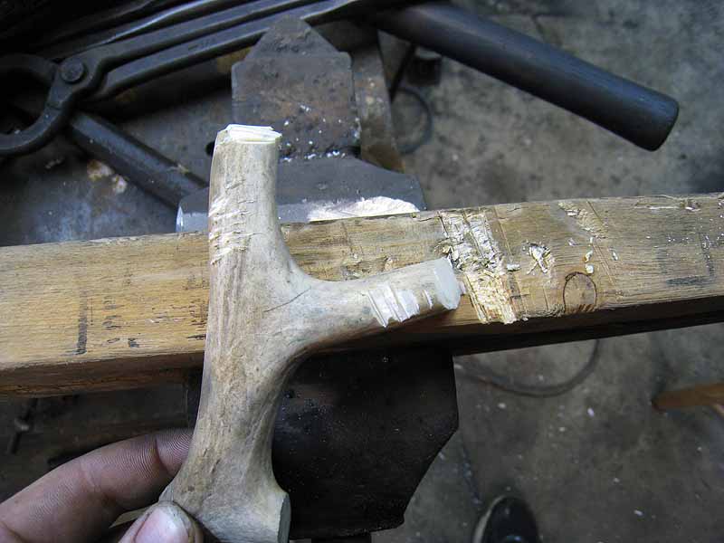

Next I chopped through this piece of old deer antler a few times. My goal for the blade on this test is for it to stay moderately sharp but not sharp enough to shave, which it did what I wanted. Wow! That was some old hard antler.
