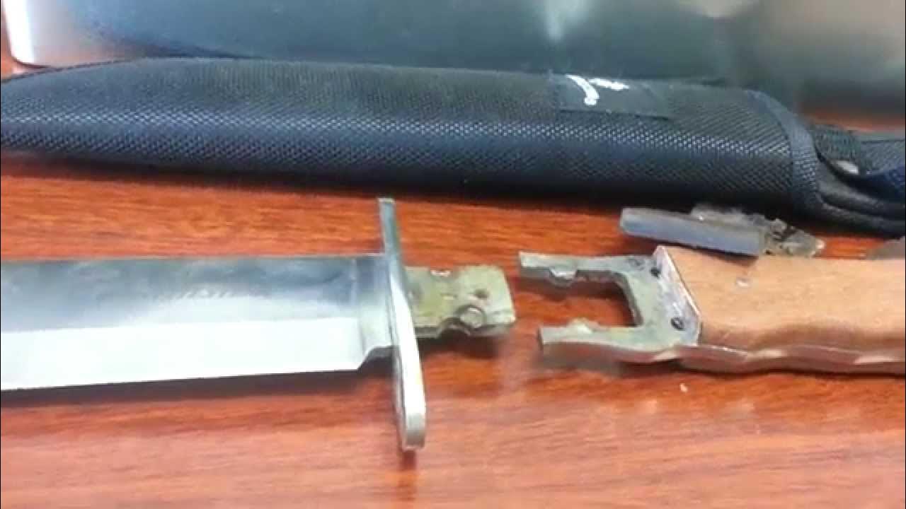

And as long as we're on this topic, here's another version of a "fake full tang". This was actually my knife, I bought it on a whim for $20. Not surprisingly it turned out to be a piece of junk. So I broke off the handle to confirm my suspicions about the tang construction. The spine of the blade goes straight back into the top portion of the tang. So along the top it looked like a real full tang. The welded on piece holds the guard in place.
