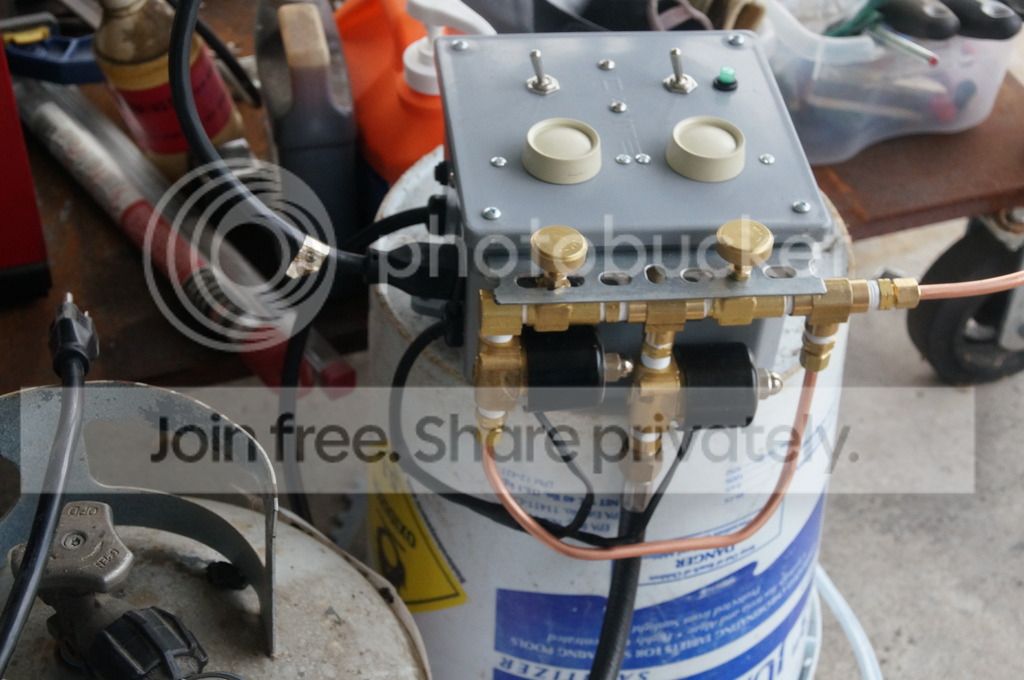

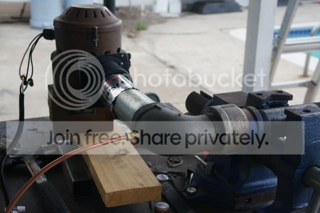

Finished building the burner control and test fired last night! Too much air volume and not enough gas (regulator hasn't arrived yet, so used the one off the BBQ), but got it burning on both idle and heat settings. It needed to be set at the very lower limit of the blower speed, near the point it would cut out, so played with a makeshift baffle for the test. Making up a proper baffle plate this morning. (note the Asahi beer can baffle!)
Pretty happy with how the controller worker out. Pretty neat and compact. Just built for manual for now, and will rebuild with the PID once I get the forge body done and happy with the performance.
Thanks Stacy, all of your information made it a lot easier.
Made up the baffle for the blower, but still seem to have too much air. Added a vane inside the tube to break up the air, but still not much better. It will fire with a lean flame, with the minimal amour of air flow, but as soon as I get the air flow a little higher, it blows out the flame. Had a nice even flame at one point when baffling the blower totally with the palm of my hand, but it was very touchy, and blew out easily.
The lean flame suggests it will take more air, but I suspect the problem is not enough gas pressure from the BBQ regulator for the size of the burner.
I think the only option now is to wait till the new regulator arrives in Thursday!
Just a quick update... the new regulator made a huge difference! added a 2" tee with a baffle plate to act as a waste gate, which makes it easy to light, and a 2" gate valve to regulate the air on the pressure side (the baffle on the air intake just wasn't cutting it). Much better control now, and I can run the fan at a higher speed so it doesn't sit right on the edge of the cutoff when fine tuning the speed control.

My burner was a little hard to keep lit when it was in the vice, But after it was in the forge it worked great, I think all it needed was a little back pressure
