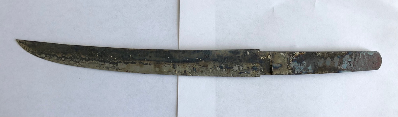

Well, no bueno.
I did an uninterrupted quench, water at 75F.
I’m pretty sure I felt a ping, didn’t hear it, but felt it through the tangs. When I removed the blade it had a nice sori, was in one piece, however it took a lateral bend.
I did the usual, clamping the blade against the bend and was waiting to start a tempering cycle, than about 5 min in, the blade just snapped in half, sitting on the table.
Should have done an interrupted quench and now I see, the water was a little too cold as well. Also, should have moved to the tempering cycle faster, but I don’t think it would have matter, since the blade was probably compromised by a fissure anyway.

And here is a pic of the resulted sori. Of course, useless since the blade didn't survived, but just wanted to share. I never expected to curve this much. Well, hopefully next one will survive.
