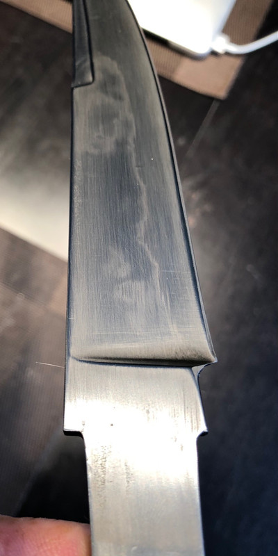

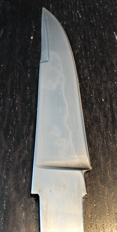

Hi again,

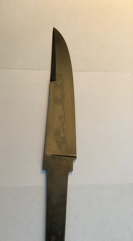

Just wanted to close the loop and mention that following your advice I have successfully quenched a 1095 test/sacrificial blade in brine. AWSOME!!!
I followed Stacy E. Apelt - Bladesmith Stacy E. Apelt - Bladesmith recommendation and went with a 7% brine and did an interrupted quench. I also finished the quench in canola oil, don’t know if that kept the blade from shattering, but I thought, may as well go with it and see what happens. After that, tempered at 400F, twice for 2 hours. And I’m talking right away, say 2 min the most, after the quench, as instructed.
The next day, I put the blade in acid for a few minutes, just to see if I can see a hamon. Please see below, but it looks to me that whatever that activity is, it followed the clay pretty close, I say 1/8” inside of the clay line.
Other thing to mention, I went with 1440F for the aus temp and soaked for about 15 min, instead of recomended 1475F. Just to keep the quench less violent, or at least that was my reasoning/understanding from reading other posts.
Also, the brine was at 120F and oil at 130F.
The quench even gave the blade a sori. This is a short blade, 6.2” from ricasso, but i think this happened because of the distal taper and the false edge on the spine, a few inches from the tip.
Here are some pics, please let me know if you think that is a hamon, I think it is, but just in case. It follows the same pattern on both side of the blade. IT HAS TO BE...
Thanks again guys, you helped me end up with a one piece blade after a brine quench, and hopefully my first hamon, I’m elated!!!
Constantin

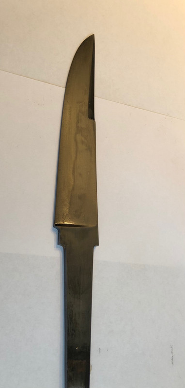

Nice, please update once you invest some hours polishing and etching.
Thank. Not in this blade. It was just for testing so I can get an idea of the hamon and if I can still have a blade after quench. I plan to test the edge and see how that feels, since I went lower than 1475F.
I will probably try a few test coupons to get a good idea of what hardness I get at what temps.
I have a tanto next and if it survives, I plan to finish the blade and bring out the hamon. I will definitely create a post to show it.
Excellent results. I'd polish the blade out a bit to see what else shows up in the hamon.
The lower austenitization temp you did keeps the available carbon lower and helps the steel act more like a true eutectoid. This will increase hamon activity and lessen cracking.
Thanks again Stacy E. Apelt - Bladesmith Stacy E. Apelt - Bladesmith .

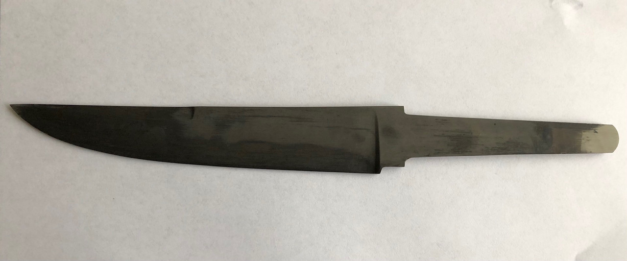

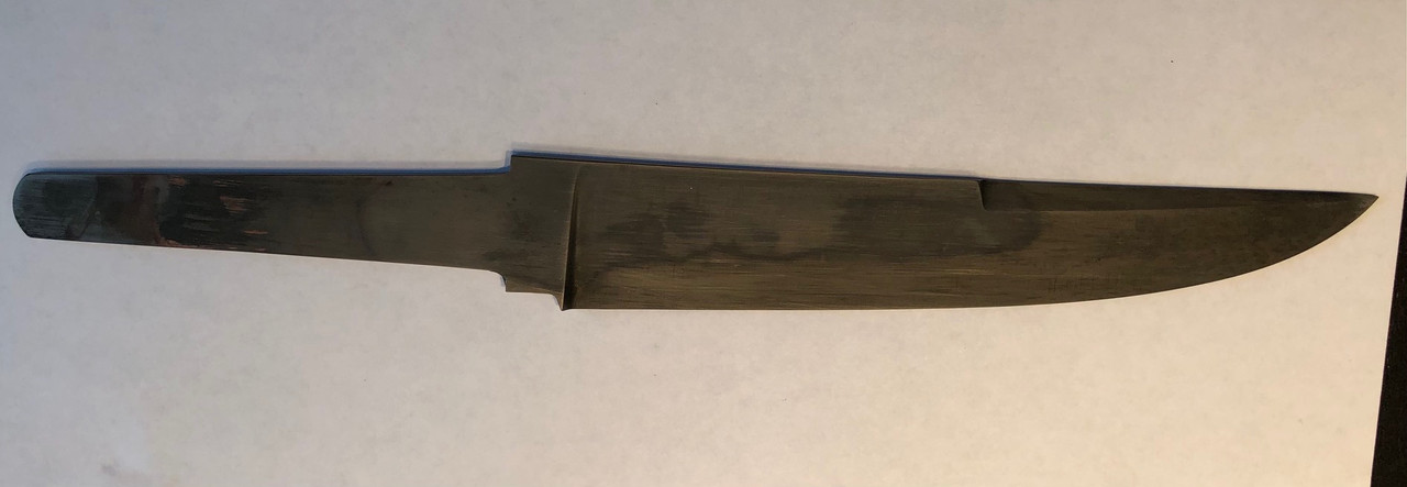

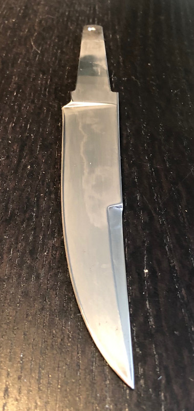

OK, I “polished" the blade a bit, 320grit and etched in acid. I don’t plan to finish the blade, it was just a test to see if it would survive in the quench and get an idea of the hamon.
Also, my next step is to learn about clay application and polishing. I bought Walter Sorrell’s videos and will watch them in preparation for the next blade.
Here are a few more pics.

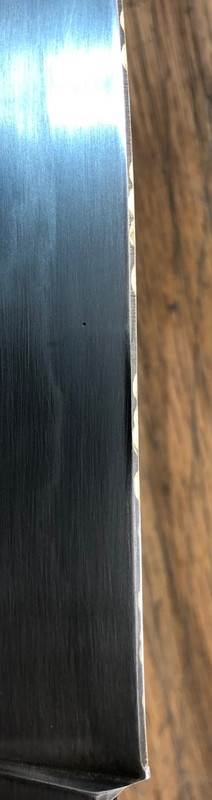

And after conducting some destructive tests on the blade, here are some pics.
Here I smashed that edge against a brass rod. As you can see, no chips or rolls.
Here, it bent this much after snapping.
So I guess in conclusion, it tested well. What do you think?
