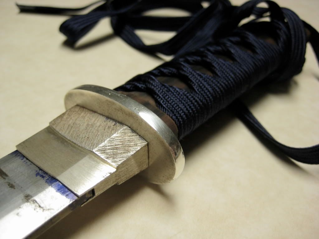

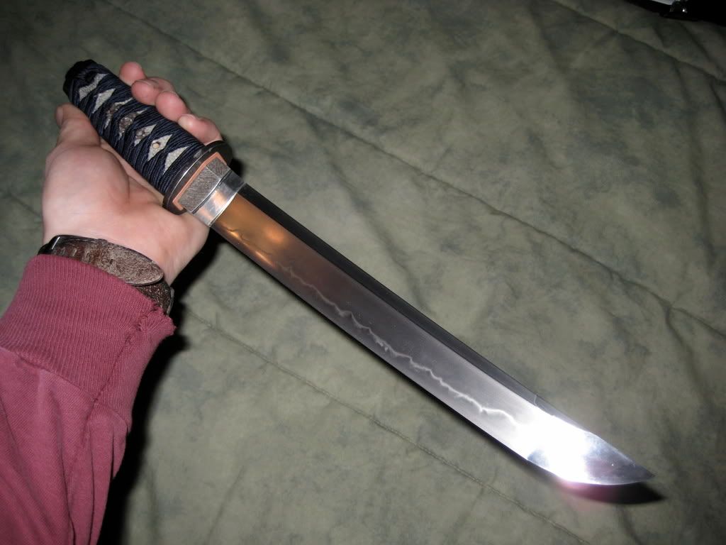

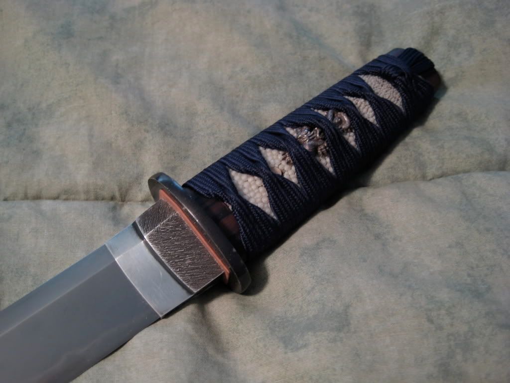

hey yall.
been REALLLLLLLY busy... but here is something that i finally finished. It has been almost a year. This was made on commission, and was an evolution of design. started out as a american tanto (i had made one for the same guy before) then a habaki was added.. still with a wrapped handle, then what about a tsuba? oh what the heck..why not.. (the customer is never wrong) then why not through a real handle on there.. and oh by the way the habaki the tsuba and menuki need to be silver... so this is the result!
forged W2 blade
cast and antiqued sterling silver habaki, menuki, and tsuba.
copper seppa
madegascar ebony tsuka
silk ito
comments would be VERY welcome. and it might be up for sale. the guy who ordered it has dropped off the face of the planet.
thanks for looking!
~Chris

ALMOST everything looks great on it.
The same' is not premium and those open spaces between the nodes really detract from the overall picture.
A ridged or rounded spine is practically de rigeur, for both practical and aesthetic concerns.

I'd echo STeven's comments. While historical examples exist for the kaku-mune you've used, I've never seen one face-to-face. :D
That's a very nicely done habaki, but I myself prefer one that is traditionally constructed.
Even so, I'd be proud to wear that in my obi!
