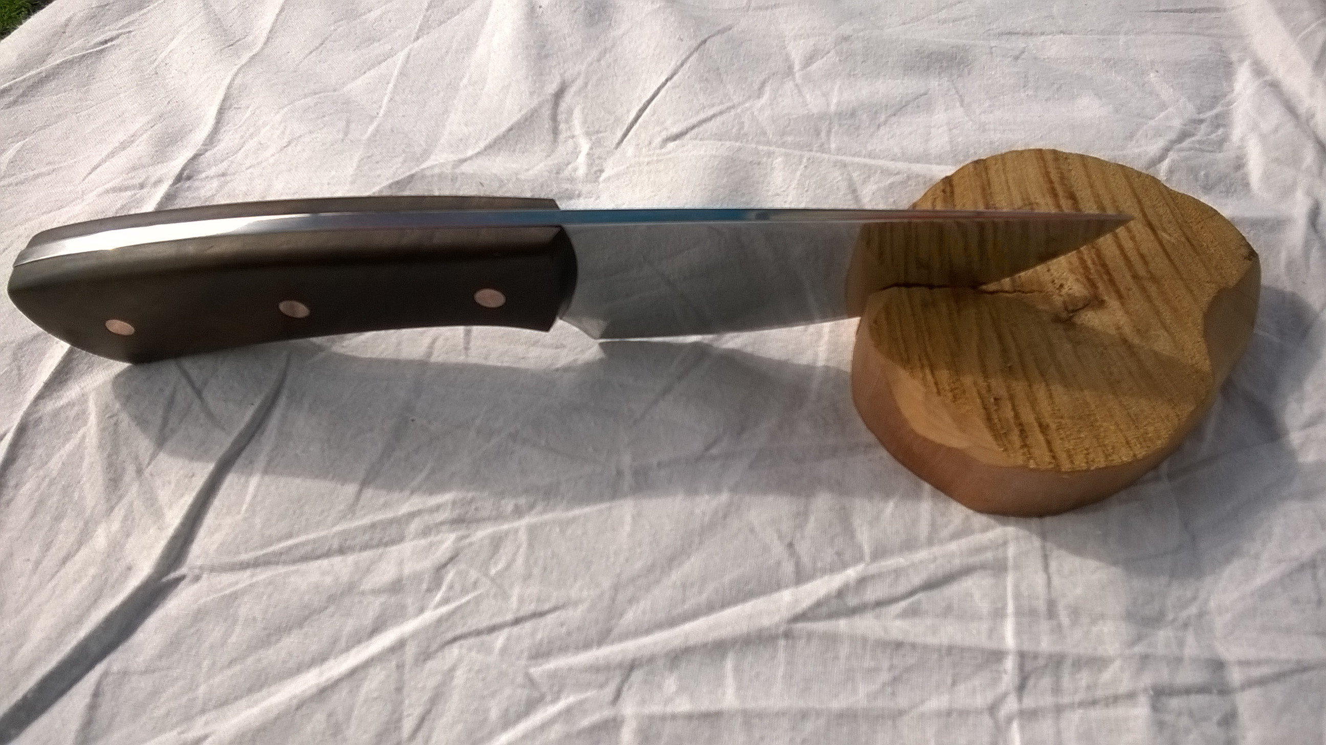

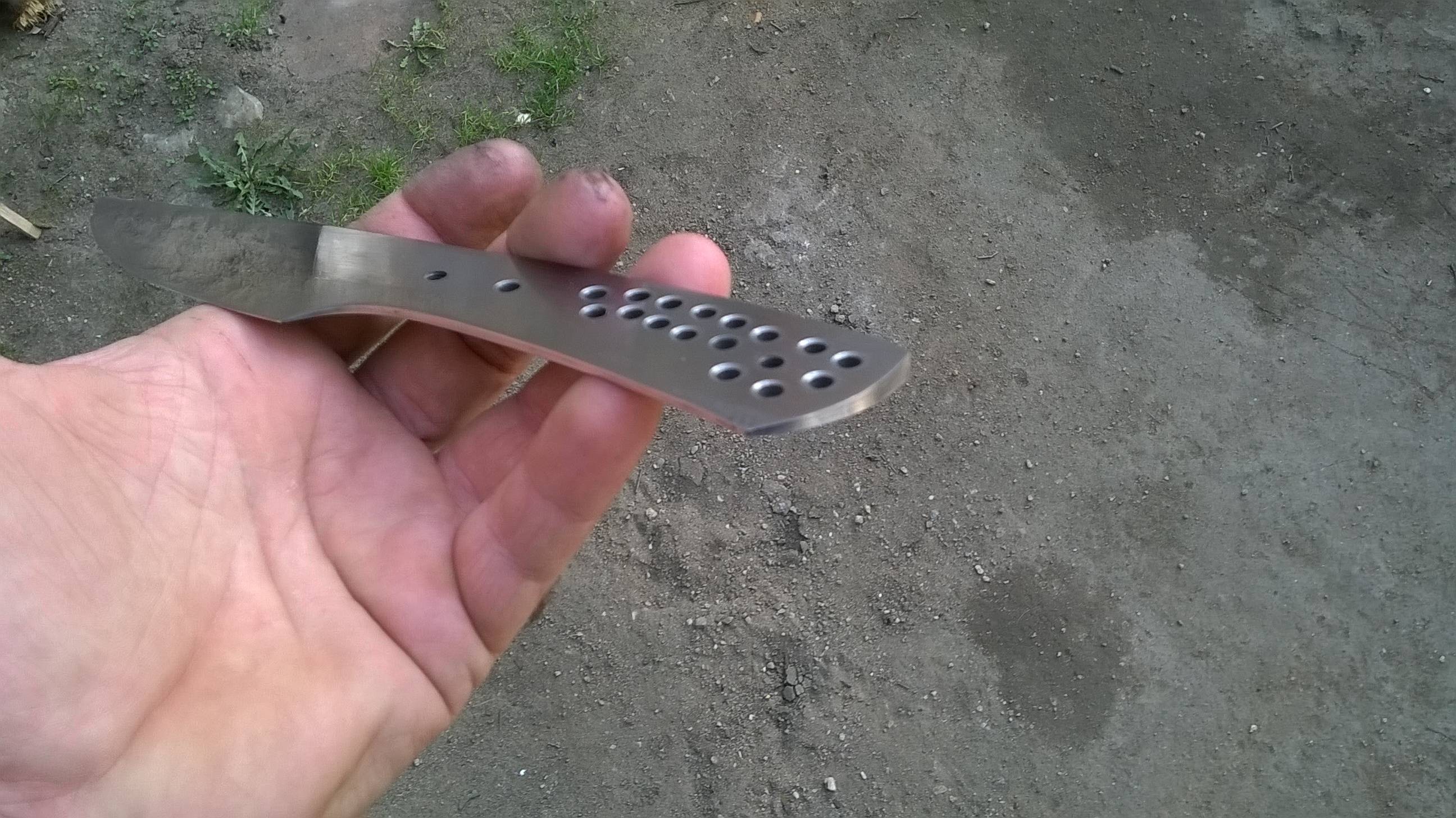

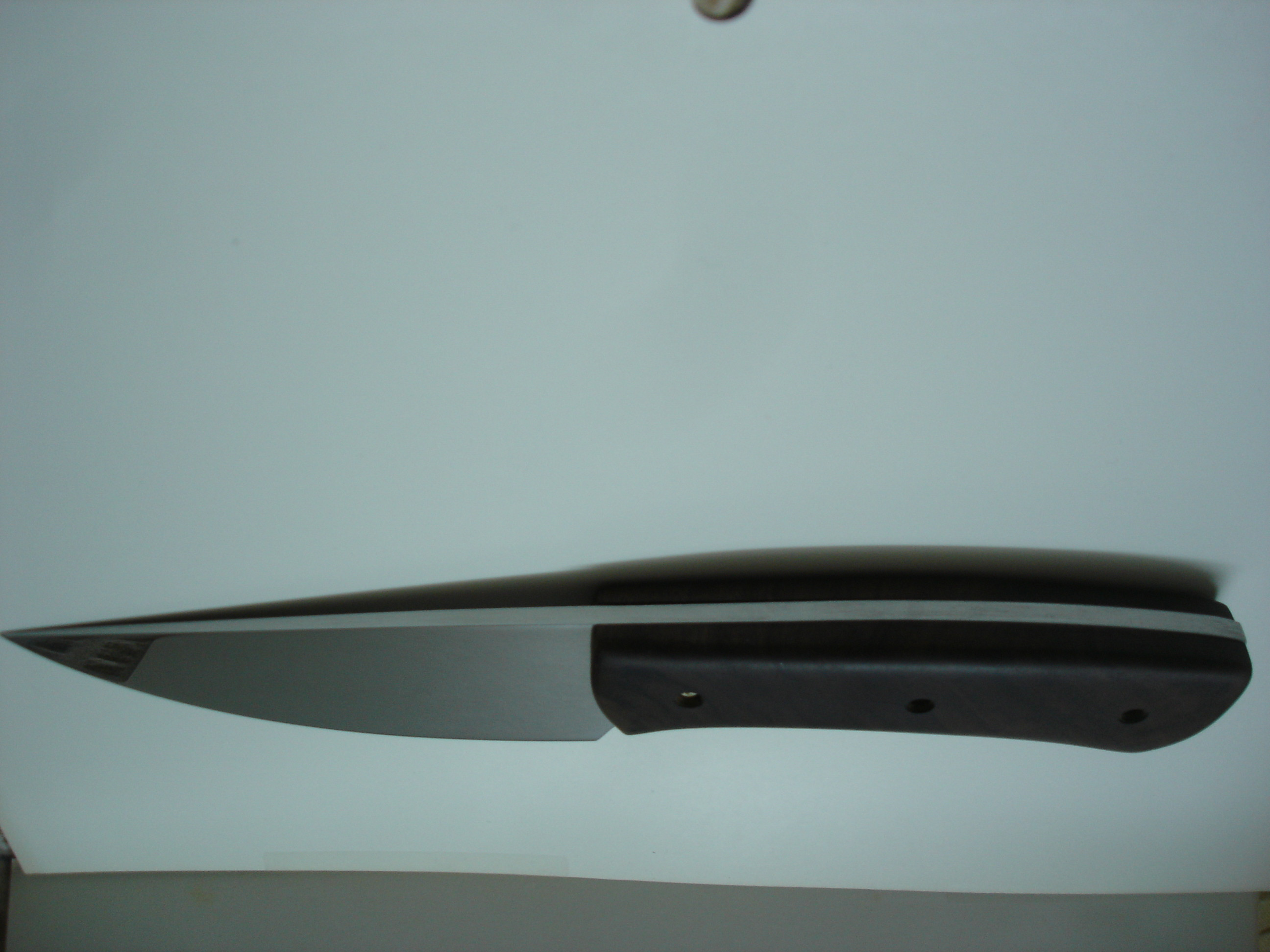

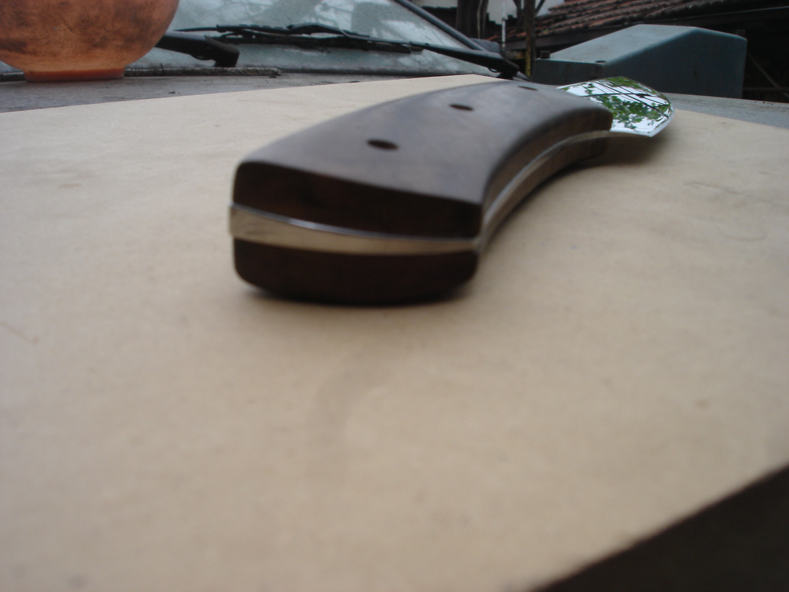

Maybe you would like knive tapered this way for beater blades ........Distal taper , plunge less /main blade bevel contiune to the end oF tang/ 5mm spine , 22.5 cm. total lenght and ONLY 185 grams weight .

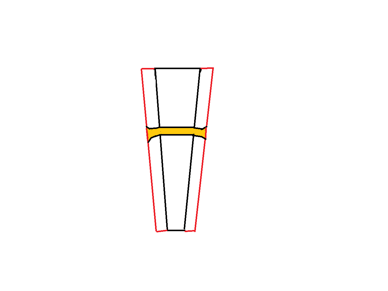

That's why I cheated a little ..... I drilled hole in scale when tang was still flat and used coper pins which I pinned .Coper is soft and bend inside
as it should ;)
Most likely it looks like this now , yellow is pin . . . .
That's a good way to cheat. Personally I do drill before tapering. But after that I have to drill the scales at an angle so that I can get a nice pin through it.
