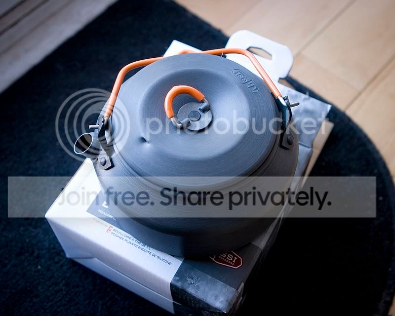

I can almost just get away with a metal cup. But, I came across this cool kettle, and figured I would give it a try this year.

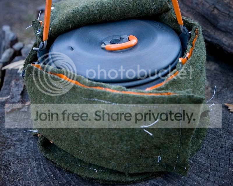

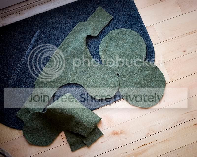

There is a lot of "clean up" I need to do on it.

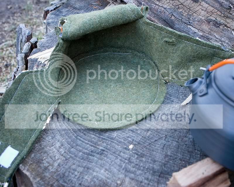

I used two pieces of US issue wool blanket.

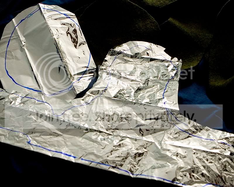

In the middle, I put an old space blanket.
You see the space blanket poking out in some of the pictures because I cut it oversize to make sewing easier, then figured I would cut it back. I only hurriedly cut it, so now I need to take some time on it.

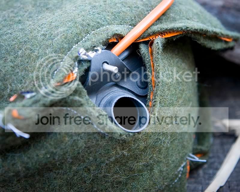

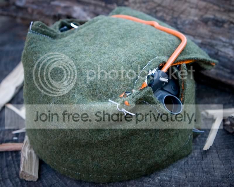

Since the pot will be HOT, I didn't want it folding up. In order to put it in the cozy one handed, I made flaps.
So far, it works out well. I ran a little "test" the other night. While it was done at room temperature, at least it was ONE data point. I heated water to boiling, then stuck it in the cozy.
Now, a HOT drink is probably around 170F. A pretty good temp is probably more like 160F. After 40 minutes in the cozy, my water was still at 190F. I was tired and went to bed, and did not continue beyond that.
Now, I just need to try it in the field.
