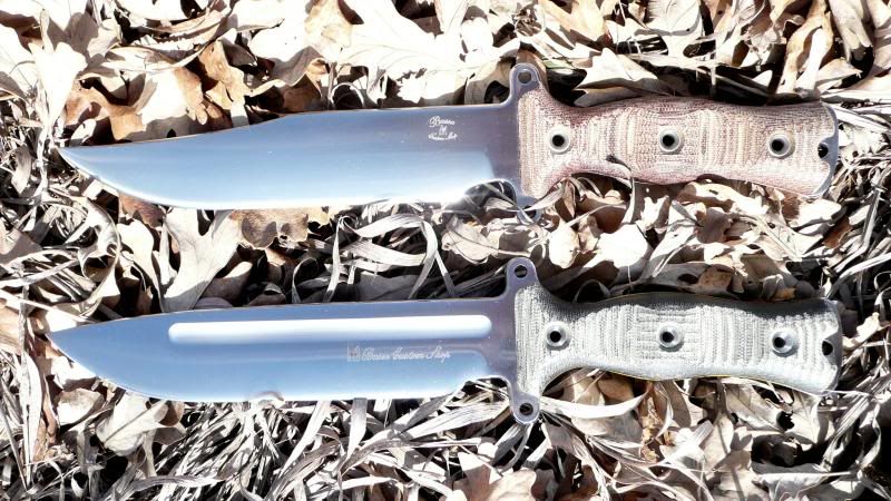

I thought I would share some thoughts on this design, feel free to share yours. If I don't get one of the new Light Brigade versions, it will only be because I already have one and am saving up for Blade. If I didn't have one already, I would be all over this offering. It is a design that doesn't really shine until you have spent some time with it. Thinking about it without it in your hands or guessing by comparing it to others mentally won't put your mind in the right place for it because your eyes deceive you with the thought it is just too different to work. Jerry has been at this long enough to have worked out most of the potential flaws in this design and it is very impressive.
This is the closest thing to an TG LE that has been offered and I really like it.
You can never go wrong with linen micarta, in this case tigerhide linen, it is my favorite material in hand after res-c. Oh, and my little rant after watching/searching the exchange is canvas is NOT linen :rolleyes: though some don't know the difference, but if your bed sheets were made of canvas instead of linen you sure would. :p Canvas is ARMY tent material with a rough highly visible texture to it you can go feel at a surplus store. Linen is like your cotton bed sheets in look & texture, much finer, and yes you can feel the difference in your bare hand. Canvas is a close second if linen is not an option though I love the look of bruisers and pumpkins. ;) If you are going to buy a non LB version, micarta is lighter, but on the LB, I suspect the added G10 weight won't be as noticeable in hand.
This is not a light brigade version and it weighs 19.3 oz, so a 1/3 lb or 5.3 oz reduction would be very sweet for carrying on a belt all day.
If you have tried a SAR 4/6/8 and wished for magnum handles, or you want an NMSFNO type blade design without a skull crusher this may be the blade for you. The LBTG is pretty much the equivalent of the SARGE 7 with double guards, a fuller and magnum handles at a much lower price point, micarta for micarta, but that is only because it is a CG not offered in satin. If you don't like the guards, you can mod them off like Al-sheik did, hopefully he will post pics of his in this thread. The top guard really doesn't affect any part of function the way you might think it would, but if you focus on it too much you might give yourself the same mental itch when you think of lice... no real problem, but it still bothers you.
:D The bottom guard could get in the way if you were trying to cut with the flat of the blade on a flat surface like a cutting board. This is not unique to the TG and is more of a talon hole related issue you will find on most all Busse designs other than the Muk or SAR 5. You overcome the talon hole issue simply by cutting with the talon hole overhanging the edge of your flat surface and surprise, surprise, problem solved. You can see my SAR 6/DSF grips for comparison from last year here.

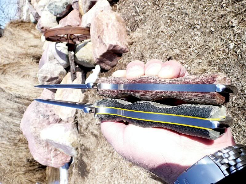

Grip options on the TG... ok, here you go, with pics. The guards require slightly different, wrapping of you your hands, but honestly provides a wider range of grips than all of the other Busse designs I have tried. It is different, and it may even be better, but only time and use will determine that on an individual basis.
These grips are all very comfortable despite the guards.

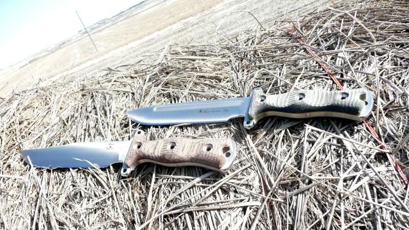

Of course I have to include a comparison pic of other options in this range.
For those of you who want a sweet 7" blade currently offered at factory pricing in res-c without the guards at a fraction of the cost... the 711 from SYCKO which is basically an improved remake of the Camp Tramp, is the way to go without breaking the bank. SR101, Res-c and a sweet design at less than half the cost can't be beat for a user. Or, get both! :D

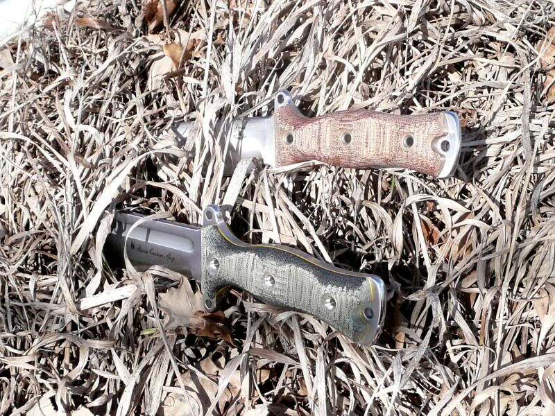

Removing just the talon holes won't expose the any of those gaps at all. If anyone's having trouble determining what can and can't be removed, look at it this way: The gaps are only under the handles, so don't remove any of the handle material. I estimate the walls of that "I-beam" treatment to be about 1/6" thick, referencing Jerry's pictures (rivet holes are 0.25", and the walls are about 1/3 of that), and it looks like the wall outlines the whole perimeter of the handles. It's possible that's not true, but then again, that wouldn't make any sense at all because it'd create a lot of weakness from lack of support under the handles.

Thanks for the comments & thoughts everyone, keep em coming. The other thought I have is whether or not the hollow grind appeals to me. I think the hogged out handle is sweet, but maybe just a flat grind up to the fuller would work best for me. The full flat on my FBM LE is great for chopping & splitting yet easy to remove on the rare occasions that it sticks. How well would the shallow hollow grind actually work for chopping/splitting functions?
The TG's that Al-Sheikh and I have are like the one on the left, the new ones are like on the right... what about splitting the difference or is it going to be sweet as is? What do you think?
