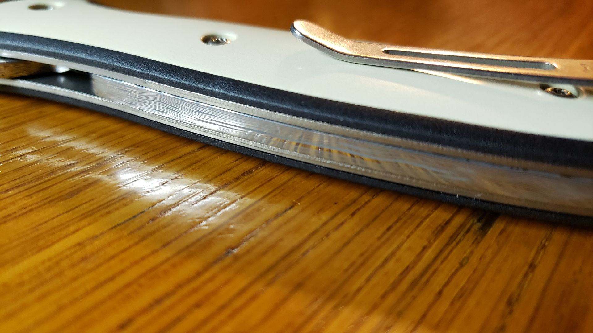

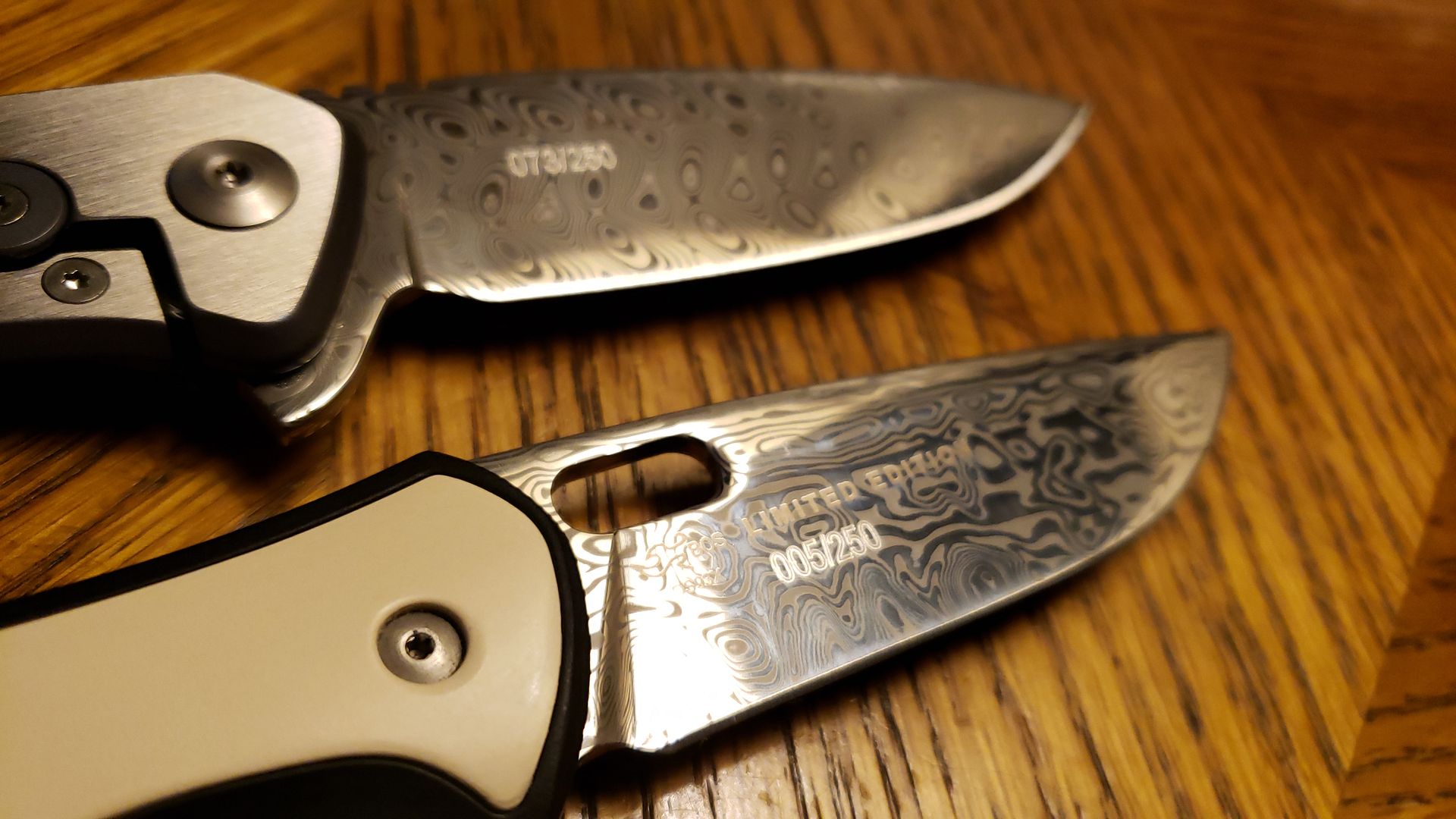

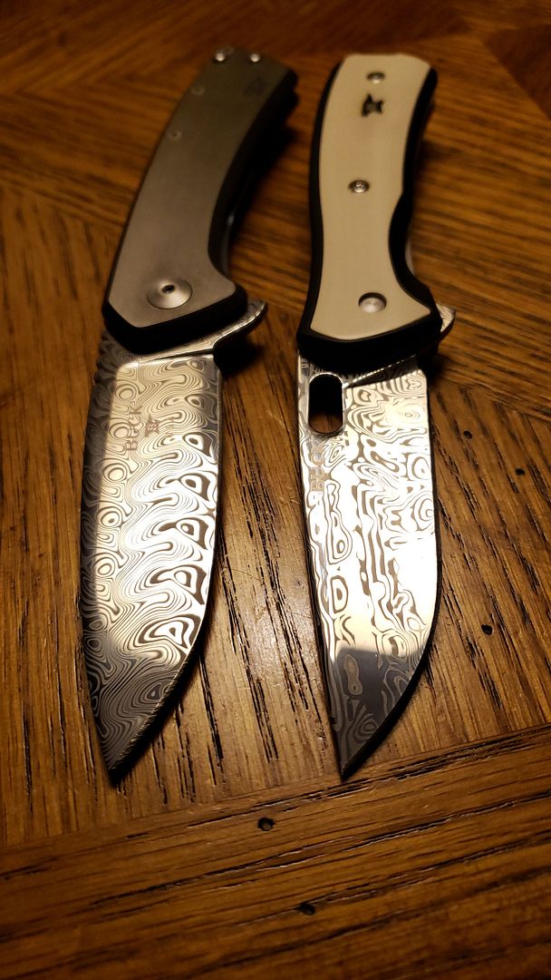

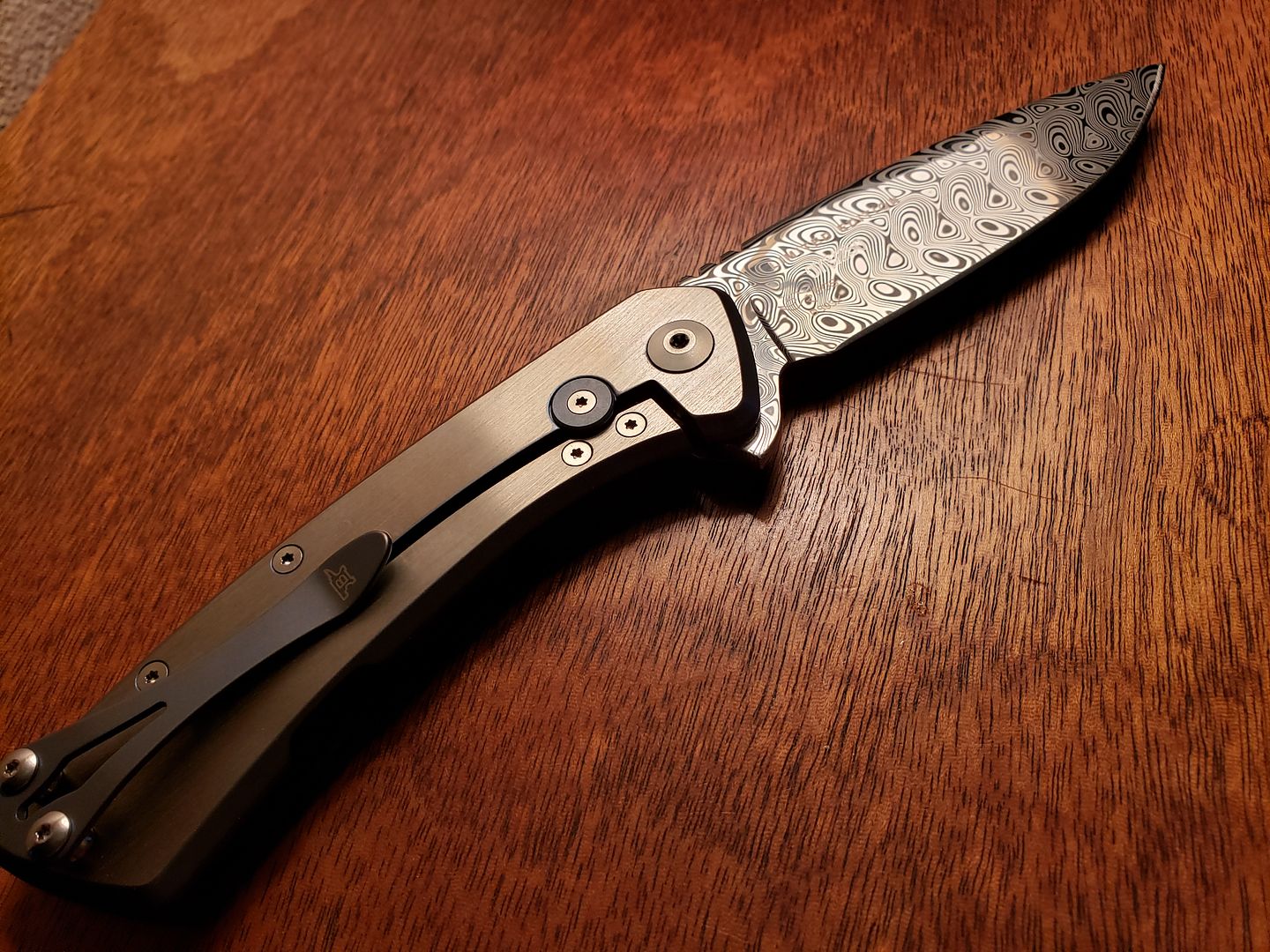

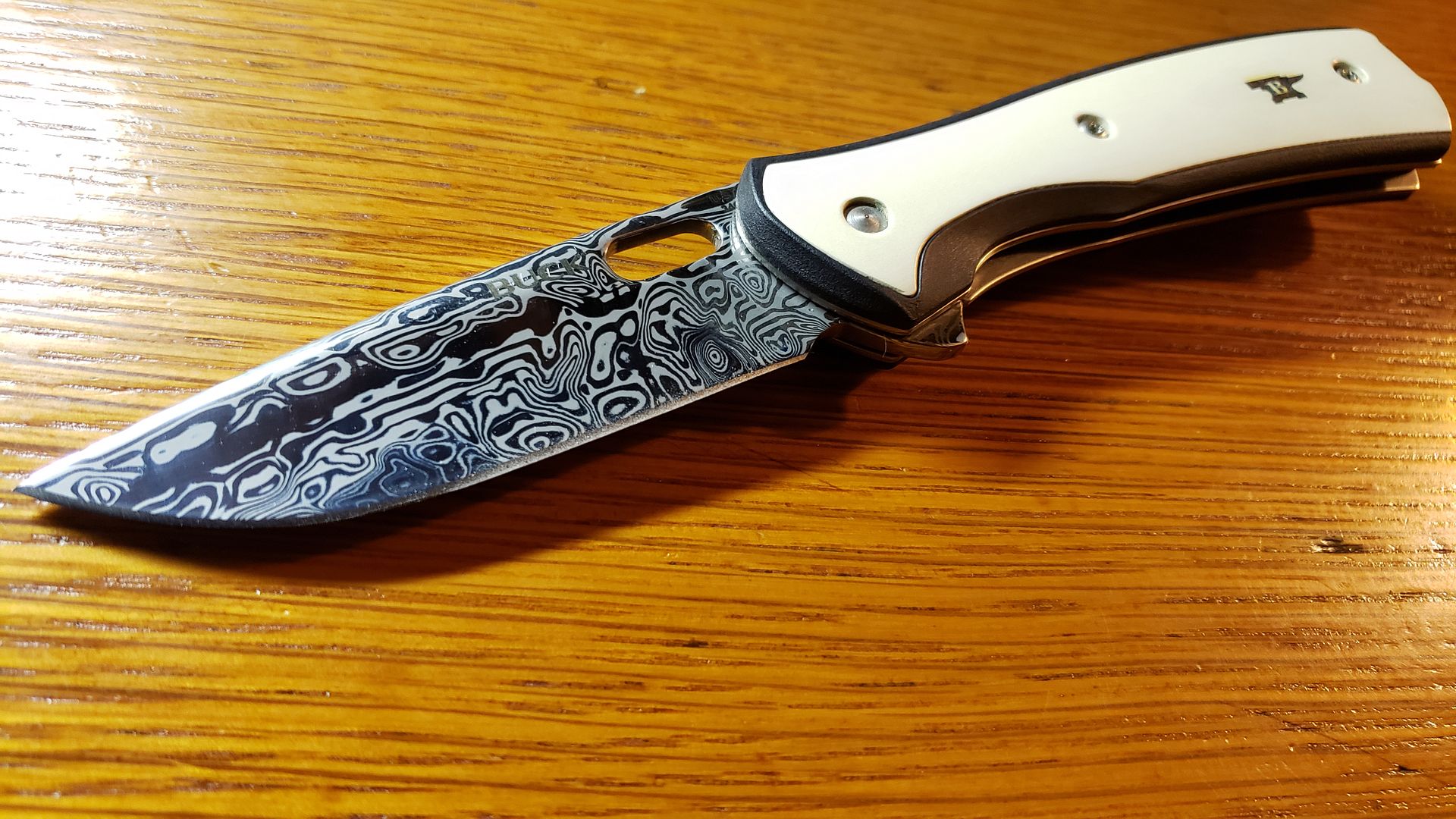

From what I understand, Damasteel is the user's version of damascus. RWL-34 and some other low carbon, high chromium powder steel turned... into more powder? And then that makes Damasteel? I don't entirely understand the process... but I've read it is VERY similar to CPM-154 in this form? I just aquired my first Damasteel folder (Reate J.A.C.K.) and I would like to learn. I don't actually plan on using it. I'm just curious. I've found a couple other threads, but they aren't super informative.

Negative. The pattern is enhanced when etched, but grinding through the layers reveals them. My wife's Rike Hummingbird has a visible pattern with no etching...perfectly smooth Damasteel.

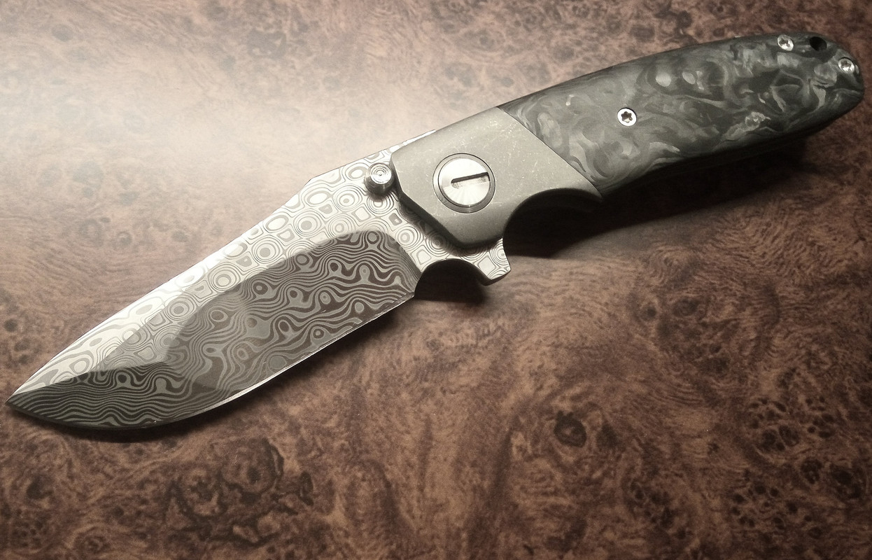

I have used Damasteel many times to make knives. I do not know how their steel is made but I can say that it makes excellent knives that excel at slicing. Sharpness is a relative thing and certainly hard to define but I think some of the sharpest "feeling" knives I have ever made are out of Damasteel or Devin Thomas's stainless damascus.

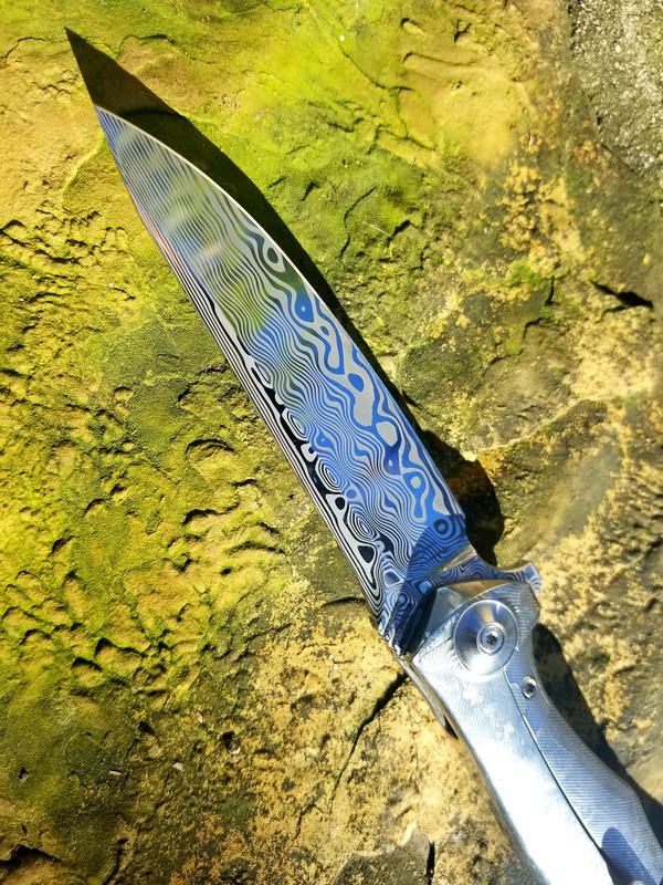

Like WValtakis states there often is no topography on Damasteel. This is true with other stainless damascus steels I've used as well. They simply etch differently than high carbon damascus. Even with high carbon you often will etch 2, 3 or more times to get topography and this can be done with stainless dammys as well.

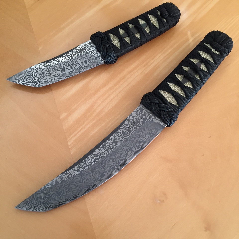

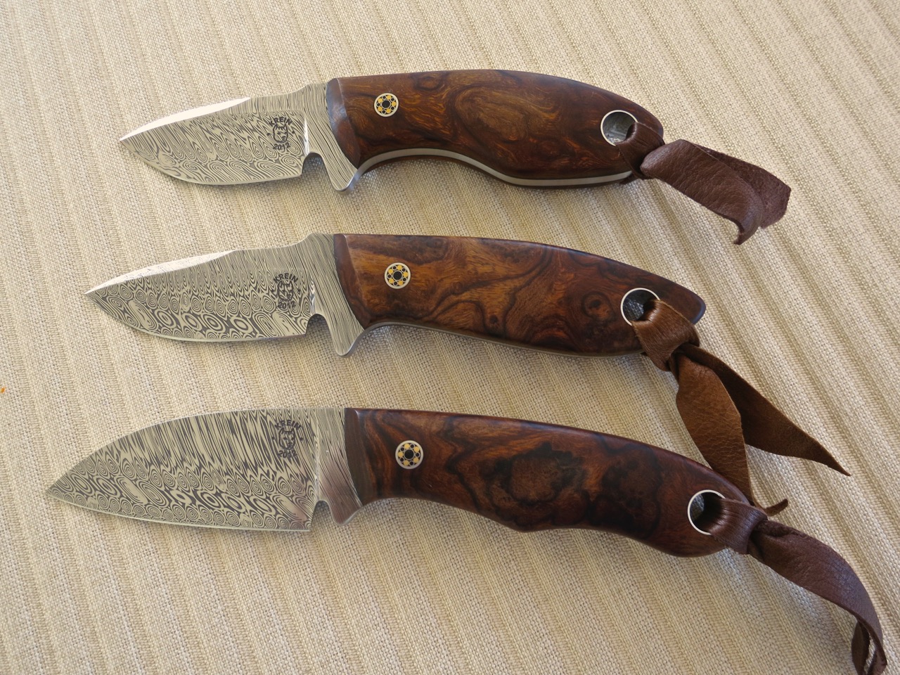

Damasteel Sonoran Camp Knife:
Damasteel Poco:
Damasteel El Toros:
None of these had topography but all have certainly been etched.
Damasteel engraved Rodeo:
This one did have some topography.
