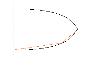

I have thought about how to describe the sharpening angle on a convex edge. It is difficult and it must be easy to understand and communicate.
It would be nice if its also is easy to measure for all of us
A convex edge is a curve. Many of us cannot measure the sharpening angle on a straight edge properly and that is much easier to do then a convex edge.
Suggestion:
10/13-5 is a description on a convex edge. It starts from 10 degrees and stops in 13 degrees and the edge is 5 mm long. We get the starting point, the end, and the distance. With those numbers can we, if we like to, draw the curve on a paper.
If I make a steeper convex edge, lets say 10/15-5, the edge can also be described and we can communicate the convex curve, and we also all can understand the difference in the performance of the edge. 10/13-3 says also something about the edge or?
This means that when some of us shall by a knife with a convex edge, we can ask what sharpening angle the knife has, before we by it. It is good information to have and it tells a lot about the performance of the knife.
If we accept this try to describe a convex edge, or if we can find some other way to do it, is not important, the important is that convex edges needs to get a description of the curve so we can communicate about it -based on facts.
After that, we can talk about how to sharpen convex edges - because it first then we really can talk about it. If we not even can describe the angle of a convex edge how can we say that this or that way is the right way to do it?
