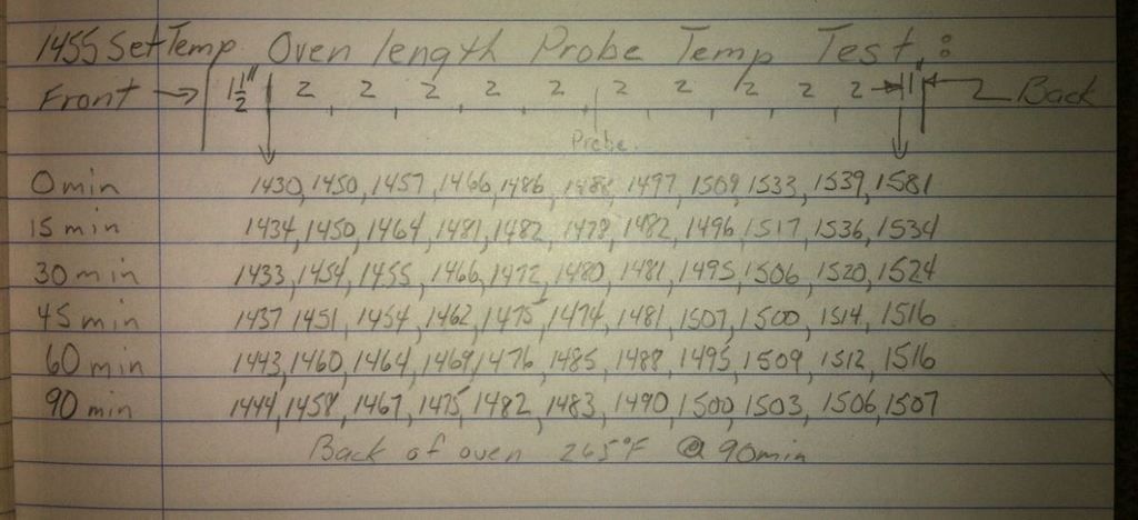

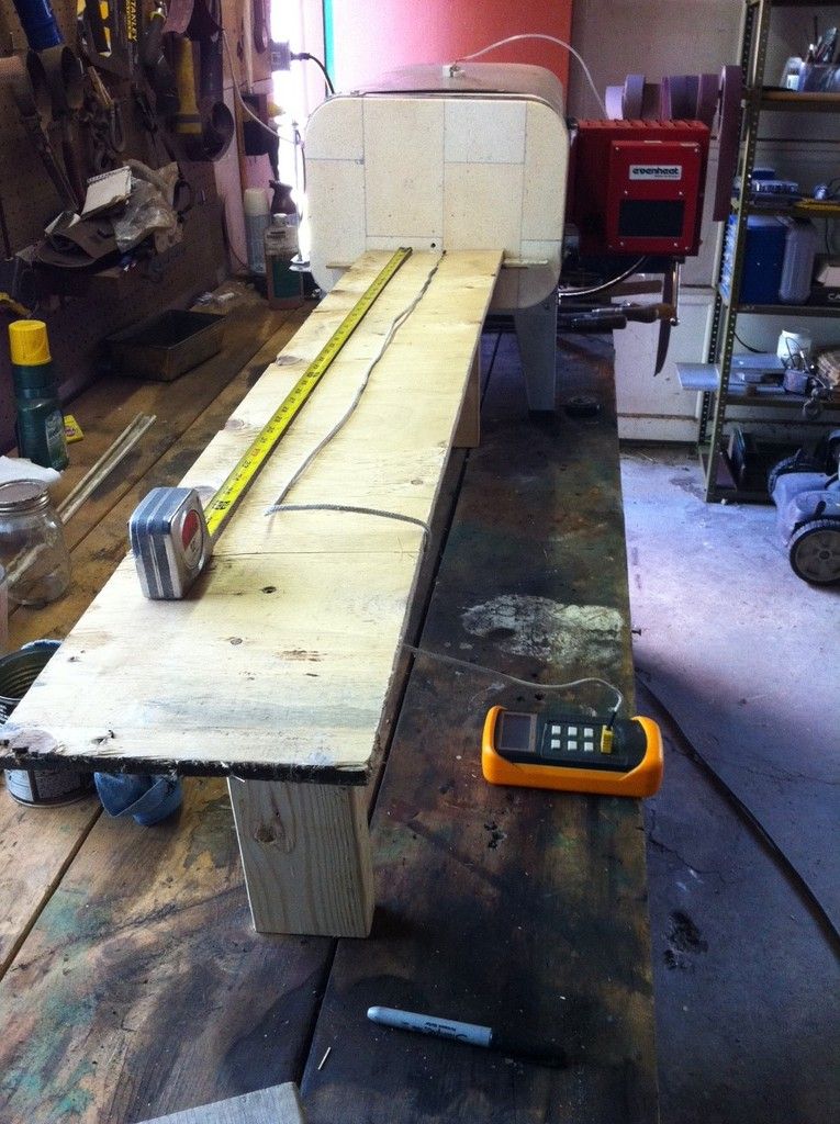

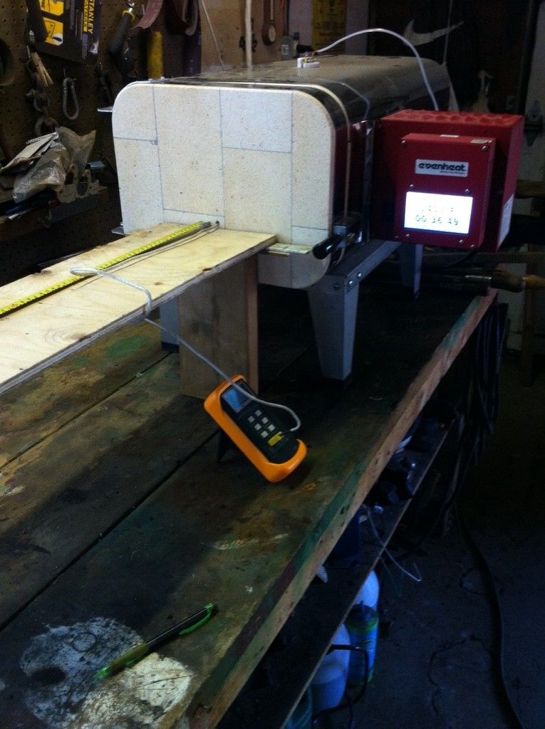

I drilled a quarter inch hole in the front door of my oven to accommodate my probe to test the full-length of my oven for temperature variation today. And Don Hanson was absolutely correct the brick was extremely soft and it was like drilling through chalk.
I set up a ramp so that I could pull the probe in and out easily and keep it on the bottom of the oven and in the middle. I started 1 inch from the very back of the oven and pulled it out in two inches intervals waiting 30 seconds between each moved to let the probe acclimate. The last temperature reading was 1 ½ inches from the front of the oven. I did tests as soon as my target temperature of 1455°F was reached and then after 15 minutes, 30 minutes, 45 minutes, 60 minutes and 90 minutes.
By the way the probe I was using cannot be calibrated so I didn’t worry about the actual temperature instead was only concerned with change in temperature over the distance of the oven because later on I can figure out what temperatures I actually have to shoot for with W-2 with actual test pieces.

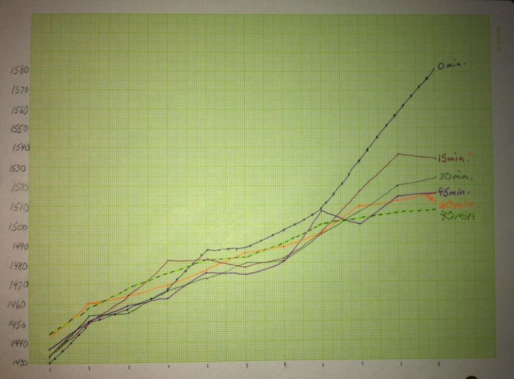

Here are my results and below that I made a graph for more clarity.
I really expected the temperature to even out much more than it did over time. The most even heat was after 90 minutes in the back of the oven where the temperature only varied 7°F over 6 inches. Perhaps if I were to let it heat up for three hours I might get an even longer and more even section back there but it seems like such a waste of energy.
I was really hoping the middle section of the oven would even out over time but it never really did significantly. The blue line with dots on it is the one that I did immediately upon reaching my set temperature and the green line with the dashes on it is my last reading at 90 minutes and if you look at the center section they are almost parallel which is a real disappointment and shows soaking doesn’t really even things out. Even with 90 minutes soaking the middle 8 inches of the furnace still had 25°F variation. From previous tests it seems like that kind of variation would have around two point hardness difference.
Looking at my chart I believe I wrote down the wrong number for my 45 minute line for the fourth to last number because it takes an odd rise.
Probably in practical applications one wouldn’t even notice that but it is sad that the most popular brand of oven is so poorly designed. If this oven just had heating elements on the two sides instead of also on the backside the middle would be the sweet spot and the heat would fall off evenly in both directions so you could position your blade accordingly and with a long soak it would probably be very even quite a ways out from the center.
I will definitely be doing the same experiment using the fire brick in the back to block the rear wall element and hopefully that will give me a more even heat even though I suspect eventually it will burn out my element. I have to work next week so I don’t know if I will do that tomorrow or not because I might be too busy.

Thanks Randomus but actually I didn't need a peep hole just a hole to allow my temp probe into my oven for my test; I will probably plug it with high temp wool in case I ever want to use it again i can just remove the wool.

I actually figured out a pretty easy way to convert my oven so that I will just have two equal elements on each side and none on the back without totally dismantling it so I don’t think I will even try the brick test I was contemplating and instead just convert it over so there is no element in the back.
I have to work next week so it may be a couple of weeks before I can get around to it but I was thinking of starting a new thread with this information because I think people contemplating buying an oven could benefit from knowing that the Evenheat ovens are anything but evenly heated.

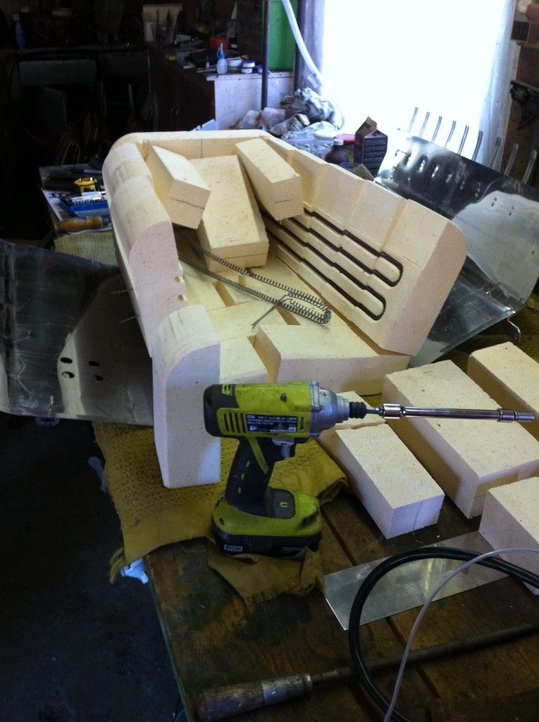

I decided today to throw caution to the wind and modify my Evenheat oven by rerouting the heating elements so that there are no elements in the back to try to even out the heat throughout the length of the oven.
I figured it would be easier in the long run to actually disassemble the entire thing and here it is once I removed the cover. At this point I was thinking this may be a bit of a nightmare fitting together again and I wasn’t completely wrong.:grumpy:

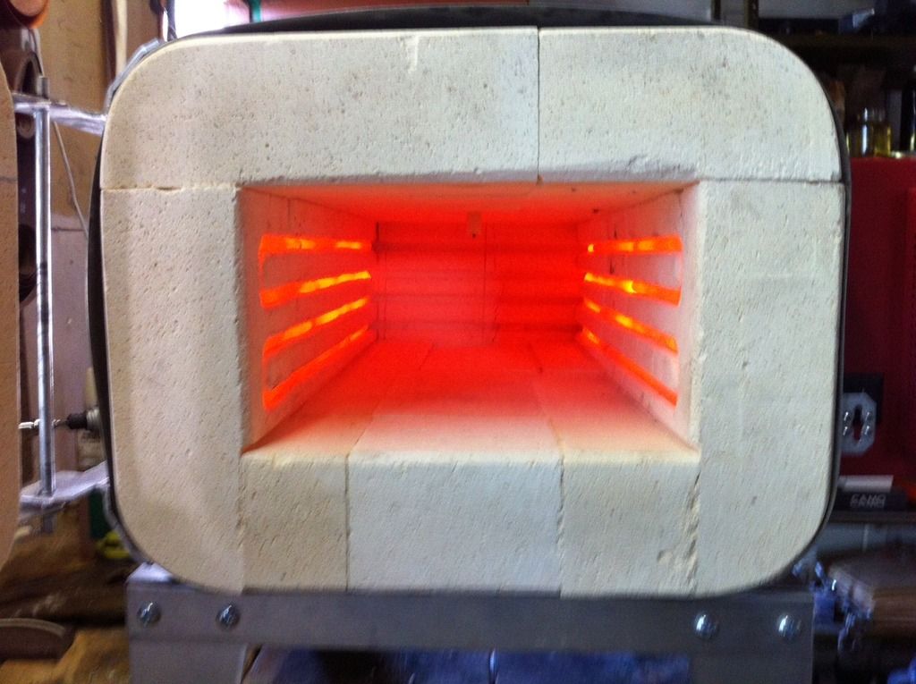

But I did manage to get it reassembled and up and running. Here is a picture when I first got it fired up with elements on the side and none in the back. It was a very gratifying moment considering there wasn’t a giant spark and the lights didn’t go out.:)

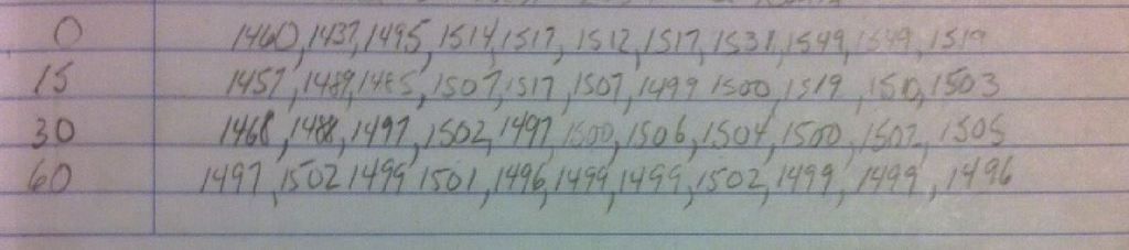

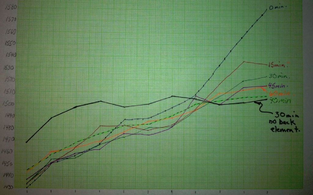

I was very curious what the heating line would look like on my graph after I modified it compared to the other ones I did previously before modification so I did the same heat variation test that I did before it was modified. See if you can figure out which is the latest line?
There are the numbers in case anyone cares.
Obviously it’s much better and after the first 4 inches the oven varies less than 10°F throughout its whole length. And I think I can improve the first 4 inches because the door latch didn’t line up properly after reassembly and the door needs to be fitted to close properly so I think it will be even better once I get it properly assembled. I’m really happy this worked out because now I can make a nice consistently hard blade.
Actually I just had a closer look at my numbers at 60 minutes and the whole oven is within less than ten degrees variance. I put up the 30 minute results because I didn't want to waste energy and heat longer than I have to so that is what I planned on using so that is what I plotted on the graph.
I really find it remarkable that Evenheat sells an oven with such an easily fixable but serious design flaw. I have dealt with them and their customer service is very helpful so I think I may recommend they change their design but I doubt they will listen.
