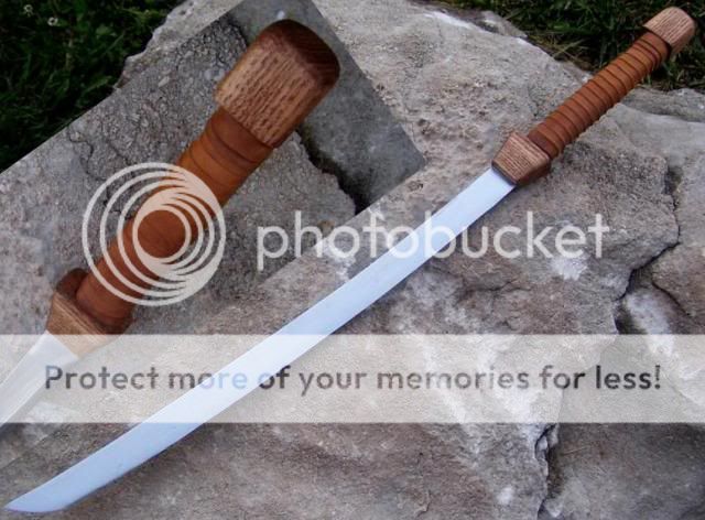

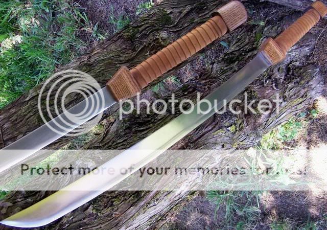

Saw Blade Steel was cut out and Normalized @ 1500 degrees until non magnetic, three times, to remove stresses and align crystals. Heat Hardened until blade became nonmagnetic, then quenched in 125 degree quality oil. Tempered the blade to a straw hardness @ 425 degrees for 1 hour, letting it air cool and repeating once more. Sword was file tested and is shown to be very hard.
Measurements:
Total Length = 36 “
Blade Length = 24 “
Blade Width = 1 ½ “
Blade Thickness = 3/16 “
Handle Length = 12”
Handle Width = 1 ½”
Handle: Oak
Weight = 1 lb 2 oz

Can you explain the handle construction?
Is the blade flat ground?
Cool! Like the videos also. :thumbup:
Thanks.
As far as the handle. The guard, I split in two. Routered it out a bit, and sandwiched it around the tang with two hidden pins. From the handle back to the butt is one entire piece of oak. I cut it and shaped it to the handle I wanted, and then sliced straight down the handle itself, the thickness of the tang. I drilled several holes in the tang and the wood of the handle. Then slide it over the tang and applied a ton of gorilla glue. Then wrapped a lot of tape around it so the gorilla glue wouldn't expand out, so it would stay inside going into all the holes. When it dried I took the tape off, sanded it down and tightly wrapped leather around it. It aint going anywhere. Very sturdy.
As far as the grind, yes it is, kind of. I flat ground it, but then also have about 3/4 inch grind at the edge. So its kind of a two part grind. :D Hope that answers your questions. Didn't know how to explain it shorter.
