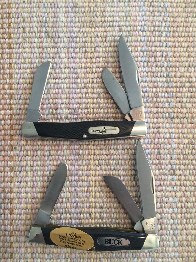

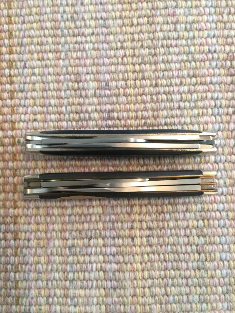

Bert, I don't know the answer to what your asking but, I'm asking...I have two 301s, a 1987 and a 1995. The liners are different material, the 1987's are brass the 1995's are nickle sliver. Also the blade orientation is different on them. Will you comment on that? I didn't find answers in the searches I did. Thanks, Preston
Preston, look closely at your 2 knives... the 1987 has 2 springs and the 1995 has 3. The liners changed from brass about 1990. The secondary blades are crinked (bent at the tang to bypass) and share opposite ends of the same spring on the 1987. The 1995 has 1 spring for each blade. /Roger
Thanks, Roger, yes the '87 has 2 springs, the '95 three. I see you edited your post about the nickle silver liners, I hope the photos show that they are NS, due to the dings and nicks in the liner and not the springs. Preston
This first photo shows the two, '95 on top...
Next is the liners and springs...
Then the blade configurations, I see what you meant by 'crinked'...
