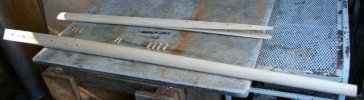

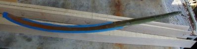

To make a take down unit, try this :
Cut the pole stock 2 feet longer than desired and a rectangle cross-section. Say 2"X1.5"X7' to make a 5.5 foot long 1.5X1" oval pole. Cut it into two piece, 3' and 4'. Take the short piece and make the tsuka from it. Split the wood, inlet the nakago,cut the tapers for the others pole's seat. Set it on the other piece (aligning the grain, and making sure the whole thing is straight) and mark the wedge. Carefully cut the wedge out ,staying just off the line. File/sand to as perfect fit as you can get. Put the two together and tape up the joint, making sure all is straight. Drill three or four 1/4" holes along the spline. Tap in snug fitting doweling and cut off.Put a drop of super glue on the ends. This should hold everything in place enough to shape the pole with planes/routers/files/sanders,etc. Once all is shaped,drill out the dowels,re-drilling the holes for tapered pegs.Tap in nthe mekugi (tapered pegs) cut flush, and sand. Finish the pole with the desired finish/varnish/lacquer. Drill an 1/8" hole through the pole 6" above the "V" and 6" below the wedge on each pole. Re-drill that hole to 1/4" about 2/3 the way through.Stick the end of a piece of paracord ( multi-colored paracord does great here) or other binding in the hole and tap in a short mekugi peg to lock it in the hole. Wrap as desired to cover the spline and bind the joint tightly. When you get to the other hole, put the end in the other hole and secure with a mekugi.To disassemble, tap out all the mekugi. This will make a quite strong pole.
Stacy
Here are some photos of the pole in progress. You can see, and understand, the assembly procedure better in the pictures than the explanation above.
The top half piece of wood is split, the nakago is inletted,the tapers are cut and sanded,then the piece is glued to reassemble. The other piece is cut to fit the "V".
I'll post more photos as the rest of the pole develops.

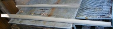

OK, got the pole just about done. Started with a 7'X2"X1.5" board. Doing what I posted, I made a take down pole that is as rigid as a solid pole. The pole arm disassembles into :nibu tsuka, Muromachi naginata zukuri ,juuichi mekugi, koshirae (habaki,fuchi sepa, tsuba), san-dan-maki, semegane, to yari-ishizuki.
These pole photos are the last you will see until ashokan. Don't want to give it all away.
