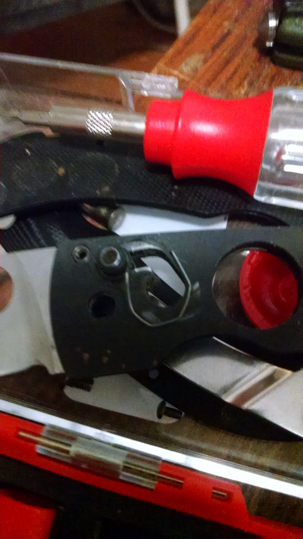

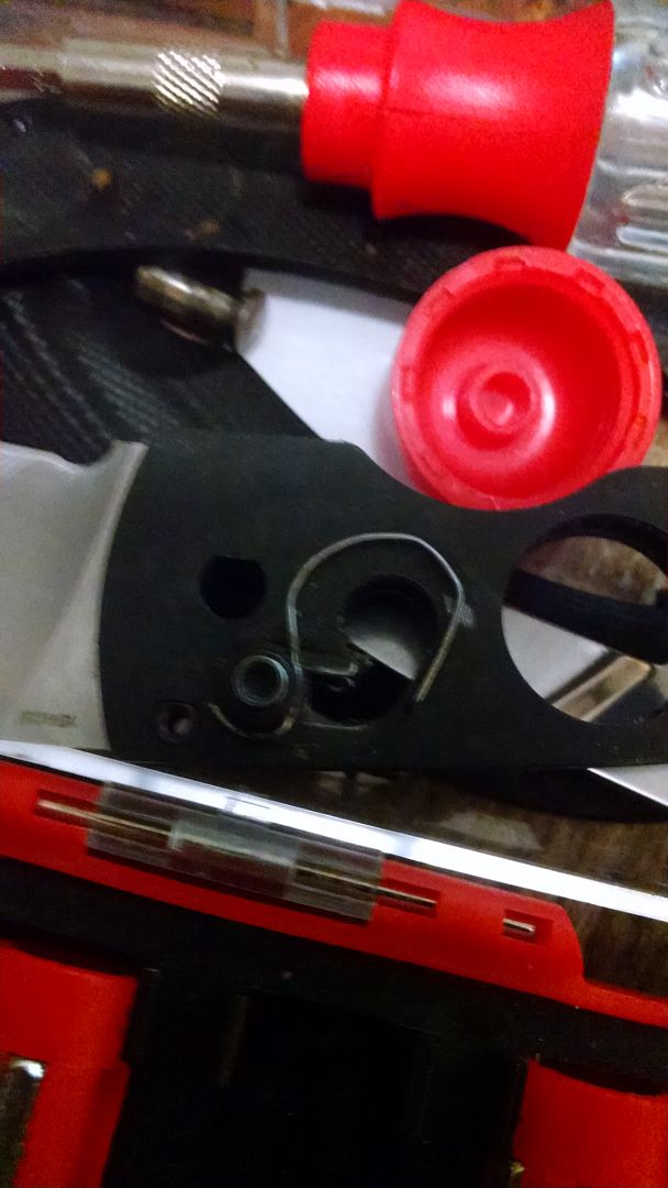

I made the springs sometime in early January of 2014 and have been playing with and opening it several dozen times a day for about a year as it is so smooth.
I can't remember the exact music wire I used, but I had to go to an actual music store with my dad to get the wire, and I think it was 0.7 mm in diameter.
As you said I did use needle nose pliers and it actually wasn't too hard to do; looked up pictures on how the omega spring looked like and copied it basically.
The pull on the bar feels almost exactly the same as a genuine AXIS lock except at first it was really stiff; eventually it did become smooth somehow.
That picture was taken recently after I found it in the house about a month ago after another year of laying in a drawer, so that is why it looks so dirty.
As for why it was laying in a drawer for a year, I had been diagnosed with a mental illness and my parents wouldn't let me near any knives until my condition stabilized, and thus the knife hobby went away for that length of time.
Recently I've gotten a lot better.
So to summarize:
> Wasn't too hard to do with only music wire and pliers
> Opened and closed at least 1000 times
> The springs did not break after staying in the same position closed for a year
