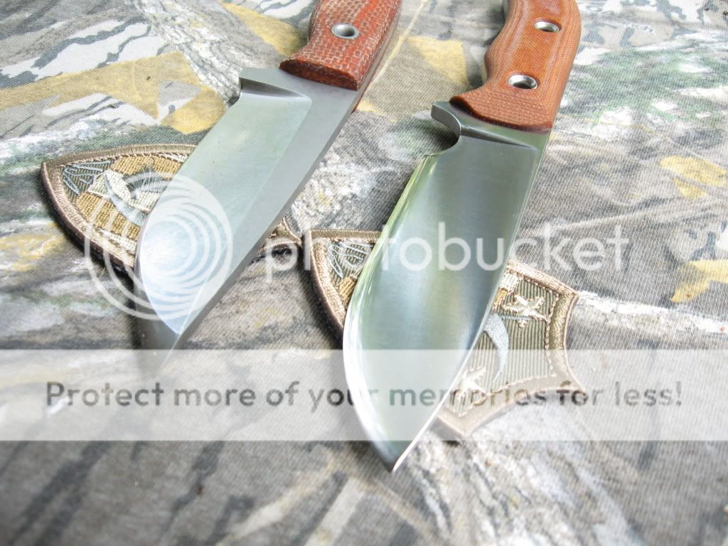

Same. But with a 8" or a 10" wheel. I was limited on that grind on thin stock. Like on that knife of chickenpluckers. You run out of radius before
you reach. .015 edge on bottom. So it had to be a low saber. Which is fine. But this is what I needed to take it to this level and his thin blade is
3/16. Not. 1/8 like this example.
This blade. Is 3/16 thick with a 8" wheel. The one pictured above is 1/8 thick with the 14"

For comparison purposes, 8" wheel nice deep dish on the Horton Archback. 36" wheel (damn near flat grind yet still hollow) on the BanTang BT4.
I have not heard of a wheel (that uses a belt) larger than 20", is Ban's 36" a stone wheel?
Not sure how he accomplished it Tim. But that was the diameter he discussed when he was making that one.
Edited to add. Tim I went back and searched the sales thread. It wasnt a 36"wheel but a curved platen that replicated a 36"wheel.

Yep it would be a really big wheel and take up lots of space. I used a curved platen with a radius similar to 36".
