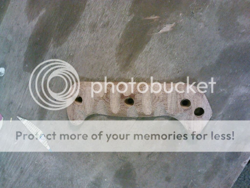

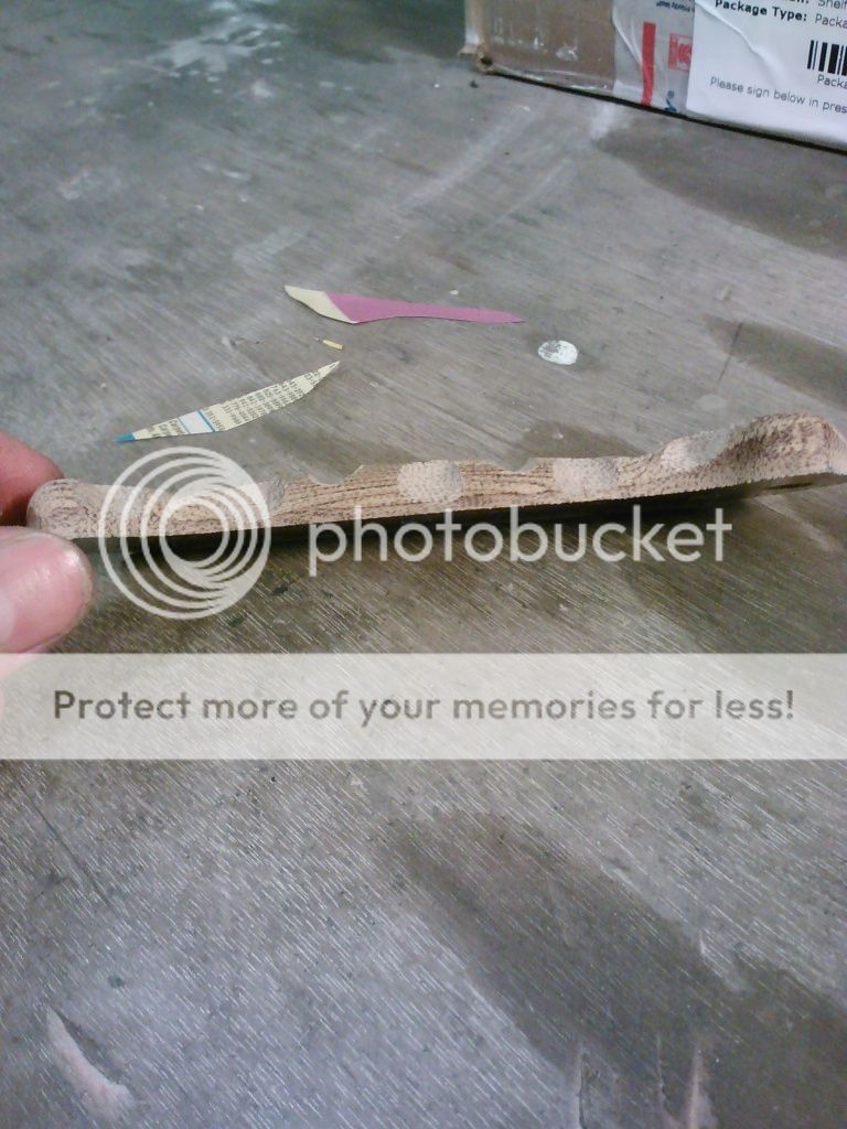

Spoke to Albert once again today, scales are halfway done. He is a busy man, so I appreciate him taking on my project as I have no time. Some of you have asked, "why have a pure fighting knife created?",,, simple, because when I travel overseas for some of my work that is exactly what I need it for...
here's some pics of the scales as one is almost done so far...

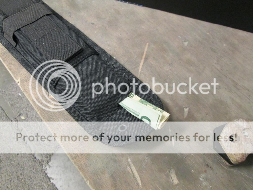

Hopefully full product unveiling will be in a couple weeks...and the blade will be carried in a Spec Ops Master Combat Sheath...

All done! I am pretty happy with the end product to be honest. Even with the blade modification the knife feels quite lively in the hand and not out of balance. I would like to thank havoc1969 for being so patient and giving me such a cool project. You the man! Alright, on to the pictures!
And this is why you don't insert a tanto-fied, sharpened BK5 into it's sheath without handle scales to keep it from sliding around... :apologetic:
