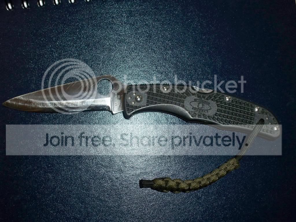

None. I am not fond of them. So much so that I removed the spydie edge from my Endura 4 and convexed it.
