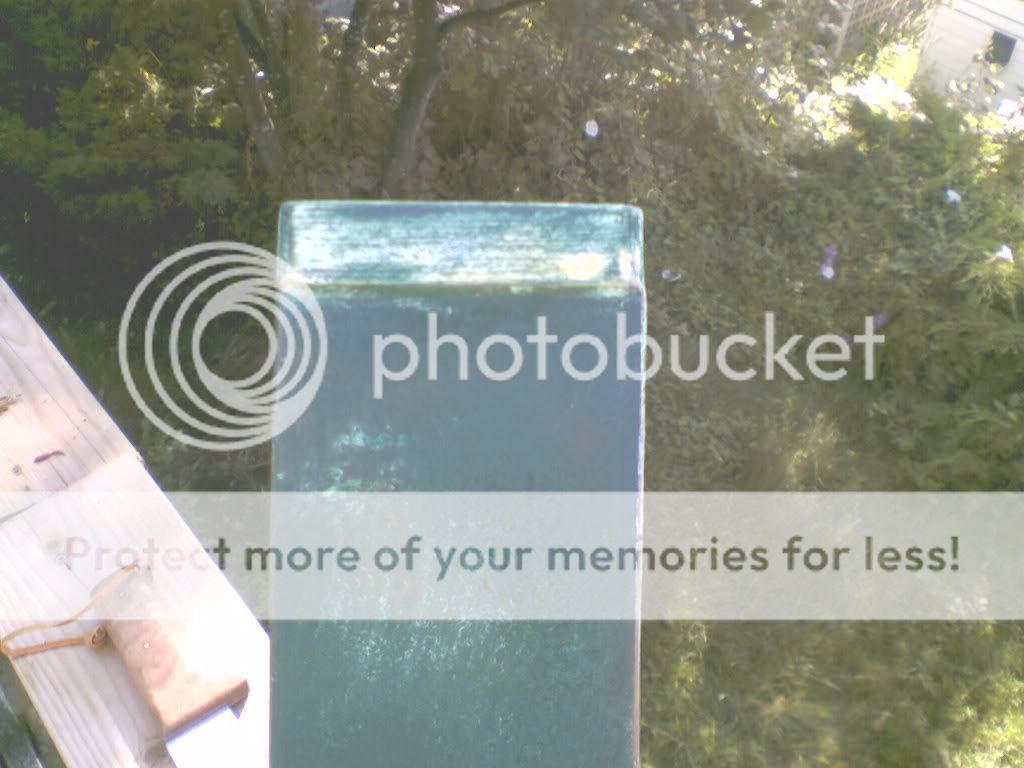

These are the sheaths I'm doing now - 1/8" mahogany ply with yellow cedar for the mouth and for the welt. The whole mess has a layer of 6oz glass and epoxy over top and weighs less than the tram itself. The best part...it's not one of the soft pouches they're shipped with ! The baldric terminates in a double fisherman's knot so I can 'open' it to slip the sheath in and tighten it down. The wider yellow cedar mouth stops it from dropping all the way through. While I'm hiking, it rides in the sidestraps of my pack tucked into a 'bottle pocket'. The baldric comes out when I stop for the night and drop the pack. The sheaths are amidextrous because...well...see my username, nuff said :D!

I want to try a bolo so I'll probably do a sheath like the (green) plywood one with a slit and a couple leather straps like that Condor one. How do you like it so far ? I'm not a fan of the crappy pouches they come with, I wrapped mine with gun tape (OD duct tape, 100MPH tape) but after an unplanned slide partway down a bank the mach cut right through it. Again, cedar bark to the rescue - not pretty but it worked. Been sold on hard sheaths for these things ever since.
