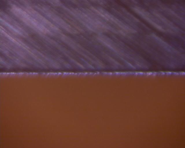

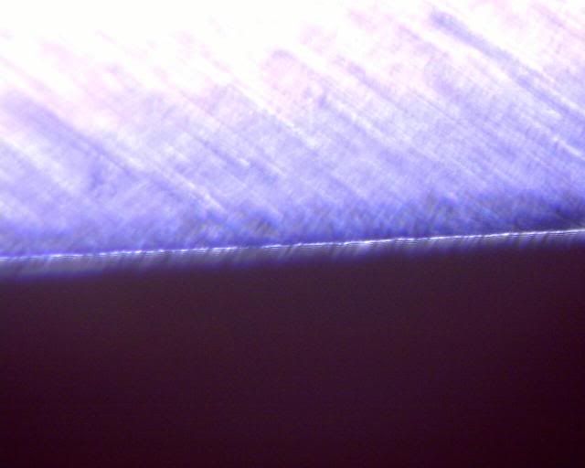

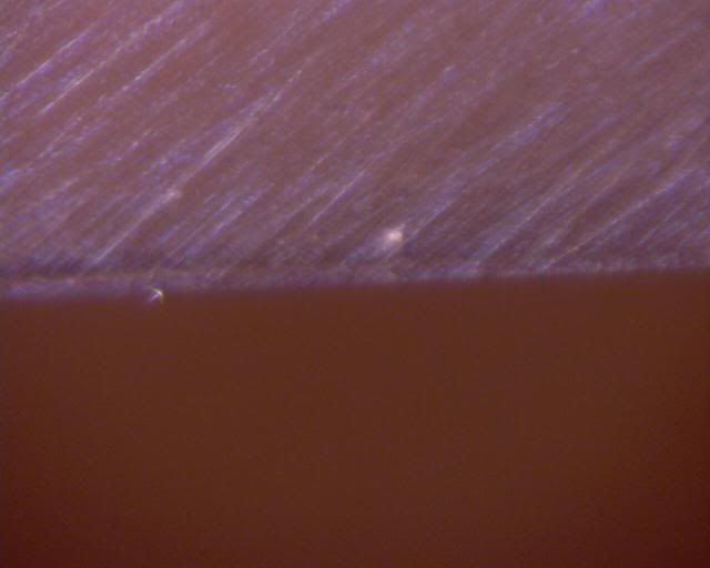

The burr
Got some decent shots of burr creation from added pressure while using a DMT EEF 3 micron diamond hone. All pix at 400x
Burr free before
Pressure added (the weight of the blade plus the weight of my hand)
When a knife is reprofiled or a dull knife resharpened, I've always needed a burr to tell me when and which parts of the blade still require sharpening. I don't see how you can fully sharpen the entire blade without the advice of a burr.
Typically, on a dull blade, the tip or the middle part of the blade -- the part most used for cutting -- is much duller than the rest. I don't see how you sharpen the dull portion without raising a burr on the rest of the blade, unless you sharpen only the dull portion, which will lead to non-even wear.
And on reprofiling a blade, you'd need almost flawless technique to get the entire edge sharp at the same time.
So I always try to raise a burr, except on an already sharp knife that I'm simply tuning up, which is most of the time. The burr is not difficult to remove, and it tells a story.
