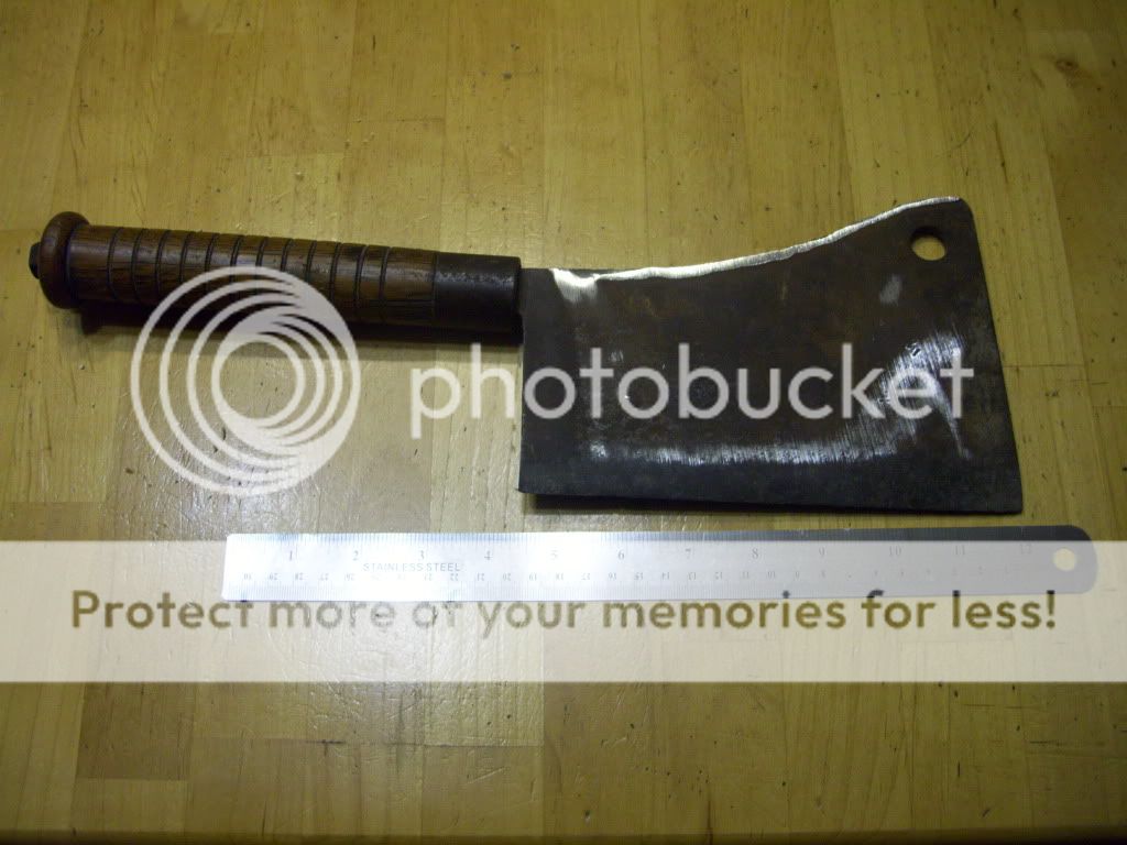

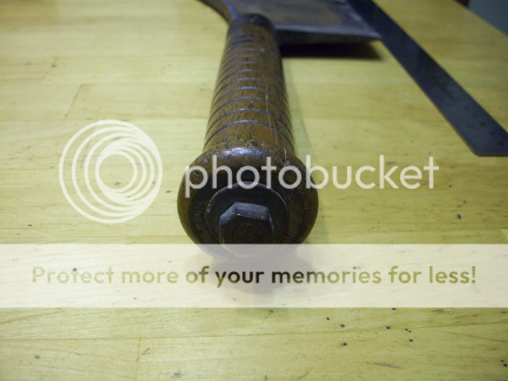

I would like to get one started. I love cleavers, old & new. I don't have anything special yet. I have an Old Hickory kitchen cleaver. But today, i was given an awesome cleaver by a friend, who had a friend give it to him. I know nothing about it. I would like to clean it up and have already started to do so. It has been pounded on severely with a hammer & the spine was mushroomed out 1/4" on each side. This cleaver will not be resold. I will keep it & use it. The handle is a little loose. I think it can be removed &/or tightened but not sure. Any help would be great. Thanks.
The ruler is 12" for scale. Thickness is 1/2" wide at the handle & tapers to 1/4" at the foremost end of blade.

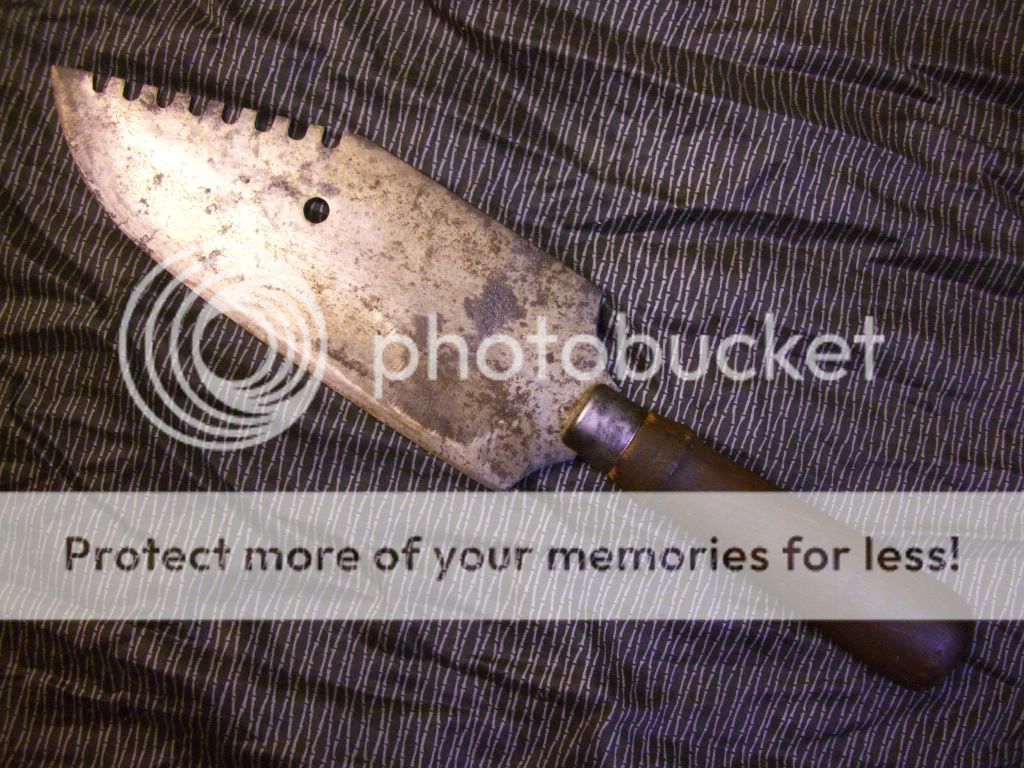

Removed hammer mushrooming, eh? :D I love cleavers but need to get my hands on more. The only one I have at the moment is this oddball one from an unknown maker. The "crenelated spine" is for use as a meat tenderizer. I'm culling some chickens today so it'll be getting a workout! :D

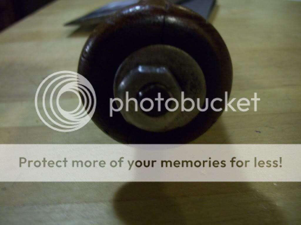

I need some advise on these kind of handles please. This one is cracked in many places. Can it be saved & how. I cleaned it up, removed handle, cleaned off all the rust & gunk & reinstalled it. Put an edge on it. It will slice paper easily now. Did not disturb the makers mark i found. I can see a hammond line as well.
If you can open up the cracks enough to get some glue in them then they might be saved. Sometimes I'll even split a piece of wood open just to glue it better. Another option for smaller cracks is to mix some good wood glue with a little water to thin it and then inject the glue into the crack with a large hypodermic needle. Whatever you glue up needs to be clamped while it dries. Round objects can be 'clamped' with duct tape or bailing wire. I'm fond of Tite-Bond III but any good wood glue should work.

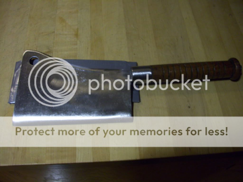

I KNEW someone would post that. Awesome. Seen it in another thread. Here is mine almost done. I wanted it this way. Did not want it all rusty & nasty. Some won't like it now, but i do.
Wicked sharp now.
