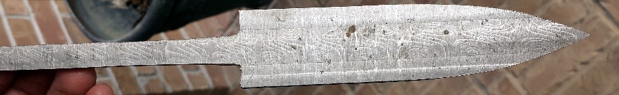

The dagger I've started
Feb 5, 2010
3,911
In my other thread I mentioned that I was going to start working on a dagger blank I made two years ago. I wanted to post a pic here to see if anyone happens to remember selling me the billet and can tell me what metals were used (so I can get it properly heat treated). Worse to worse, I'll just say it was 1095 and 15N20... but something tells me that ain't right.
Did you buy it from HHH by chance?
http://www.bladeforums.com/forums/s...hen-knife-in-damascus?p=13046440#post13046440
Found this old thread on a kitchen knife you made. The mix you cited there was 1080/15n20.
Too late now, but the first error was grinding a side steel billet to a point. You should have done a butterfly weld ( or had someone do it for you). That would have made the edge steel follow all the way around the tip evenly.
Any carbon steel mix should harden with a basic HT.
I think that's the one, Andrew. Now that you mention it, I believe this was an HHH billet.
As for the first mistake, I see what you're saying... but I have no means to do that, so I'll do what I always do... the best I can with what I've got. I'm still excited to see it finished. And I'm certain the first mistake won't be the last. Hey, I'm two years out of practice. ;)

Your dagger there would have looked cool with a bird's beak weld at the tip, but having a hardenable twist core coming out at the tip in a symmetrical fashion like that might b pretty cool too, especially since the twist is so bold.
Perhaps you will find a way to compliment that pattern flow out the point, with fittings and handle choice?

I'm positive that bar was made by Rob Calcinore. It is mosaic Damascus. I don't tyhink Rany Haas is doing any mosaic yet and as well I believe I had some of that exact pattern from Calcinore. It will take a carbon steel hardening.
Frank
Thanks, Frank. I'll definitely get Peters to do it the standard carbon steel way.

It isn't too late to do a butterfly weld on the tip. I bet Stan would be glad to do it for you. It would shorten the blade a tad, but the result will be far better looking.
I'll keep that in mind if I ever use another billet like this one. Since I've already ground this one, I'm going to finish it as is.
