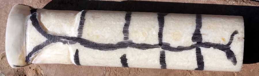

I started seriously working on the handle this week. I decided I wanted to carry the climbing vine theme from the guard through the handle. At the same time I wanted to create finger grooves that make the handle fit naturally in the hand, whether being held in the left hand or the right. So I am carving it now with a vine design going up both sides, with the spreading vines being used to define the finger slots. Needless to say this will take a while.
The bulk removal between the "vines" was done with the Dremel. The final shaping is being done by "whittling" with needle files.

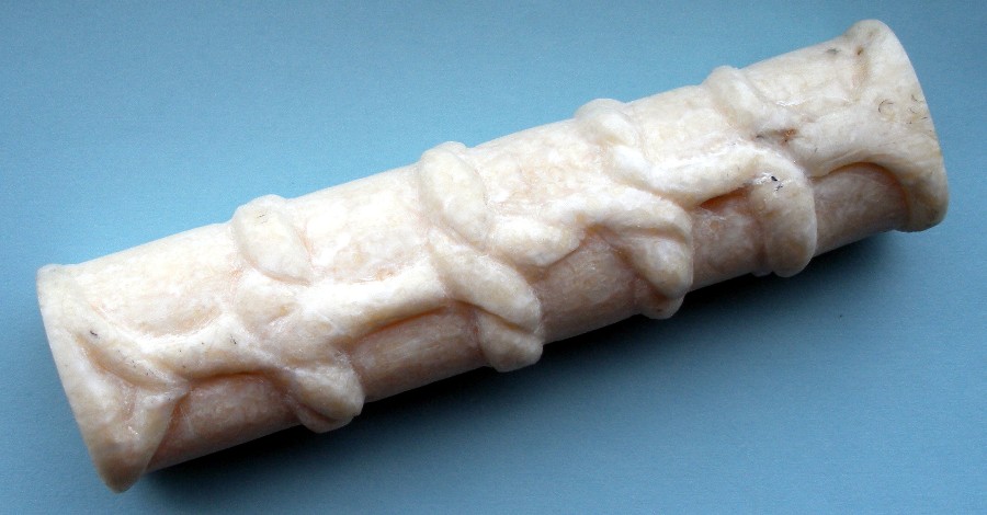

Today I spent a few hours roughing out the "vines" in the handle. I'll keep at it a bit longer, but now my thoughts are turning to staining the ivory. Thought I'd try coffee first. I want something that will leave a light brown hue behind.
Walrus "tapioca" will not dye well because it is so dense. You can experiment to see with wood dyes, but it won't penetrate far. It may take a long time to get it to change color.
I have dyed mammoth with alcohol based wood dye.
Thanks, Stacy. I don't really need deep penetration, but it would certainly be nice if the stain didn't just rub off the first time the handle is gripped.
As a test, I dunked a small piece of ivory into a cup of black currant iced tea for about 15 minutes. Not too surprisingly, the tea did stain the ivory. What did surprise me was how durable that stain was. Took a bit of sanding to reset the piece for future tests, and that revealed to me how well the technique might work on the handle. If all else fails, I'll use tea staining.

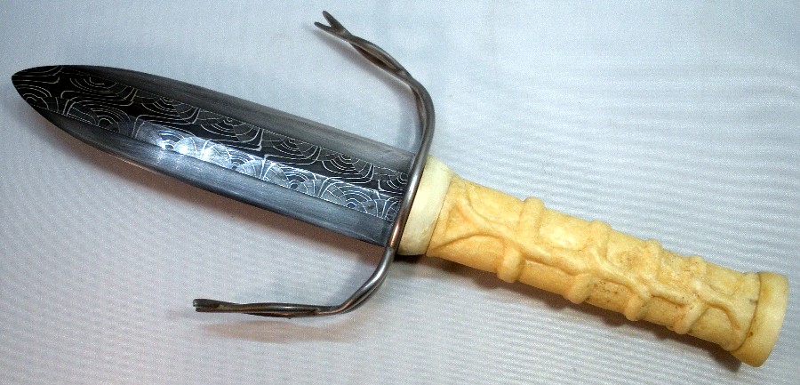

Getting close to final assembly. I have finished tea staining the ivory, and I'm satisfied with the color. Just a few more details to address before I put it all together.
That thing is crazy!
I really like the ivory, I've used coffee to "age" plastic and bone before but never tea, it looks great!
