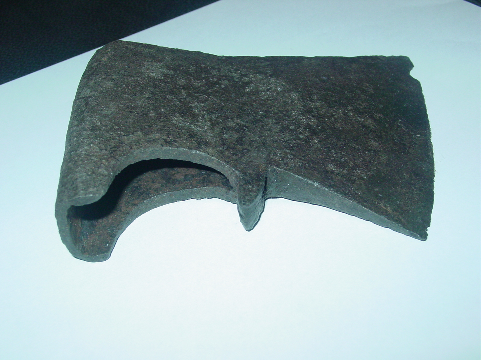

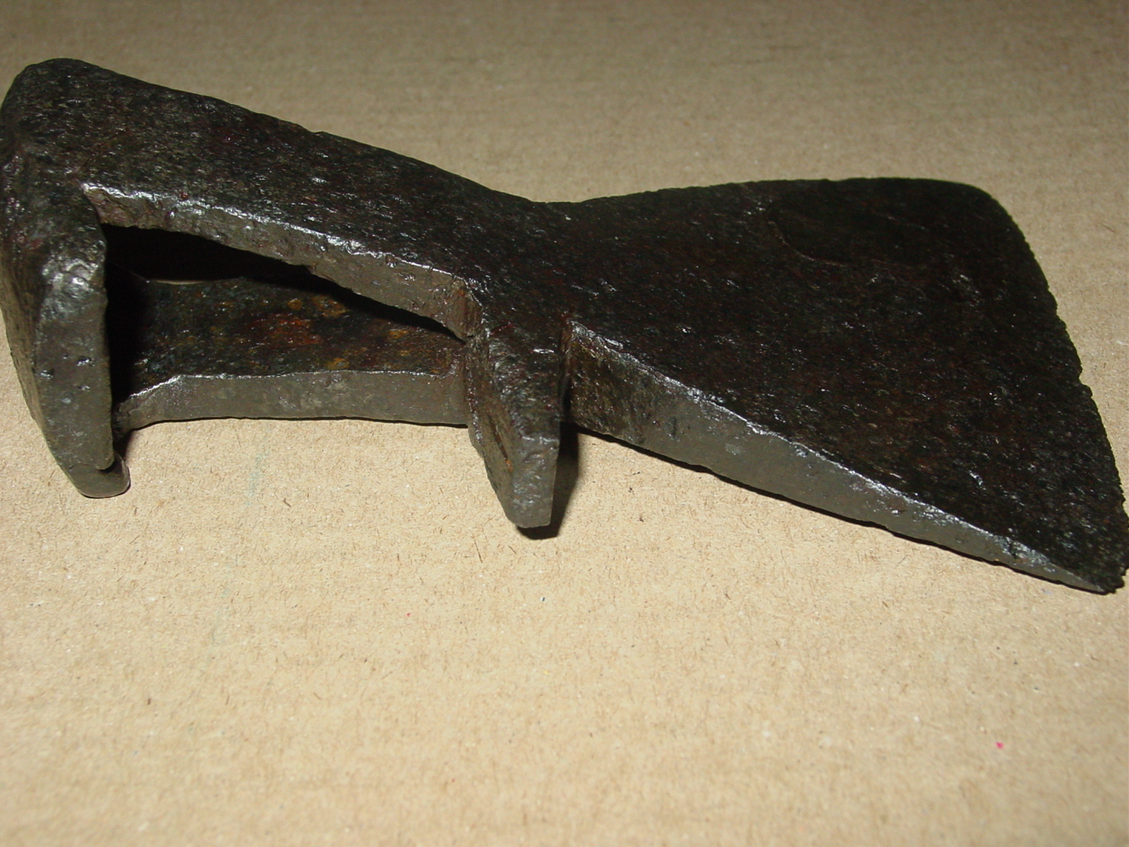

Seems like another thing that was largely left behind in the Old World were the langettes,either integral,or the add-on kind,like on some very old boarding,or more recent fire-fighting axes(halberd-style,those sometimes had them all four sides of a square haft).
So,would modifications like this be in any way appropriate,or would it screw up the purity of a given type?Say if a guy inserted a long strap inside against the poll,the top bent to hook over the poll,and the bottom running down the handle pinned by a small screw...(Or no,wait,it'd have to be the front,for lifting the handle up...)
You'll see many antique European axes with extensions on the bottom of the poll. I don't think it was done to resist the impact - that will hit on the front of the eye. But extending the bottom of the poll with help with exactly what we've talked about here - loosening the head by leveraging it out of the wood when its stuck.
Square_peg, you are right, there are many European axes like that and likely the design meant to function the way you have suggested.
But there are other examples, with the extension in the from, under the bit. Some of those survived until today in Bulgaria:

There are similar historical examples from other parts of Europe, from earlier times too.
I suppose in those cases these extensions functioned as Jake has suggested, to stabilize the head on the handle during impact.
