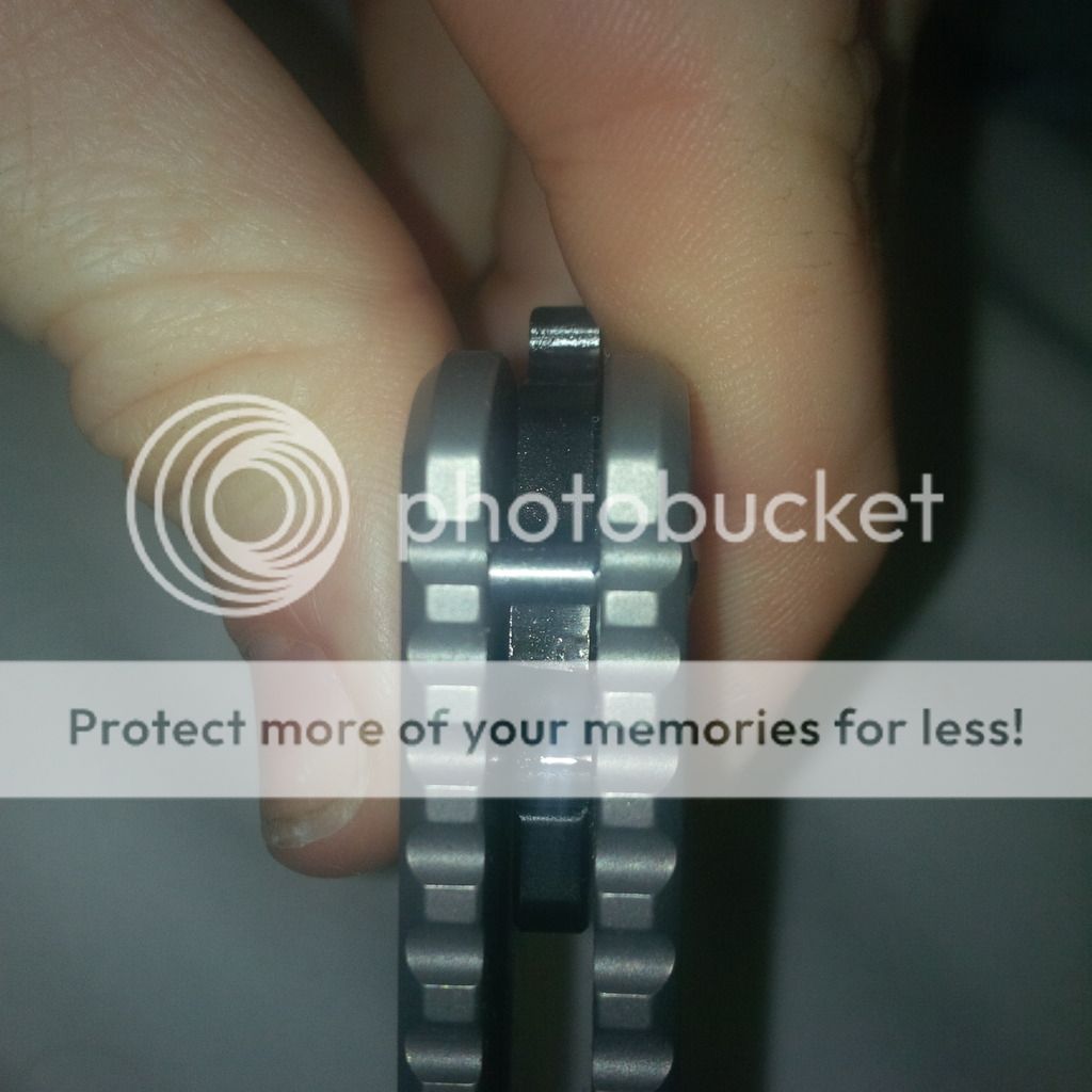

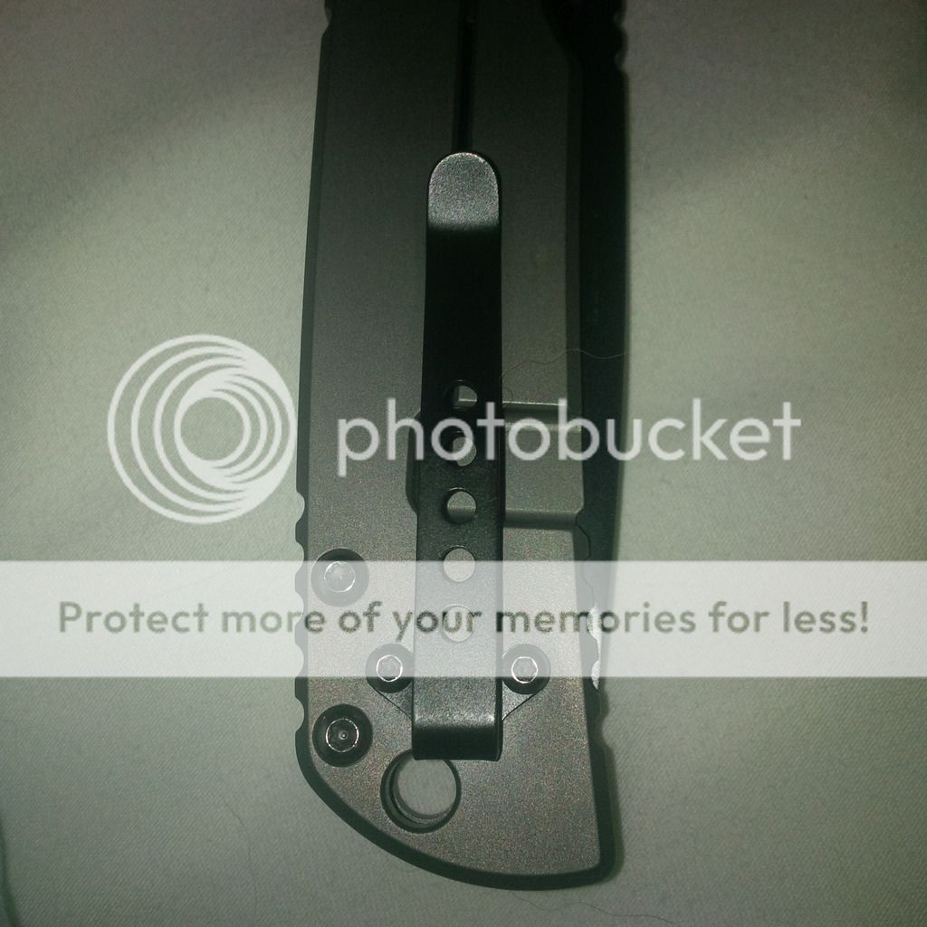

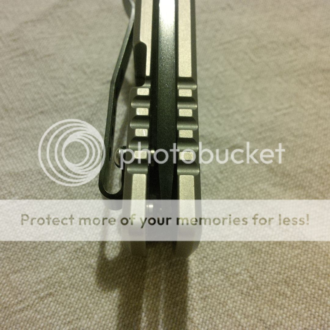

A - Is it possible to lose the decorated pivot? Doesn't fit with the rest of the knife and looks kinda cheap imo. If I could get a plain one from Kizer I would be ordering it right now.
B - the clip needs a little final bend at the tip. Current tip of the clip digs into my hand a bit. I also think the clip would look better without the holes drilled into it (the clip in the product images looked better - no holes and a bit wider in the centre), but, that's just personal opinion. Additionally, it doesn't seem to have great retention.
C - only an observation, but the stop pin is quite thin compared to some of my other similar knives. Hasn't been an issue thus far.

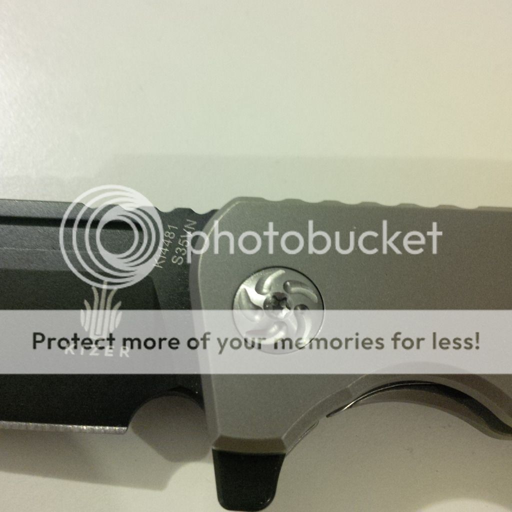

OK, I disassembled my Escort to see if I could duplicate the spinning pivot issue.
First, the pivot is not a "D" pivot. When you take the pivot screw off, you see what looks like a "D" pivot, but it doesn't run the entire length of the pivot. It is only a notch that extends only about 1/8".
I was able to duplicate the spinning pivot. I removed the pivot screw and then reinstalled. I tightened as far as could and then the entire pivot assembly would spin and the blade developed lateral play. I have seen this happen with other folders and what seems to happen is the thread locking compound loosens just enough to let the pivot screw back out just a bit. Because the compound has filled all of the threads the entire length of the pivot it prevents the pivot screw from easily being tightened. The compound needs to be cleaned out or loosened to permit the pivot screw to be tightened correctly. As counter intuitive as this sounds, I have found this is a bigger issue with pivots that have tighter tolerances.
I would return it to Kizer for repair.
Sorry Dirk but the pivot is a D-shape pivot... For that the D shape does not have to extend over the full length of the pivot! The little notch at the end is the D shape part that fits in to the D shaped hole in the FRONT scale! This combination prevents the rotation of the counterpart of the pivot screw when tightening or loosening the pivot screw. I know there are knives that have the D shape over the entire length of the pivot and they rest in a D shape hole in the BACK scale. But this solution is actually better (no need to weaken the entire pivot and better support of the blade).
I had several customers with this "problem" when they tried to open their knives and did not support the counterpart of the pivot (by laying it on a rubber mat or similar). After a few twists of the pivot screw and because you put some pressure on the screw, you are pushing back the counterpart until it does no longer rests in the D shape. From that point on the counterpart starts to rotate. Especially when there is locktite on the screw.
I am 99.99% sure that what happened in this case is that because of the fall the D shape notch slipt out of the D shape hole (on the Escort it does not rest very far into the scale! It should be a little longer to provide a better hold). The fix: laying the knife flat on its back on a rubber mat or table and pushing down on the front scale and then start turning the torx screw slowly. When the D shape notch is in the right position to the d shape hole in the front scale it wil snap in again. And then it will be possible to tighten the screw a little further.
Trust me, been there done that many times...
