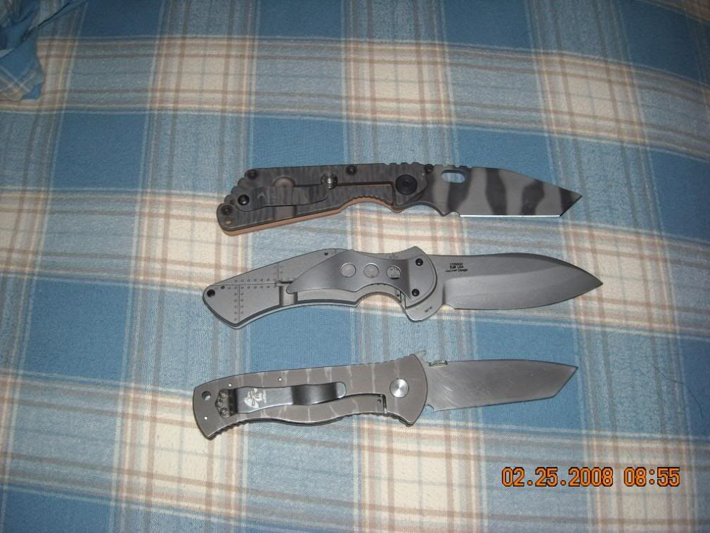

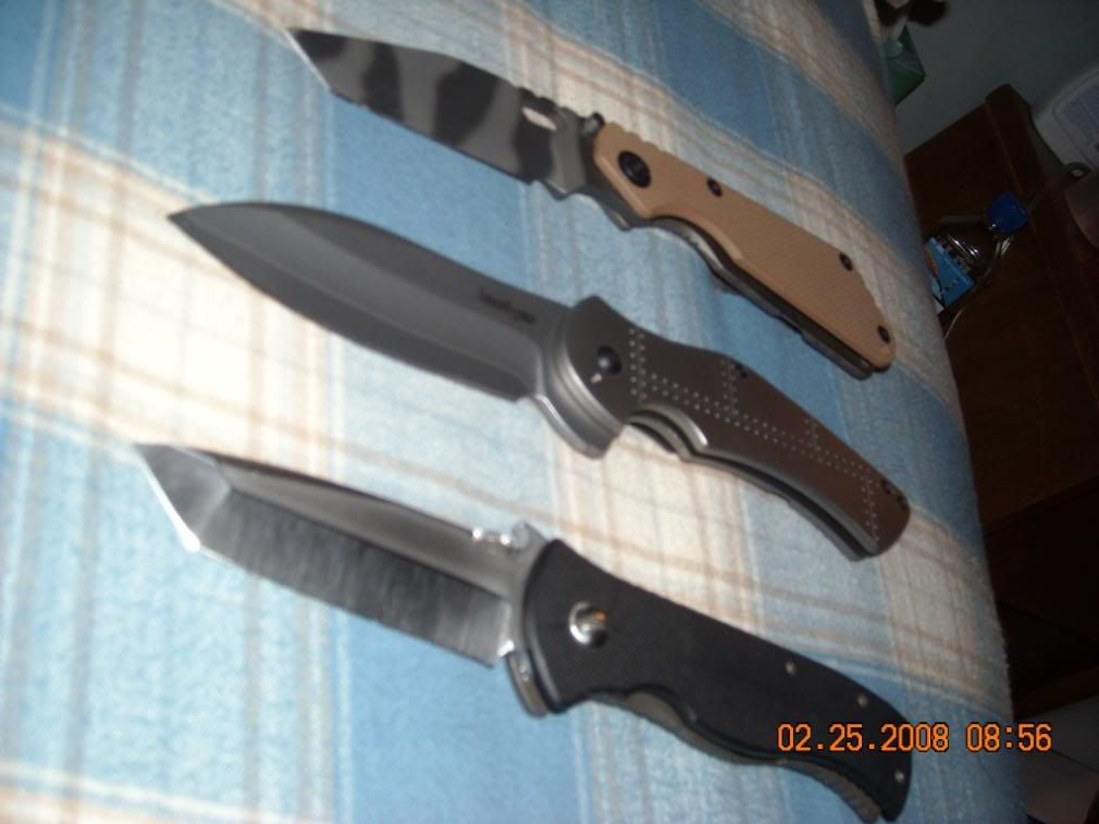

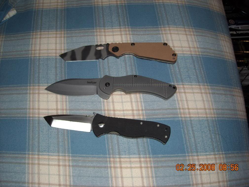

here are some pics of my hd-7 that tom did, hope you dont mind the strider.:eek:
Enjoy :D:D
